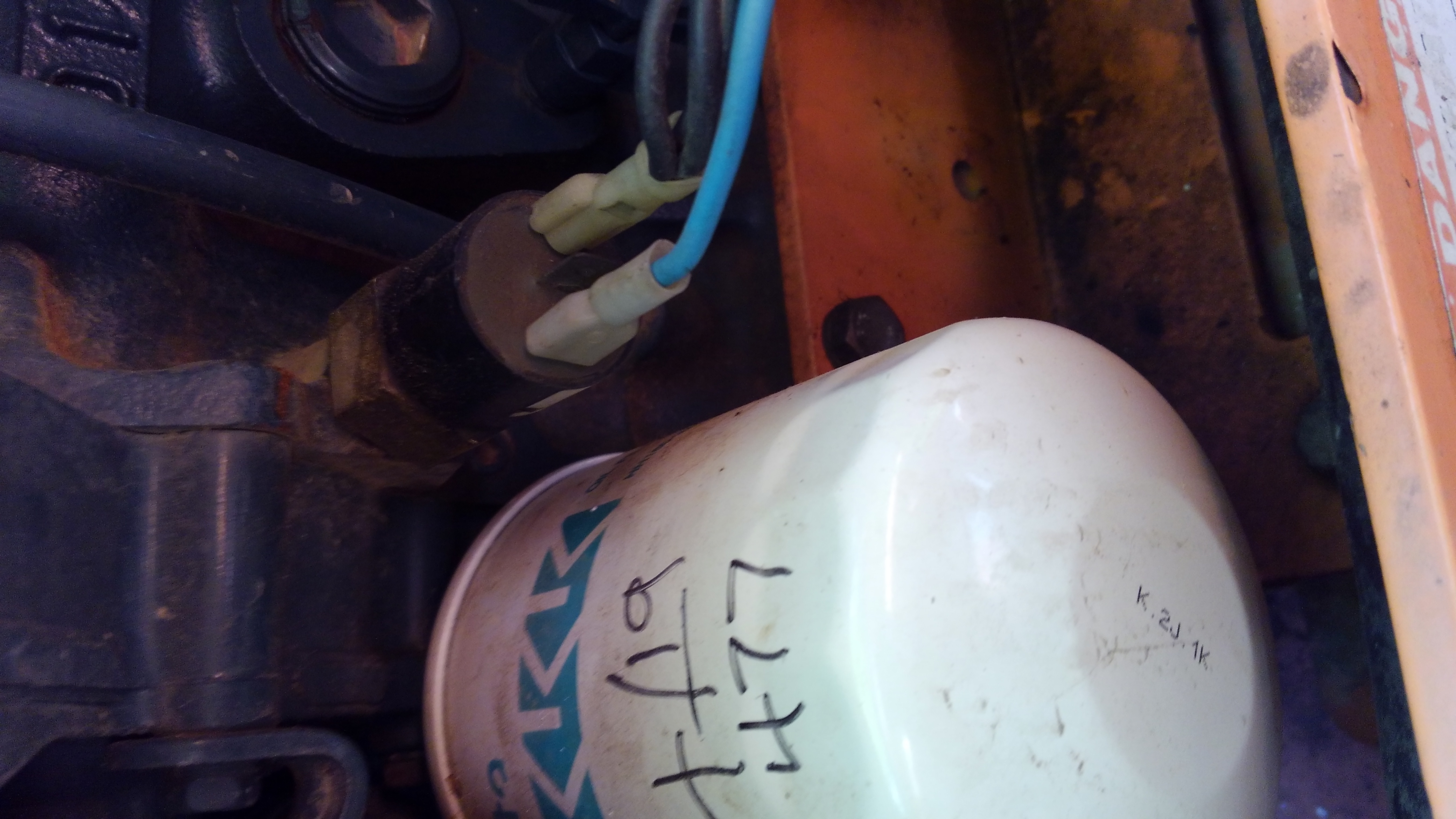

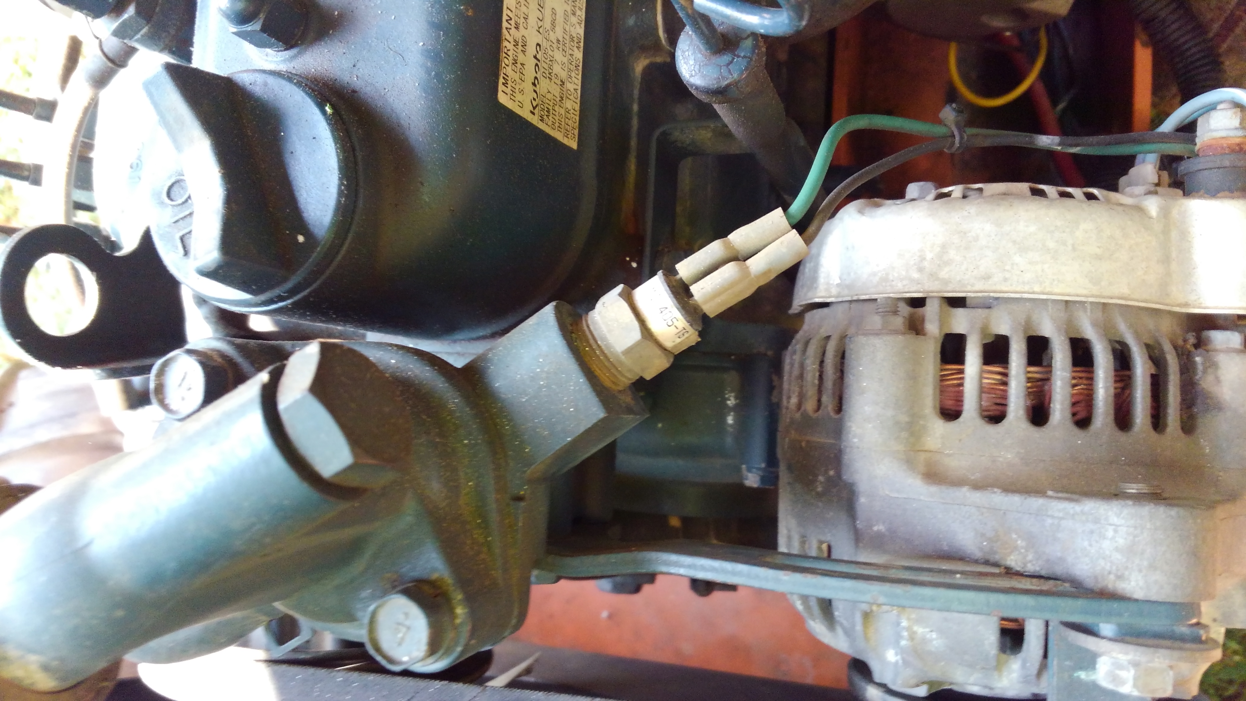

I searched for the parts in the Allmand 425 parts catalog I found online and in the 2 manuals I found for the 425 but see no mention of any sensors attached to the engine. I went to the local Kubota dealer since it is a Kubota engine, they said they didn't know anything about the engine or sensors. Apparently Kubota only made that engine just for Allmand and no longer supports it.
So, anyone know where I can get new parts. Here are pictures of the sensors I want to replace:

I have a really good dealer (Deboers) and the guys will try and help, BUT it really helps to do as much of the legwork as possible. Like, I would find out, what equipment of theirs has the engine for the parts I want. You want a coolant temperature switch, not sender, I am guessing.

Those look like the oil pressure sending unit and the coolant temp sending unit. What industrial toys said is the correct thing to do imo.

According to the manual, these are supposed to be sending units like mini14 mentioned above. I can't figure out the part details to order another one. I plan to take some pictures and check with my local auto parts store. I'm also looking for the pump replacement as suggested by others.
