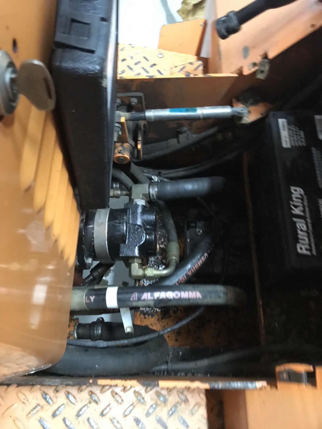

I would think that the way it is setup in your situation is so the machine uses those two lines coming from the gear pump as both to/from depending on which way you are steering. Leaving the tank line to only let a little bit of fluid release when a shock is given to the system, as in steering left and all of a sudden wheel hits a rock giving the steering a jerk. Similar to how the drive motor would be. I have nothing to back up this line of thinking though other than common sense so I could be way off.
My other thought would be one in line and one out line, and the remaining line being for the load sense. It may just give feedback to the pump so it can decifer the demand needed from the pump. I don’t believe my allmand has the load sense.

I replaced the pump after a rebuild kit only got me another 200 psi which didn't help.
I have a valve for the steering circuit from the pump
