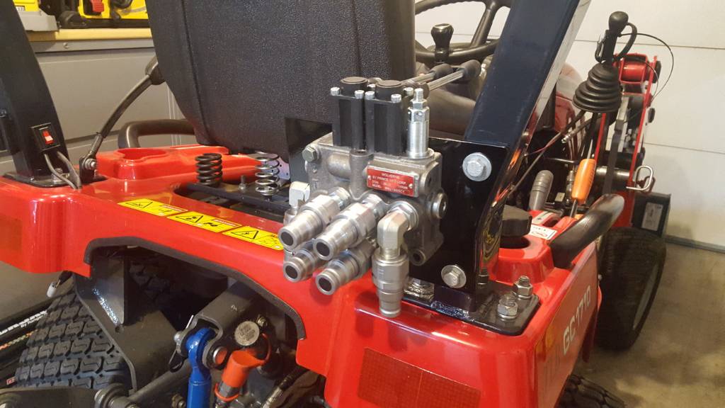

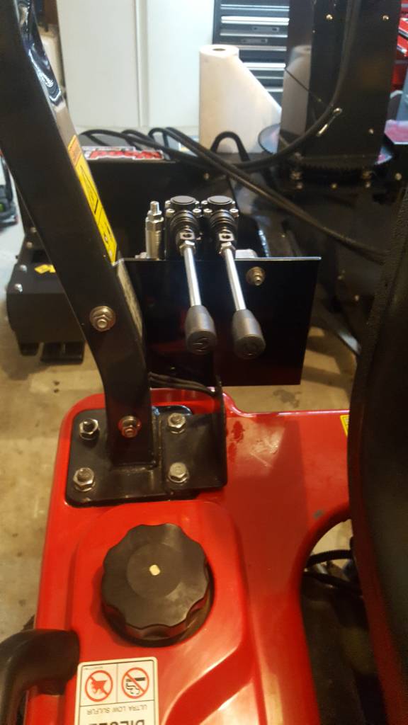

Someone asked for parts list for my hydraulic rear remote build (two spool option). I will have to be quick as I'm short on time but here is a start (I do believe you can do this with any GC, but you'll need more hose and further understanding to do it with the non-backhoe versions as you'll have to plug into the loader spool. With the backhoe versions you just use the lines normally used for the back hoe.
The actual spool I used
9-7862 2 SPOOL 8 GPM PRINCE MB21BB5C1 DA VALVE $151 from surplus center
some of the fittings I used (but be warned some of these were for other projects):
9-5405-4-8
9-6401-8-8
9-6805-8-6
9-6405-8-6
918-3224
9-5405-4-6
9-1626-A
9-5404-8-6
1/4 NPTM TO 1/2 NPTF ADAPTER
SAE 8M TO 1/2" NPTM CONNECTOR
SAE 8M x 3/8" NPTF 90 ELBOW
SAE 8M x 3/8 NPTF ADAPTER
3/8" X 24" 3/8 NPTM X 3/8 NPTM 4800 PSI HYD HOSE
1/4 NPTM TO 3/8 NPTF ADAPTER
1/4" MALE TIP S101-2 SAFEWAY
1/2 NPT x 3/8 NPT HEX NIPPLE
additional fittings (again mixed with other things for other projects)
918-3230
917-2272
917-2260
9-5924
9-6401-6-8
9-6401-8-8
9-6806-8-8
9-6806-6-6
9-6806-6-6
9-6314
9-5924
S45-2
3/8" X 30" 3/8 NPTM X 3/8 NPTM 4800 PSI HYD HOSE
1/2" X 72" 1/2 NPTM X 1/2 NPTM 4000 PSI HYD HOSE
1/2" X 60" 1/2 NPTM X 1/2 NPTM 4000 PSI HYD HOSE
1/4" NPT QUICK COUPLER TIP S41-2
SAE 6M x 1/2" NPTM CONNECTOR
SAE 8M TO 1/2" NPTM 90 ELBOW
SAE 6M TO 3/8" NPTM 90 ELBOW
Hydraulic cylinder for top link
9-7258-8
1.5X8X1 DA HYD CYL SWIVEL EYES
More fittings (I am just coping these from gmail order receipts) this is the bait to help you fish at the very least.
9-5504-8-8
9-6405-8-6
9-6405-6-6
9-6805-6-6
9-6901-6-8
1/2 NPTF TO 1/2 NPTF 90 ELBOW
SAE 6M x 3/8 NPTF ADAPTER
SAE 6M TO 3/8" NPTF 90 ELBOW
SAE 6M x 1/2 NPTF 90 SWIVEL
I think these were the quick connectors I used from titan-attachments
(2 Set) Titan 1/2" Hydraulic Ag Quick Couplers Interchange 4050-4 / 8010-4 Pioneer Deere (2)PC12M+(2)PC12F 3 $84.00
This was the 2nd hydraulic ram which turns the blade (not shown in any pics, I will try and get some taken)). I bought this from Dalton Hydraulic.
Dalton Welded Swivel Mount Cylinder 1.5 Bore x 6 Stroke DBH-1506-WSE 1 $84.74
This should get you started, in all I probably had $400 spent to have all this working. All the quick connects cost as much as the rams! If you want to same money and just need them on one attachment you could maybe bypass the quick attachments.

   / Almost complete: 2 spool 3rd Function top-n-tilt for GC1710 #14
Did you use existing hydraulics (from backhoe) or did you source the hydraulics from FEL (power beyond) ...
Dale
   / Almost complete: 2 spool 3rd Function top-n-tilt for GC1710 #15
I exchanged PM’s with GC1710 several days ago, he mentioned he was traveling due to work and wouldn’t be able to log on here for awhile. He’s not ignoring us. About the hydraulics, I’m pretty sure that he used the existing backhoe circuit.
   / Almost complete: 2 spool 3rd Function top-n-tilt for GC1710 #16
ok.... The problem I encounter is I can not find any information on how the BH hydraulic hookups up are implemented on the 1710 and 1720, unfortunately the 1705 and 1715 do not have these hydraulics implemented... The shop manual I have does a really good job of showing how FEL hydraulics (from valving to cylinders) operate but no mention on how hydraulics are plumbed on the 1710 or 1720 to get power to BH...Or in my case it would be probably be labeled as "power beyond"....
The frustration is that MF actually gives a part number for a power beyond kit, but local parts guy and corporate seem to be unable to supply the actual data about what it is (kit?) and how to connect it...
Oh well...
Dale
   / Almost complete: 2 spool 3rd Function top-n-tilt for GC1710 #17
I did a similar set-up on mine, using the BH lines 20190101_173219.jpeg20190101_173231.jpeg
