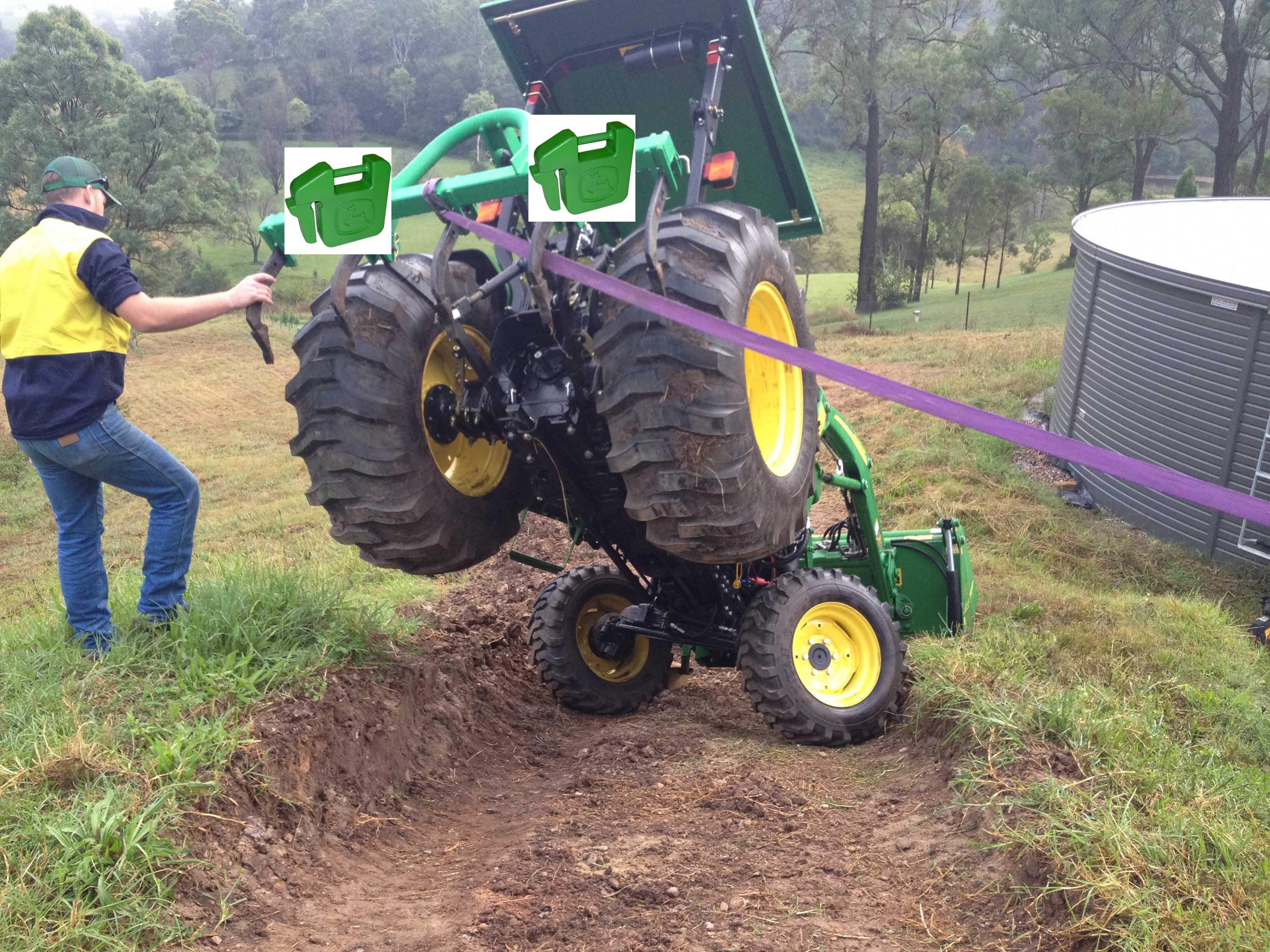

Everyone has mentioned ballast, including filled tires ("tyres" for the Aussie), but I think it should be emphasized again that 4WD is excellent preventive measure for accidents when using a FEL. Like someone else mentioned, most tractors don't have front brakes. In 2WD, when the back gets a little light you could go careening down a hill. I often skid down our gravel road to the barn in 2wd, but not in 4wd.
I'm gonna disagree a little bit.
It is the better traction of 4wd that makes these compact, short-wheebase, very nimble tractors rather unstable.
The loader tractor I grew up with - still have - is a 1947 or so IHC 'H' with no power steering, not even live hyd, a narrow front end. Obviously only 2wd.
This, according to the experts, is a death trap.
On the contrary, it's been a very stable, excelent loader tractor. Now at all easy to use with the poor hyd and no power steering, but - very stable.
Dad made a pair of wheel weights out of concrete - about 180lbs bolts onto each wheel. For heavy use, we add one more of those homemade weights out the back of the hitch, plus a pair of 100lb weights.
And this old tractor is rather long - weight on the rear wheels and behind the hitch is pretty far back.
So even with the narrow front end, very stable tractor.
And with only 2wd, if the rear end gets light, it starts spinning. Loss of traction, but no harm done.
Now with the little New Holland 1720 I got, with 4wd, I can pick the rear end up, and the front axle will continue to drive me into even worse shape.
So the 4wd can put you into more danger.
Then, using my 1720 pulling an empty wagon down the dewy driveway, the rear end got light & it wanted to jakknife me. With the front wheels braking, it wanted to jacknife me even worse. I'd have rather had the front wheels roll down the hill so I could have steered my way to the bottom. With the 4wd, the front end braked, while the rear end slide any which way - NOT a good thing. That's the most scared I've ever been on a tractor.
So, the 4wd can, again, put you in more danger.
In the case of this fella, he went down a too steep hill with an overly heavy bucket, and it tipped forward. The 4wd did not help him, perhaps the braking action of the front axle acually caused the tractor to flip, as he paniced and tried to stop quickly - the wrong thing to do. He didn't need good breaking at that moment.
So, again, the 2wd can put you in more danger.
Cant believe the deaer could sell that heavy bucket with that light of a tractor and not get the rear end weighted.
Tires _have_ to be filled.
More weight _has_ to be added in wheel weights and or something on the 3pt.
But I wouldn't drive that rig _period_ until the tires got filled with good heavy fluid - none of this lightweight antifreeze or wiper fluid; good calcium cloride or Rim Guard weight almost 2x as much, and the weight is _needed_ for this tractor. I'd be perfectly happy to have to replace a rim 30 years from now if the calcium chloride ate through - I'd be alive to pay that bill. Without good heavy ballast on the rear you might not make it 30 more years.....
Any of these compact tractors with those short wheelbases and powerful loaders _need_ ballast. They are all too light in the rear, they need fluid in the tires.
--->Paul

I didn't read all the posts so forgive me if I repeat someone else suggestions.
1.) Always use FWD (going down even mild slope) when the loader bucket is on the tractor. That is for braking.
2.) It does matter how far back the counterweight is located. The farther behind the rear axle the greater effect it has.
3.) Wheel weights and/or loaded tires lower center of gravity but are not too efficient as counterweight.
I use medium duty box blade as counterweight. But my bucket is most likely lighter and smaller, relative to the tractor, than yours.

Glad you're okay! Wow, that is a scary experience. Others have already chimed in and as others have stated, you need at least 750lbs back there (e.g a good heavy duty boxblade). Never ever put your FEL up that high, it can make a tractor very unstable. If you can't fit through where you're driving the tractor, go around or make the area larger to fit. Keep your FEL 2-3 ft from the ground as much as possible. Again, glad you're okay.

You should have backed down the hill. It's one of those things you learn after making this mistake.
   / almost flipped the tractor, really need some help! #99
I was going down the slope with an empty bucket, it was the first day i had the bucket actually! The path was cut with the rear grader blade that is 5 ft so as wide as the tractor so it just fit. The bucket was 6ft so i raised it because it didnt fit, i must have raised it too much because as the tractor was going down it started to fall forwards.
Also on another note the tow operator had a tractor of his own and got on the deere and attempted to push it down with the bucket, it couldnt do it?
I cant even raise the front two wheels using the bucket on flat ground. Is this an issue?
just went and attached the bucket and had a go, when the bucket is flat on the ground so like this ___ it lifted up the front maybe 12 inches?
But if i tilt it to around this angle ( less than that maybe 30 degrees) it lifts a lot higher.
Does this sound about right?
Yes. Now theres the issue of why the bucket could not push the back end down. ... Check your hyd fluid level. The pump may have been sucking air at that angle. You should probably run he fluid a little overfull ~ 1qt hi with the loader down to allow plenty to control it at higher positions if you need to when the tractor is inclined.
