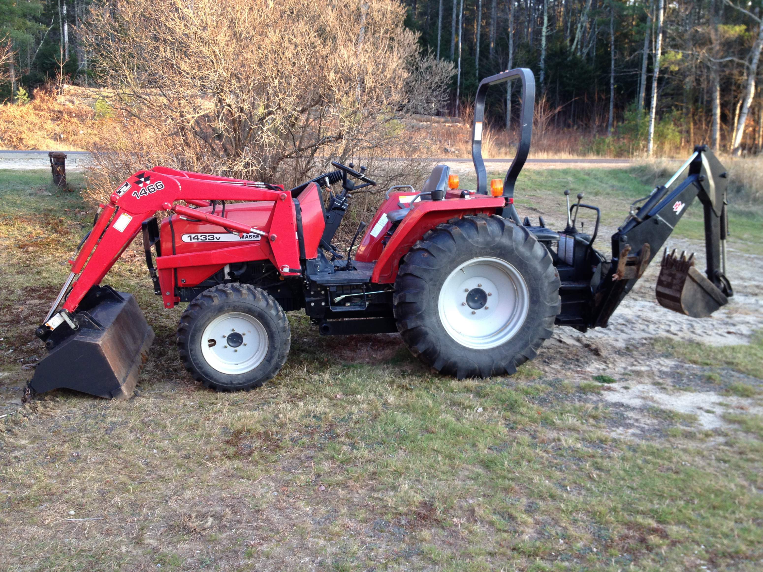

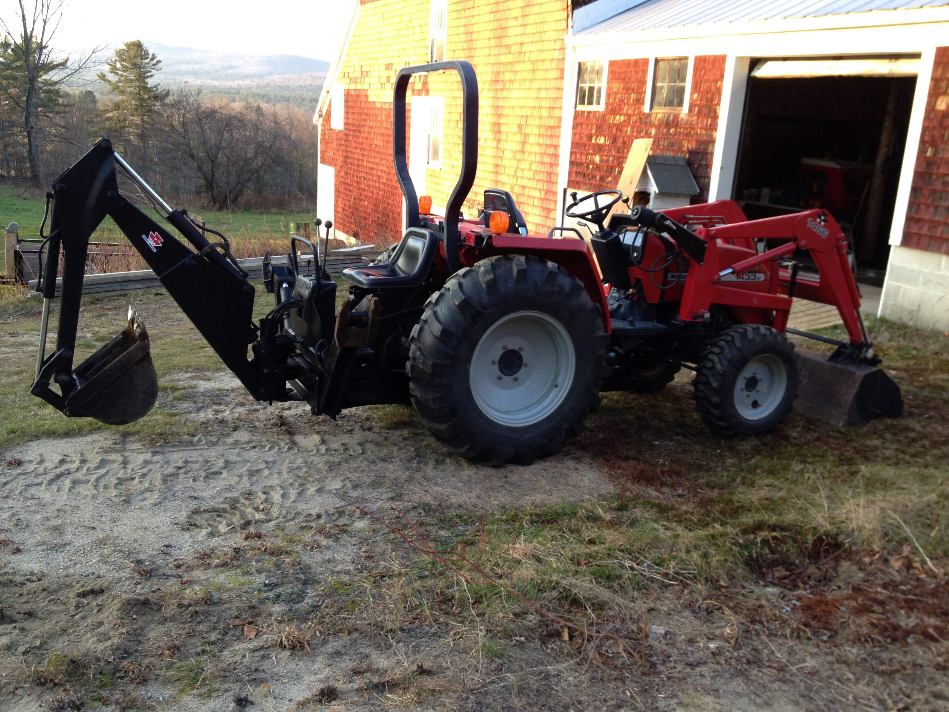

First time poster here who had a similar scary moment when I was new to my 1433V (even with ballast box). Everyone is who stated that you do not think logically or have the reaction skills that first time, is right! I tried to bail off and the seat safety cut the engine and stopped my eminent roll over. That was pure luck and a safety device doing its job. I learned a lot that day!
That was before adding the Woods Groundbreaker backhoe. I leave the hoe on all the time and think it is just great for counting the FEL. I feel very stable. For very heavy loads in the FEL I can load the hoe bucket with weight and also extend the boom and dipperstick out. 100 pounds in the hoe bucket extended out and low, can help significantly with heavy front bucket loads. I love that backhoe!

Welcome to TBN! I am glad your scare didn't result in injury or damage. I don't know if you are still a newby or not, but always remember that flimsy looking seat belt is a real life saver when your tractor has a ROPS, as yours does. Also, a hoe can provide stability in some scenarios and cause instability in others, so take it slow, keep your ROPS up, and your seat belt tight.
