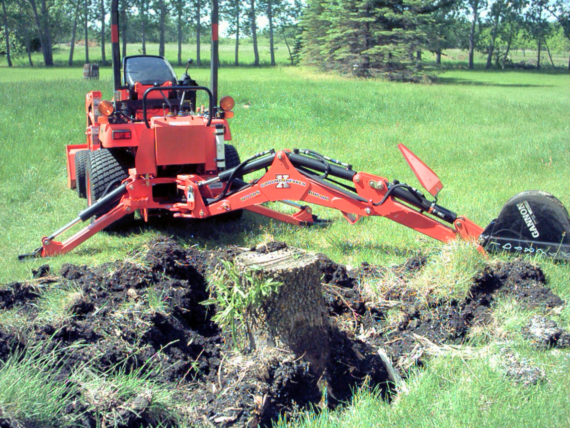

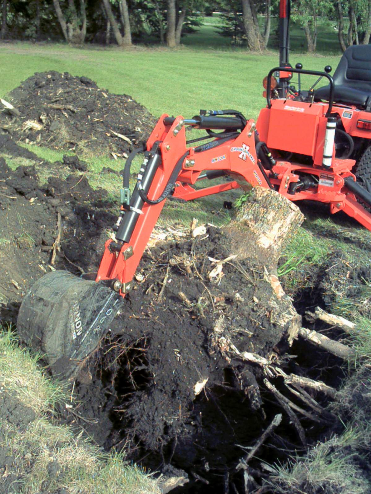

This was workout for my little Groundbreaker X 6500 when I first got it.
attachment.php
Oddly, very little axe chopping of roots. Granted it was a few years ago but I think it was more than a day of seat time!:laughing:
