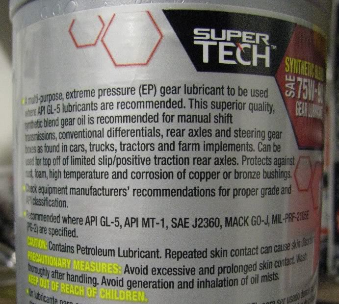

New Holland (and presumably CaseIH) 80W-90 GL-5 oil is yellow metal safe.
   / Alternative gear oil #14
if it does not say this I would not use it.
   / Alternative gear oil #16
I believe it is the MT-1 rating that is the yellow metal safe Identifier. Just about all the gl4/5 oils I've seen that claim to be yellow metal safe are also MT-1
