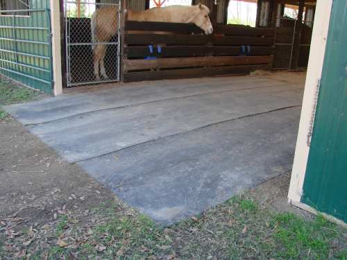

I've posted this photo of my barn floor in other threads. It is 3/4" thick belting from a grain elevator. It's easy to clean and virtually indestructible. You can drive a loaded dumptruck over it with no ruts. They also have 1/4" and 1/2" but they are not as tough. Just pack your dirt down well and put down the mat.
If there are grain elevators in your area, they replace their belts ever so often and give away or sell cheaply their old ones.
