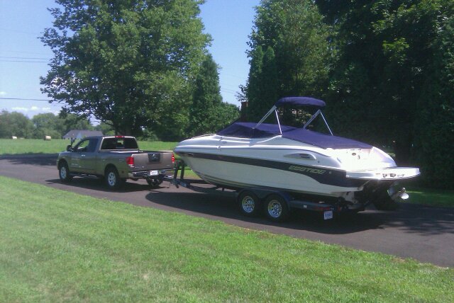

This must be a local thing. I have a 280' long drive and got quotes for Concrete and it was about $28,000 last summer. I had it black topped for $7500. I did go ahead and had a 6" 40x15 concrete pad poured in front of the pole barn so I could jack stuff up, ect.
I had enough of the gravel after 10 years. I was spending $500 a year to maintain it the way I wanted and it was non stop.
By the way my asphalt job took them 3 days. They did 3" total. 2" of heavy base and 1" top coat. They spent a day with 3 guys grading using a BobCat, rakes, and a 10 ton roller. They then put down the asphalt over 1 1/2 days then the rest of the 3rd day they graded the dirt and cleaned up. It was 4,600 total SQ FT. I had another guy do the Concrete work and it was about $2500.
So in the end I spent $10,000 versus $28,000.
Here is the only pic I have of the new drive. I need to get more.
Chris
