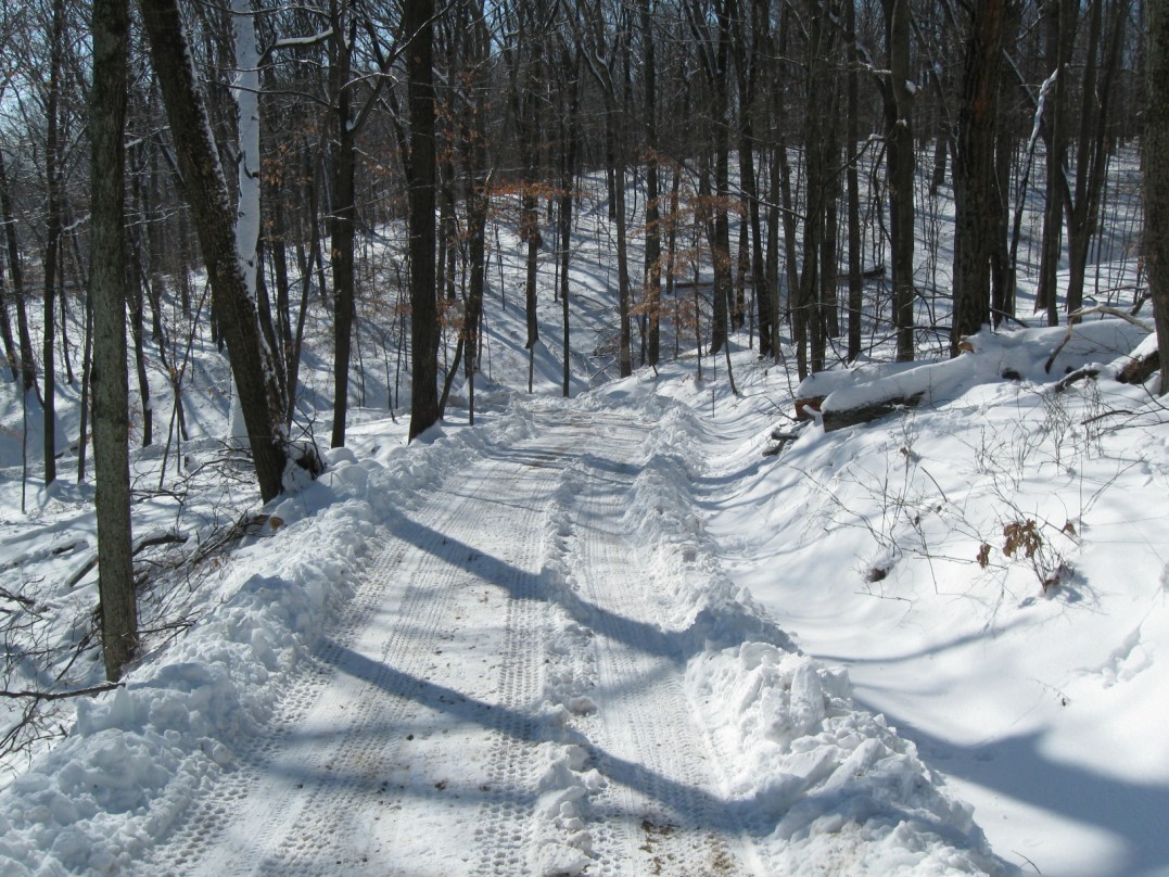

I have chains on the tractors. I'm looking, mostly for something for my Jeep Liberty and F150 4x4. Today is one of those few times that I'd feel better with more traction. I crept down with the Ford and didn't slide and did OK coming back up the hill. Don't think my wife would have tried it.
The picture shows one of problem areas. Making the curve going down or up can be ride!

The issue is ice. Jeeps go great, but stopping on ice is another issue. A vehicle starting to slide on that curve is very dangerous and hard on underwear. I have tried to break up the ice when possible, with the tractor chains and have even used a ratchet rake.

It looks like I did understand your situation then, if you look at post #4.
The picture adds even more clarity to your particular situation. I have another hill that is before the one described in post #4 that is not quite as steep
as yours but is 400' long and has a 90 degree curve like yours at the bottom. Luckily we have a field on the right side of it as well to slide into if it is drifted at that corner. Our jeep has a pan under the oil pan that becomes a big snowboard if the snow is too deep.
We usually put a roll of hay in the back of the 4WD pickup in deep snow and use it to get to the barn where the tractor is since the truck has lots of clearance.
Do you have room at the bottom of the hill near the road to have a parking spot?
You could leave or have your wife leave your town car there in these situations and have a jeep or your tractor with chains there to shuttle up and down the hill.
We have done that in the past with 2 WD vehicles.
Once the ice has formed or been packed it is going to be a waiting game with trees on both sides of your lane. Time to put on the boots and walk up to the house. We have done that a few times as well.

That's a tricky looking hill and turn for sure.
Would you consider widening the turn and putting some asphalt in that stretch? It would melt faster and drain better, leaving less time it is iced up maybe.

To the OP do you have a loader on your tractor? Maybe you can get a load of 1/2 gravel delivered before winter every year and spread it in the scarry spots throughout the winter. It would not be a waste as you probably have to add a bit of gravel to maintain it anyways.:2cents:

Buy a tandem load of small gravel and leave it in a pile at the bottom. Occasionally spread it on the ice. It doesn't take much to get great traction.

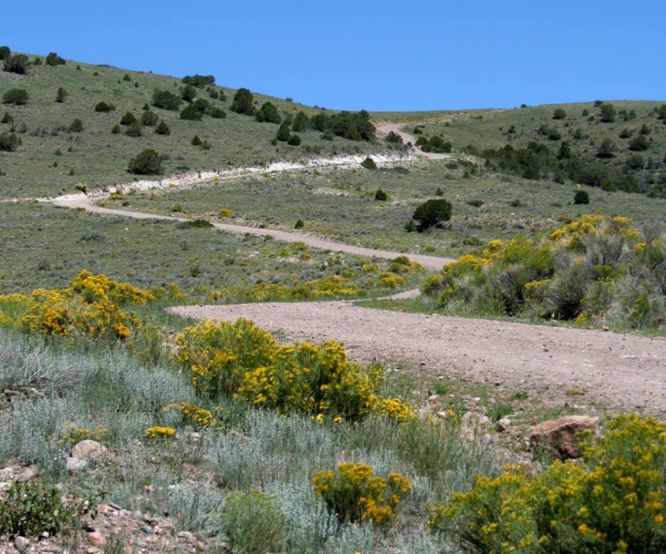

In the subdivision I have been looking to buy in CO, there are 2 "major" steep hills.
There is pretty much nothing to stop your slide all the way to the bottom, and both have switchbacks where you can go over the side pretty quick. This photo taken mid summer and it was just within the ability of my 2wd Dodge Ram to handle traction wise...
In speaking to residents there, they say that typically there are 2-3 months of the year where access by car of any sort is simply impossible. To remain mobile they park on the county road (which is serviced) and take a snowmobile up to the homes on top.

You need to cut some trees and maybe add a bit of camber to the turn (bank it so it isn't quite so bad). Winter is a great time to cut trees, especially in your mild climate. :)
