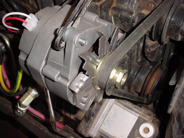

Here is what the GM 12si looks like mounted on my tractor in place of the OEM unit:
I went to an alternator shop and had them install a 2-1/2" dia x 5/8" wide belt pulley on a Delco (GM) 12SI 100 amp 3 wire internal regulator alternator.
Bob Rooks said his OEM pulley fit his Delco, I did not do that because my OEM pulley is 3-1/4" dia, I wanted more RPM's at the alternator shaft so had a 2-1/2" pulley installed instead.
The smaller diameter pulley is necessary to increase RPM of the alternator. The big concern was not burning up the existing wiring with the 100 amps available, or frying the 30 amp, amp meter. The solution was to wire the output of the alternator directly to the battery and not worry about trying to run all that "juice" through the OEM amp meter. With that said the amp meter now only indicated power consumed by the tractor electrics. Any added high power circuits should now be connected to the battery instead of through the switch to protect the tractor wiring.

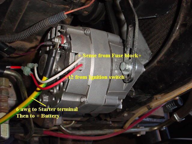

Basically the OEM alternator was removed, the wires taped off. Then remove the OEM regulator at the fuse block. Install the new alternator & wire the output directly to the battery with 6 ga. wire (through the starter post). Run the +12 ignition wire for the alternator to a new starter switch (that I was wanting to install anyway) Then run the alternator sense wire to the hot line at the fuse block. The OEM Belt was just fine on the new smaller diameter pulley, I was able to tension it with some adjustment left to account for future belt stretch.

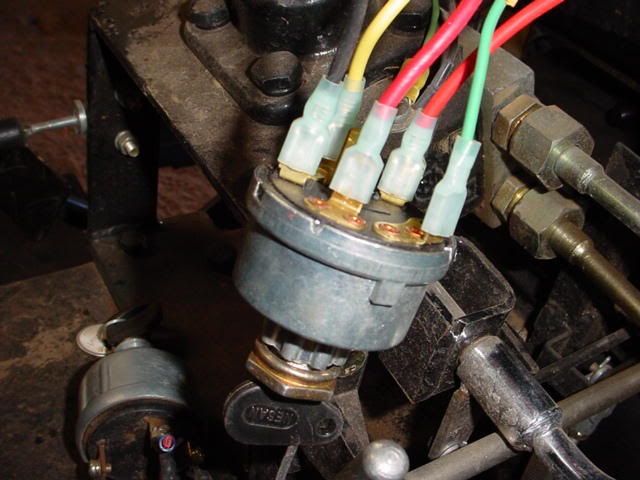

Here is the new switch, it's configured so that the glow plugs are activated during the actual starting cycle. It also still has the glow plug pre-heat function as well, in addition to a spare connection to add a dedicated ignition wire to the new alternator.
Here is the new alternator with some detail of the wires installed:

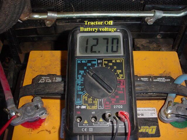

I took some voltage readings to make sure everything is wired correctly and to test the alternator's output at various engine RPM's
The battery voltage with the engine off:

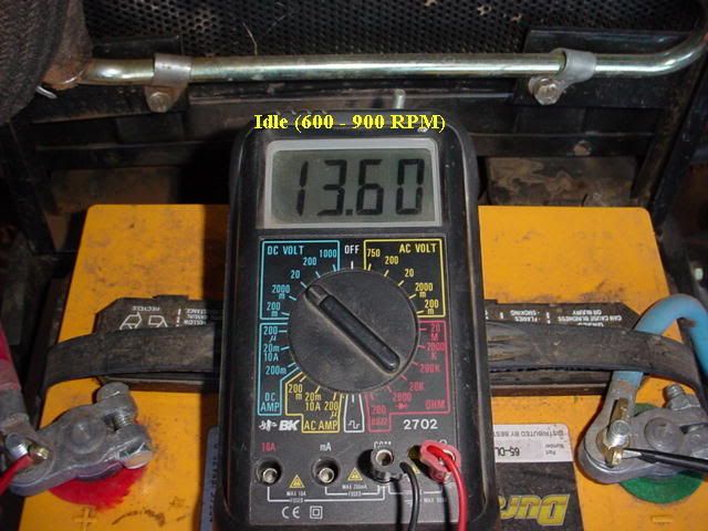

The voltage with the engine between 600 & just below 900 RPM and all the lights on max. Even at Idle it is putting out enough current to supply all the lights & apply a moderate charge the battery:

Some might say 14.92 volts is going to fry my battery. It's been like this for over a year, the battery is three years old now and so far it has not fried the battery or caused any other problems, so you can't argue with success

GuglioLs what switch did you use, mine has gone bad a i need to replace it. Thanks
   / Alternator appears to have quit after bath #24
Below is a link to the Starter / "Ignition" switch, with Preheat and preheat in starter position, it's the one I used:
FARMERLINK -- FORD TRACTOR PARTS 10/26/07
Part# A-E7NN11N501AB 14.03 + 9.00 shipping 23.09 total. Scroll to the bottom of the web page I linked to, then find part# A-E7NN11N501AB
It's a five position switch - Off, Aux, Aux+lights, GlowPlugs, GlowPlugs+Start.
It automaticaly spring returns back to Aux+Lights when released from the glowplugs or glowplugs+Start position. It's the perfect switch (IMHO)
