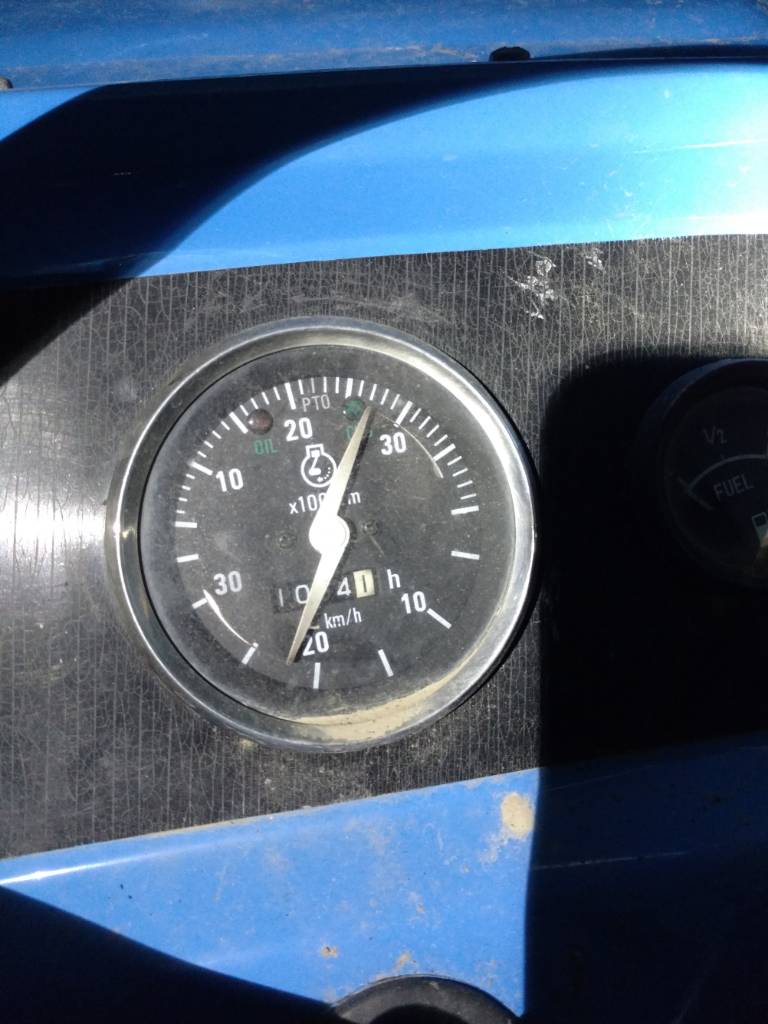

There are some odd scratch marks and burned looking ends of the needles that makes me think it was damaged, though I don't get how. I should take it apart. All its doing now is filling that hole, only the oil and alternator lamps work. IMG_20190417_194746085.jpeg

What is useful, from the face of the instrument even though not working , is the rpm the tractor engine should be run to provide 540 rpm at the rear pto.
Also, what road speed you would be traveling in kph in top gear at certain engine rpm's.
The heat of the sun could damage the thin ends of the needle(s)
Dave M7040

There are some odd scratch marks and burned looking ends of the needles that makes me think it was damaged, though I don't get how. I should take it apart. All its doing now is filling that hole, only the oil and alternator lamps work.View attachment 600830
Looks ok too me,,,,,personally I do not care too much about tach, but working engine hrs is useful for servicing and if selling,,,,
