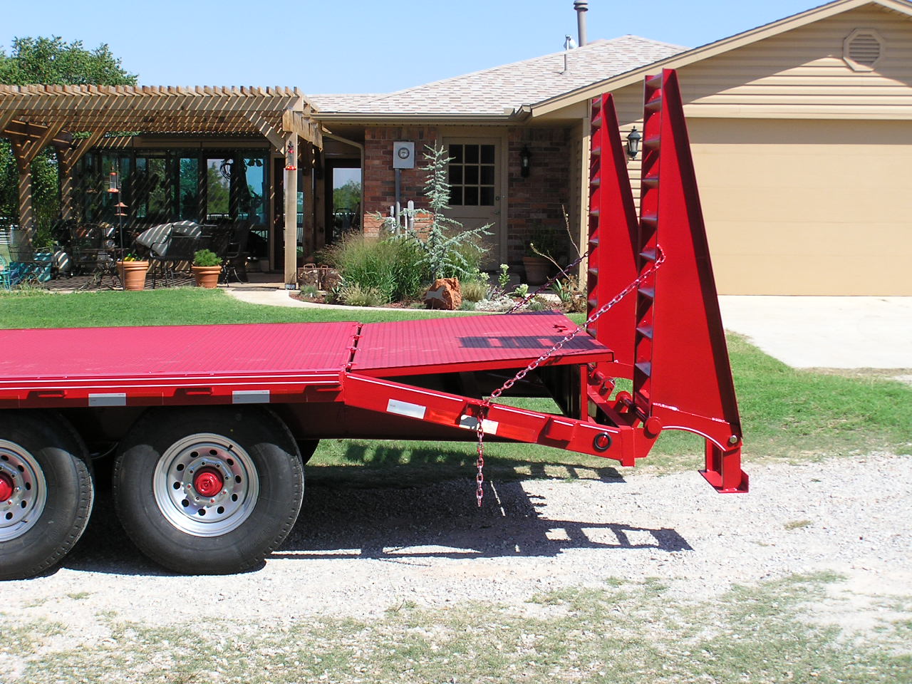

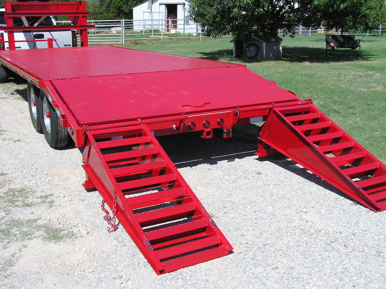

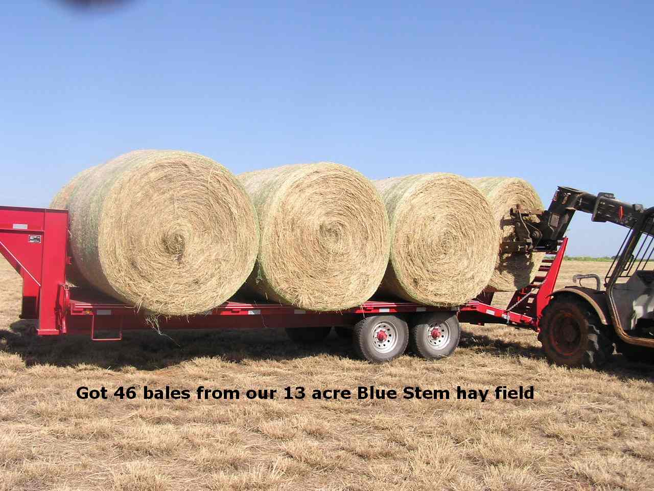

Every time that I have upgraded to a new trailer, it has been longer, at 22 feet, steel deckover now, but I haul 8 big round hay bales on it.
It has a 4 foot beavertail, so no problems with it dragging.

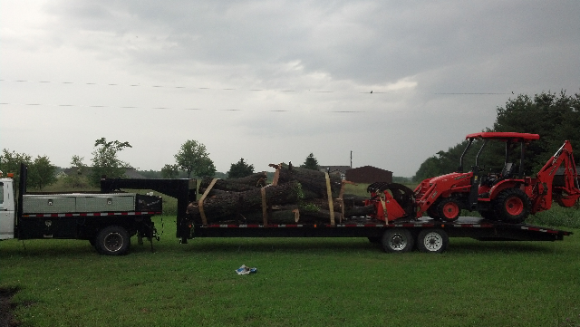

I have a b26 and with foam filled tires it comes in at 6200lbs. I have hauled it a lot on a 16 foot trailer but there was not much extra room. If it was me I would get a 20' trailer with 5200 axles or bigger so you have room to bring material with you if you haul it some where. And to give your self a safety margin.
The other day I used it for cleaning up after a tornado and I brought some logs home. And I really like deckovers for easy of load material.

Both look like nice trailers. I also would go with the longer trailer with 5200# axles. I bought and 18' trailer for my B21 and it worked fine until I decided to add an L39 to the fleet. Now I wish I had gone 20 or 22'. The B21 with a 4' rotary mower has the tail wheel hanging off the back about 6" on my 18' trailer. I get by but don't haul much or far. You will eventually want to fill the tires on your B26, it makes so much difference, so the extra capacity gives you more flexibility.
