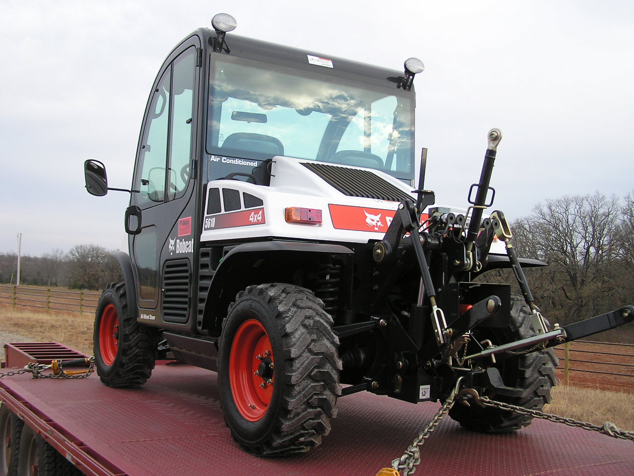

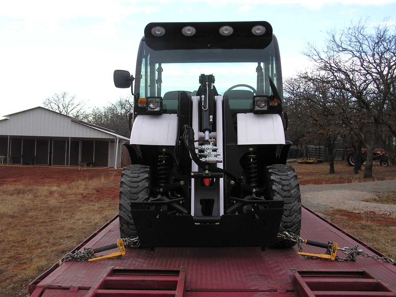

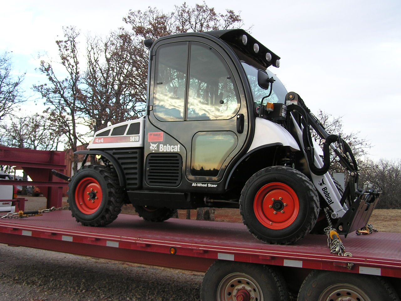

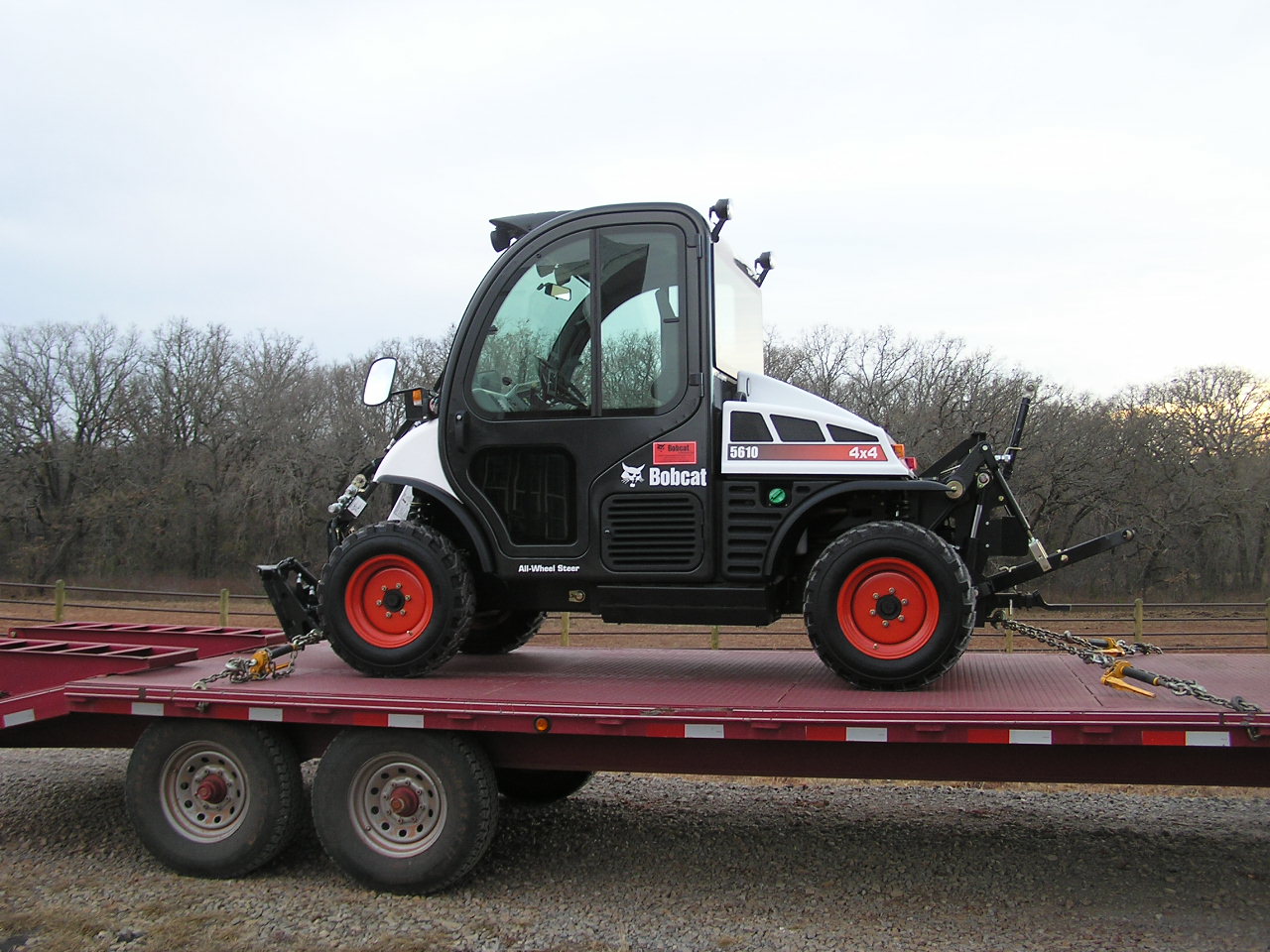

Only deckovers for me for hauling equipment. :D :thumbsup:
Notice, there are no dents in the steel deck! :laughing:

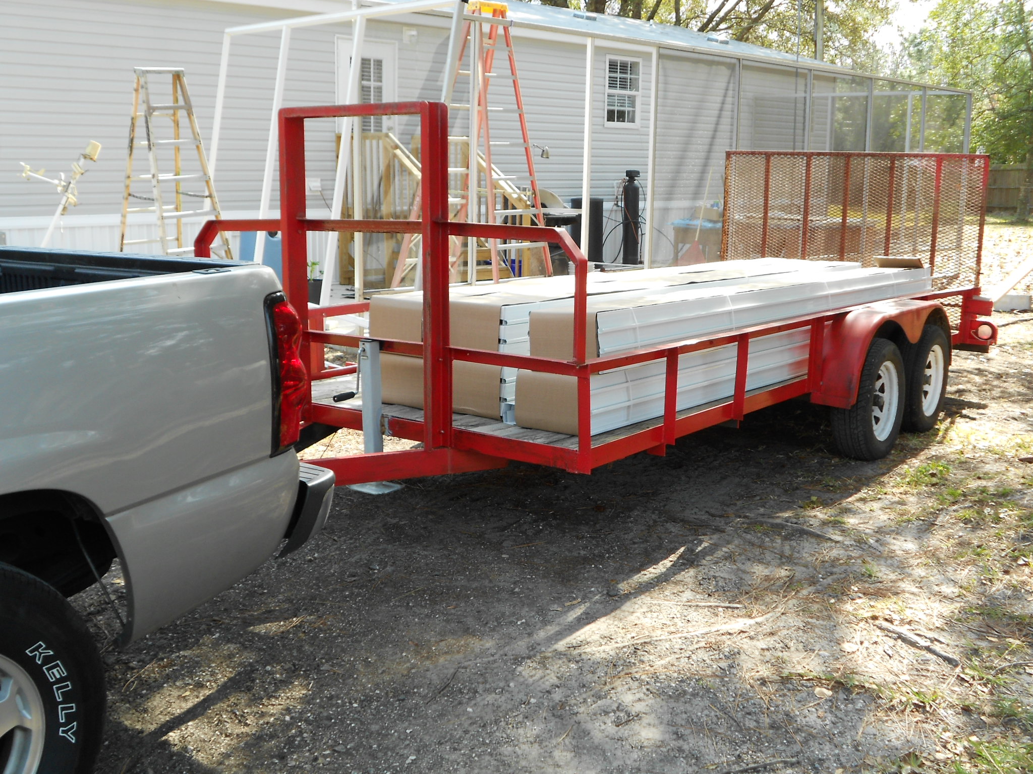

Steel frame trailers bend, Aluminum frame trailers crack/break.
Steel rusts, Aluminum corrodes.
I repaired semi tractors and trailers for over 30 years, supervised 3 shops. There is no way I would spend the extra money for an Aluminum trailer. There is no real advantage to them in the smaller sizes.
Here is a pic of my $500.00 16' trailer. When I got it the frame was racked so that it "dog tracked" 1 1/2' and had one spindle cut 3/4 of the way through with a torch. I straightened the frame, welded on new spindle, built the bulkhead (for hauling appliances), lights and painted it.
This trailer has 3500lb axles with one axle brakes. It tows like a dream!!!

Nice job on the rebuild.
