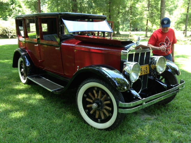

My 1926 Franklin has an aluminum body with no steel used at all in it. The engine is aluminum too. Plenty of curves in it and I can't find any rivets.
Lots of brass and wood in it also.

And a very limited production vehicle...basically hand built. Not a very good comparison to a mass produced pickup.

What a beauty!
