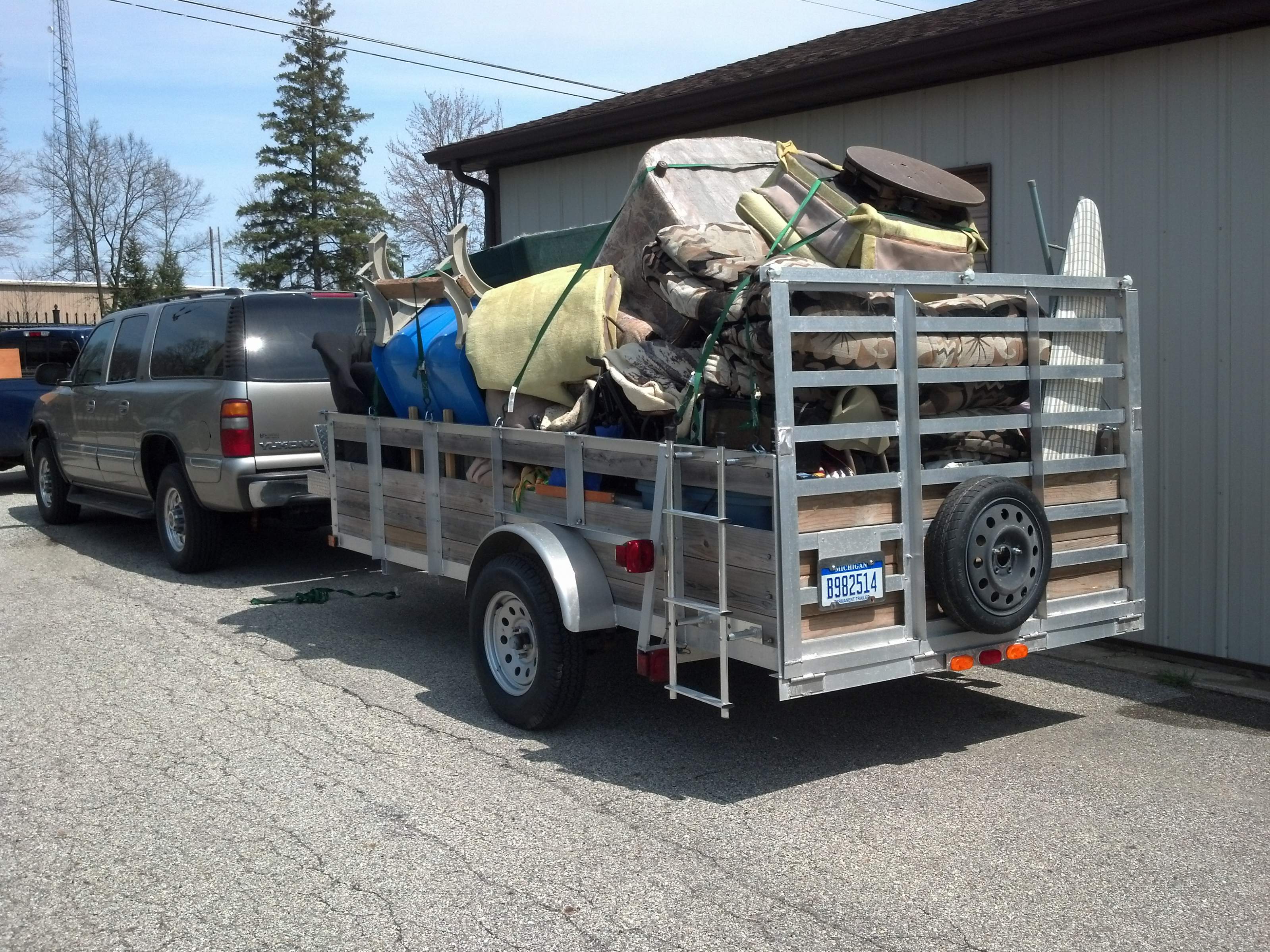

Can you ratchet strap things down and not bend the aluminum?
Depends on the kind of straps you are using!!! I ran this trailer tens of thousands of miles loaded and never had an issue with flexing but I did not overdo it on the ratchets nor did I use wide ones...just the smaller type. The bracing created by the front corners and the stiffness of the tailgate and the added reinforcement of the 45 degree bracing on the rear section makes a well made trailer very strong. You do get what you pay for in an aluminum utility. This one cost me $1550 out the door six years ago with tax and a new plate. Notice the D-ring tiedown loops bolted onto the top rail. When I had to transport something heavy, I used the larger ones bolted to the side uprights just above the third board up.
