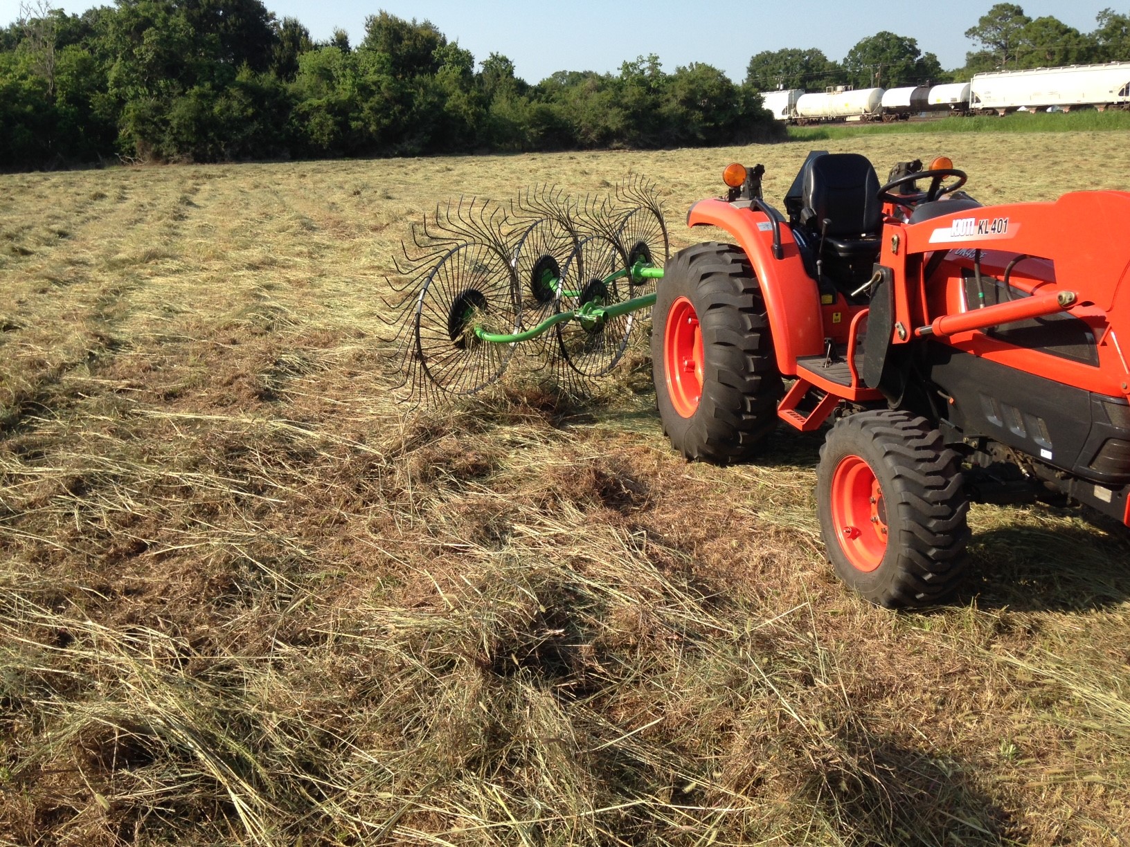

Going to drive up to Small Farm Innovations this weekend to pick up one of their drum mowers they sell. They also have a 4 wheel, 3 point rake that I am looking at. I only have 10 acres I am haying and I've been looking at tractor house and craigslist, but haven't really found anything other than some side delivery rakes. One of those would be okay, but I wouldn't be able to fit it in my barn, whereas I could the 3 point rake. Everything else I can fit inside, including the baler I already have. It looks like the 3 point rake can be setup in a couple of different configurations to "perform" a few tasks. My ground is flat, grass is jigs. As long as it does a good job of not leaving a lot of grass behind, I would be okay.

Hay got cut this morning. I got the new rake out and put it in the "spread" configuration. I'm pleased with how it did that. This thing has a learning curve for sure. Still trying to figure out how much pressure to put one the wheels, angle of attack etc.

I think you'll be happy with it for what you're doing, I have about the same acreage in hay and I have a five wheel 3 point rake find it useful. I also have the SFI drum mower and have been pretty happy with it.
My favorite thing is that it can be taken apart into pieces that I can lift by myself and will hang on a wall. I have a row of nails on the wall in my barn where it hangs the 360 or so days a year I'm not raking hay.
I find it very good for not leaving grass behind. However, since it's on the 3-point it hangs way out behind the tractor, and moving the front of the tractor by an inch moves the rake by a foot. That makes it hard to rake straight lines when it's time to windrow for baling. When the lines aren't straight it can be hard to pick up the whole windrow with the baler. It also leaves the bales in the field in a crooked line, and when I go to bale the next row I sometimes have to dodge the bales lying on the ground. I find it saves time in the long run to windrow at a slightly slower speed and keep the rows straight.
I really like the spreading feature, I open it up all the way and drive fast and can "fluff" a field in a few minutes. I do find that if I do it multiple times the hay starts getting tangled into lumps. A little bit of tangling is good, when the hay is slightly "roped" in a good straight windrow the baler picks it up quite smoothly, it's like pouring syrup in reverse.
When windrowing you want to avoid catching a windrow you've already made, you'll leave a big lump. If your rake is set up on your right you want to keep windrows that you've made on your left, driving on raked grass and with the rake in hay that hasn't seen the rake. That means starting in the middle and driving in a counter-clockwise widening spiral. My baler works better in straight lines so I don't do circles, more like ovals.
When the grass is heavy I find my 24T baler tends to jam if I rake a windrow from more than about 6' of field, so I set the rake at its narrowest setting (steepest angle).
Since it's ground-driven it tends to accumulate hay at the ends of rows. That isn't a huge problem, but it means that bales tend to accumulate at the ends of rows, where they're often in the way.
You'll need to lift the rake to back up or to go over a windrow. I wish my rake were better balanced, when I lift it there is always one wheel that touches the ground.
Always put it on something when you take it off the tractor. The stand that came with it is useless and broke off quickly. I welded it back on and it broke again. I usually grab some stones or firewood to hold it.
In summary, it gets the job done and is good value for the money. A more sophisticated rake is going to be easier to use but quite a bit more expensive. There is some learning curve.

quicksandfarmer. I do have one question for you. What are the effects of different top link adjustments? What happens when the top link is long vs short. I've been running it with the rake post pretty much vertical.
In my very limited playing with it yesterday in both modes, you are 100 percent correct on all points !! Yes, I learned that if you mess with a previous windrow , it won't end well lol. Great tip about starting in the middle of a field and working your way out. I'm finding I like it set at the steepest angle. Although it reduces the coverage width it seems the wheels roll easier. I do find that if I just ease the 3 point down, the leading wheels with touch first because of the off center weight so I have been dropping my 3 point some distance to where all the wheels contact then I ease my 3 point up until I am where I want to be.
   / Am I going to hate a 3 point wheel rake? #10
with 3 point rake you want the wheels to just touch the ground , tilt the top link in or out to get them all touching at the same time .when you lower it. I have also seen folks not pull the pin to allow the springs on arms to float . this is very helpful if you have uneven terrain . The angle should be what your comfortable with and how wide you want your windrow. I ran a 3 point 8 wheel for years and now have an 8 wheel with a caddy. there are times when I chain one side up and just use the other to roll a windrow over .
