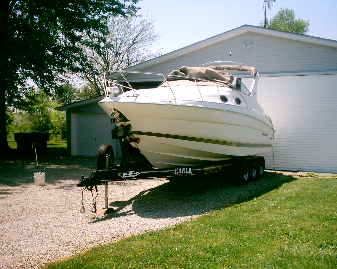

I am glad you called and cleared it up. Towing a boat that has over 1,800# of tongue weight I can tell you its a lot. Way too much for my F-250 and my GM 3500. My F-350 4x4 PSD SRW handles it ok but its got the heaviest suspension for that year at 11,500# GVWR. I could have went with a dually but I do not care for the looks, the trouble, or how they handle the deep snow we get here. Trust me, anything near a ton of tongue weight on a bumper pull will make the toughest trucks feel the pain. We put it behind my buddies 2004 GMC 2500 6.0 gas and it squatted it nearly a foot. He would not leave my drive with it on the back.
The trailer for it has 3 6K axles and those are 2" x 10" main beams on the trailer. It has 10 ply 6 lug wheels and tire combo.
Chris
