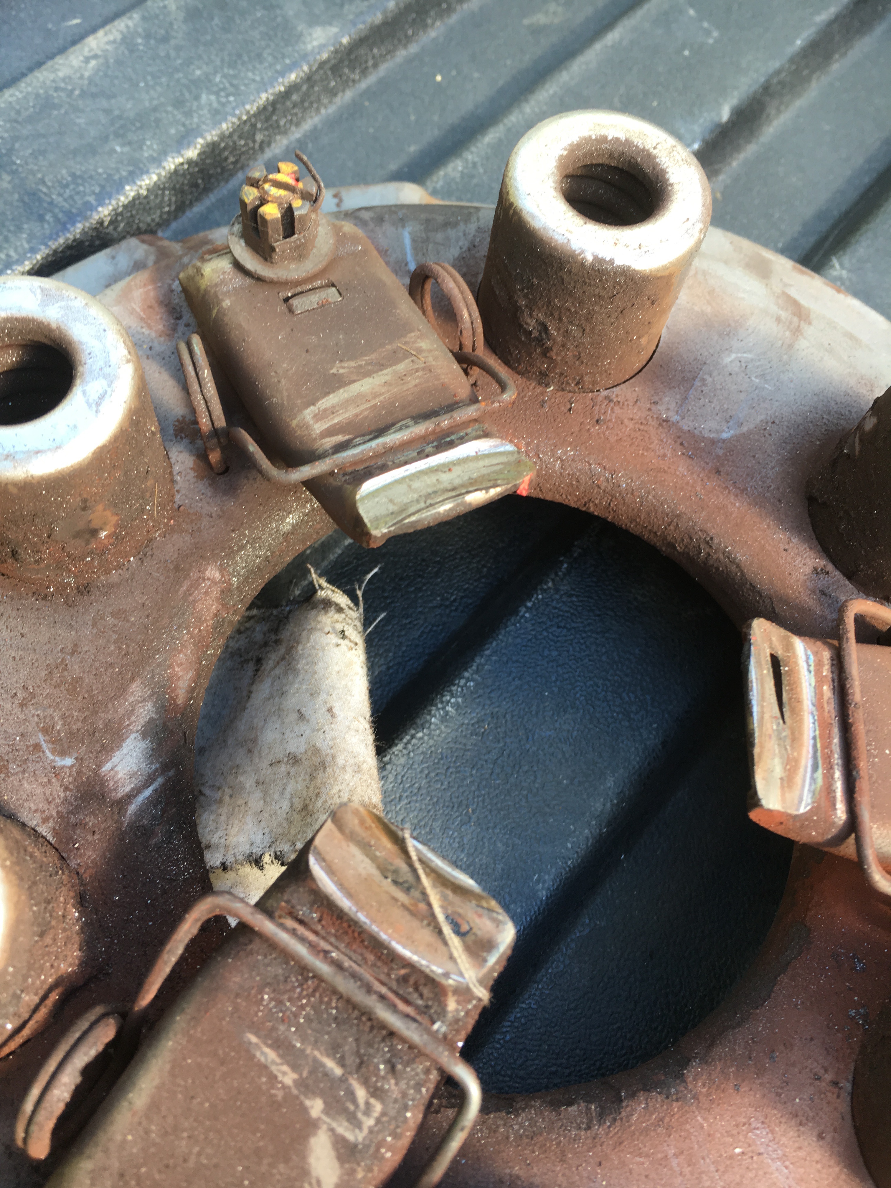

Have to replace my clutch last year, there was just no adjustment left on the rod to reduce the free play.
Attached pic of pressure plate after 30 years of plowing snow with it.

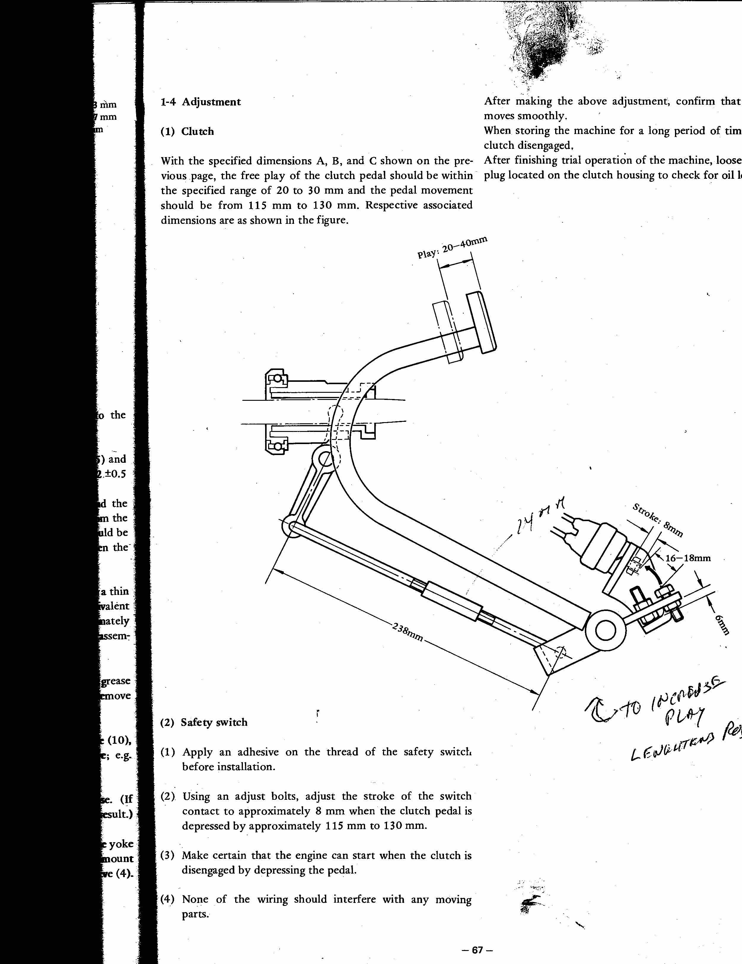

I can not find anything helpful in my owners or services manuals, How is the clutch adjusted?
   / Am I missing a clutch adjustment rod #17
John,
Attached is the adjustment instructions from the manual I have.
Hope it helps.
#18
John:
I think the rod I referred to in my first post, second picture, is the 238mm shown in your picture, can you verify this for me?
John
   / Am I missing a clutch adjustment rod #19
John
You really can't see the clutch rod in your picture.
The rod is mostly in the drive shaft tunnel, pretty much centered.
If you look under and move the clutch pedal you'll be able to see the rod and turnbuckle.
