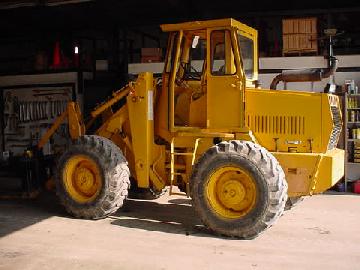

You need to park your tractor and get what we have for loading your new toy.
