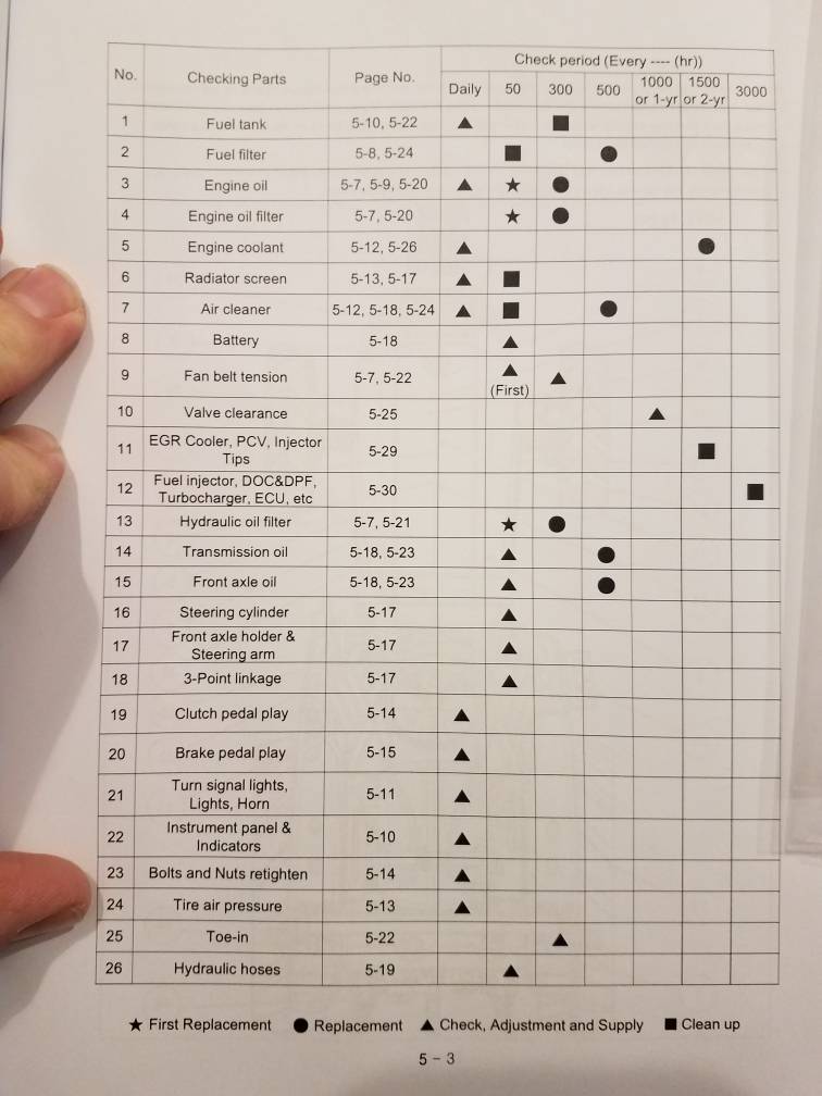

FWIW I did check my manual and after the 1st 50hr service it is at 300 hrs. This is the MT2xx manual. JPEG_20200121_185602_4579268354993984839.jpg
