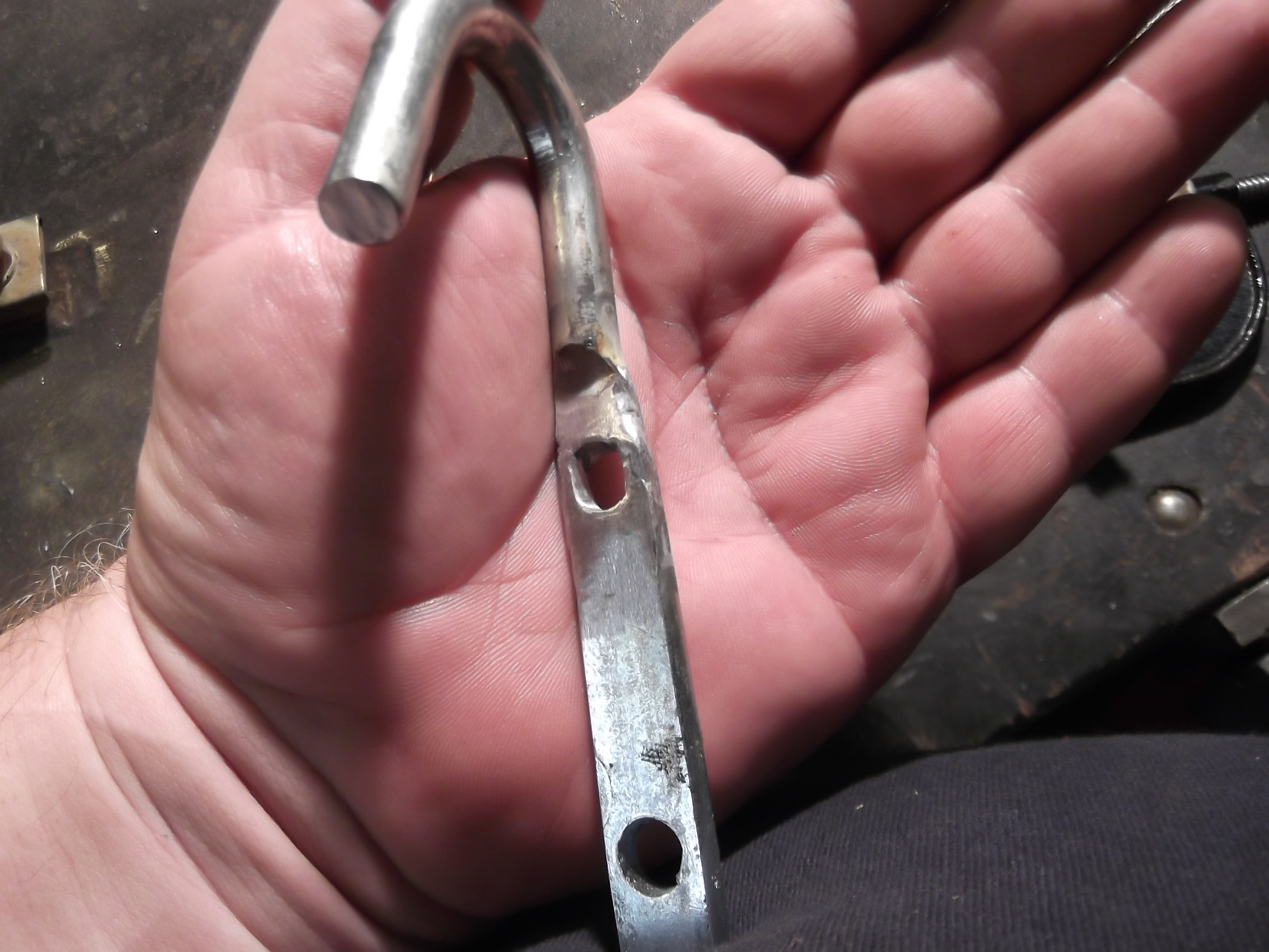

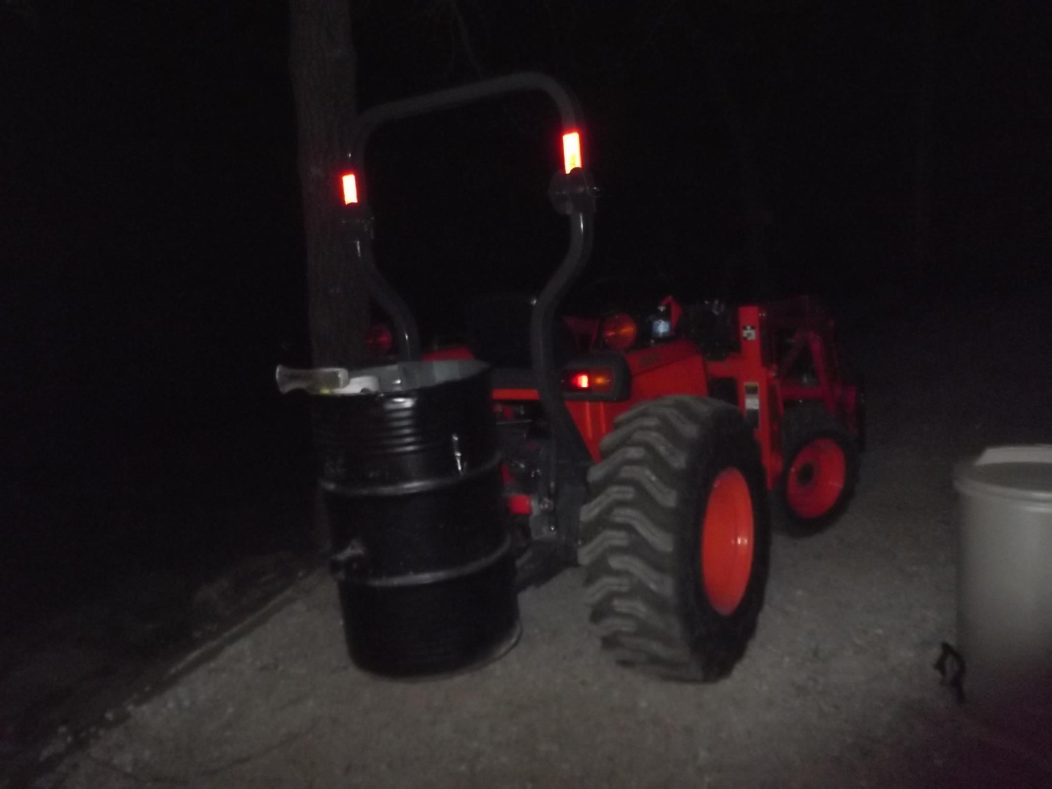

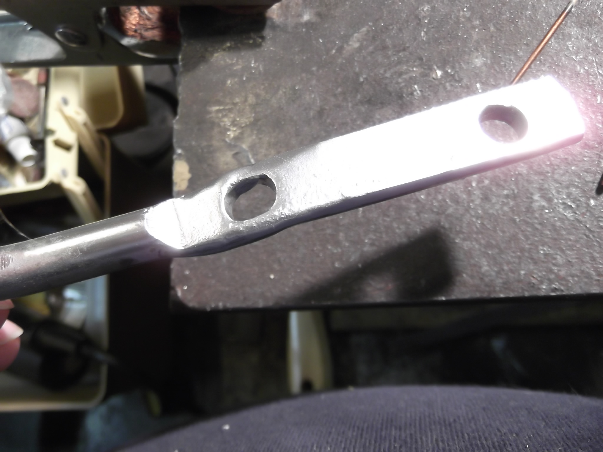

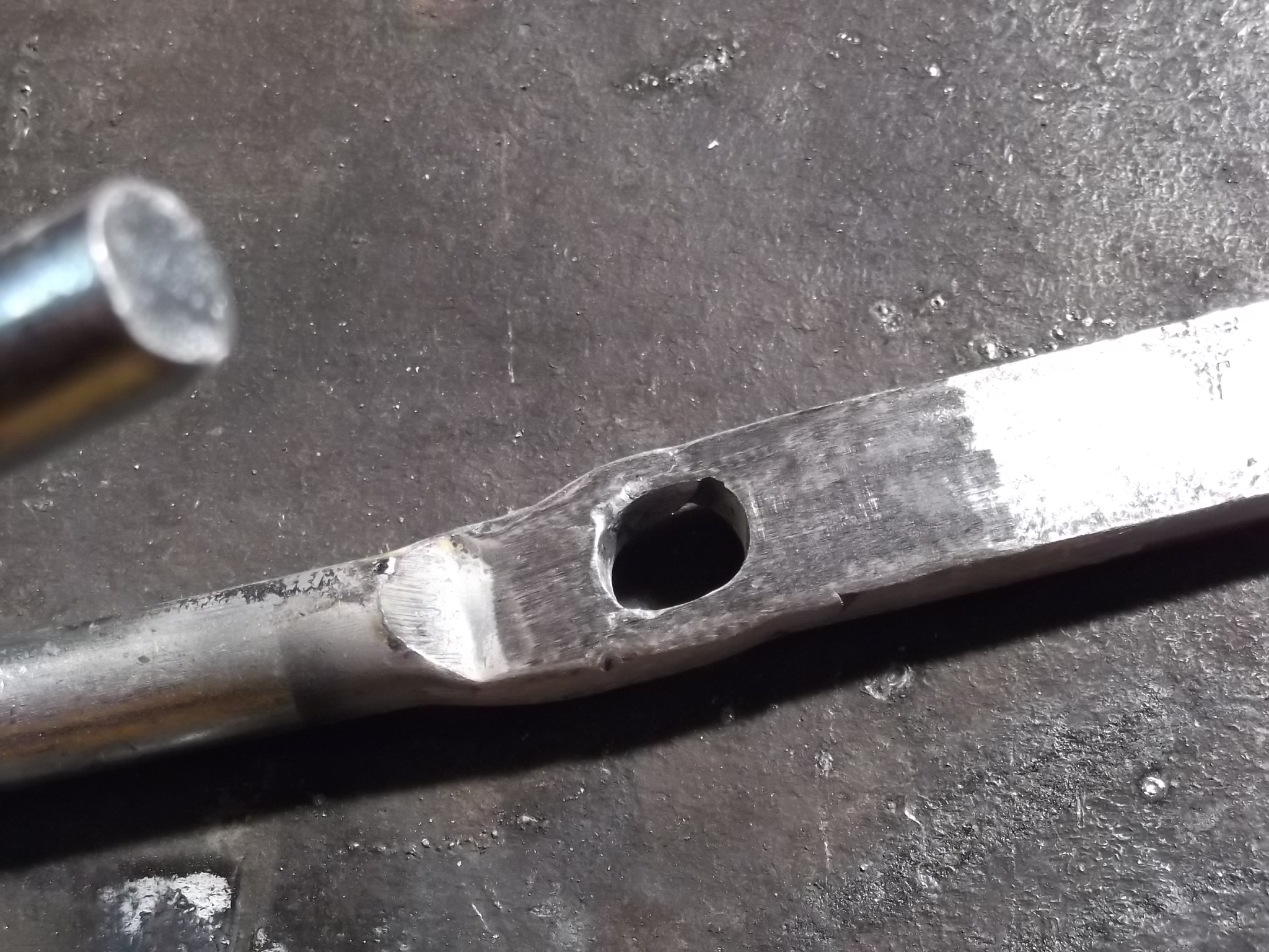

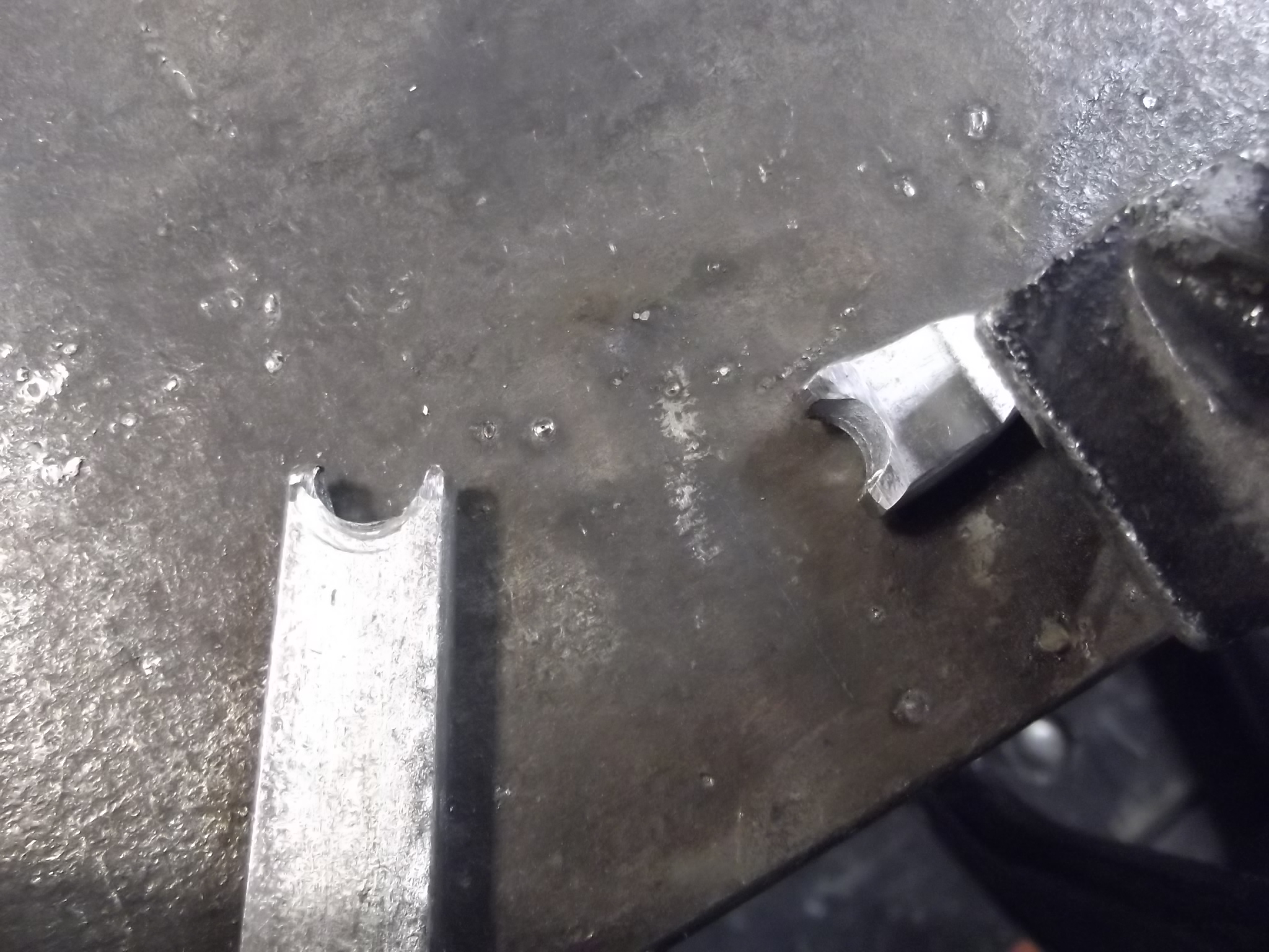

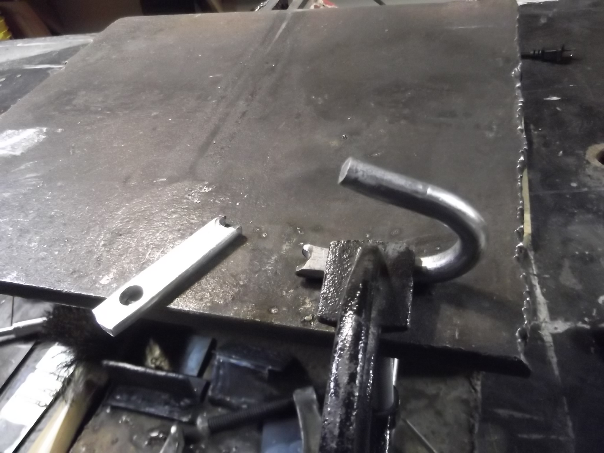

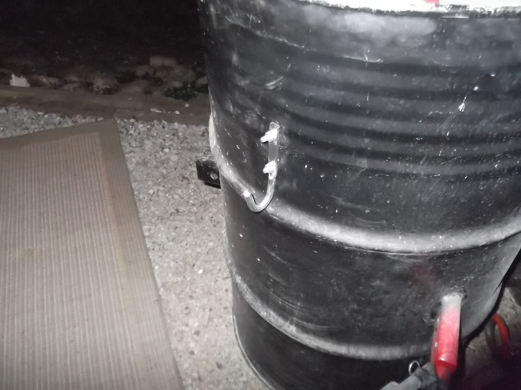

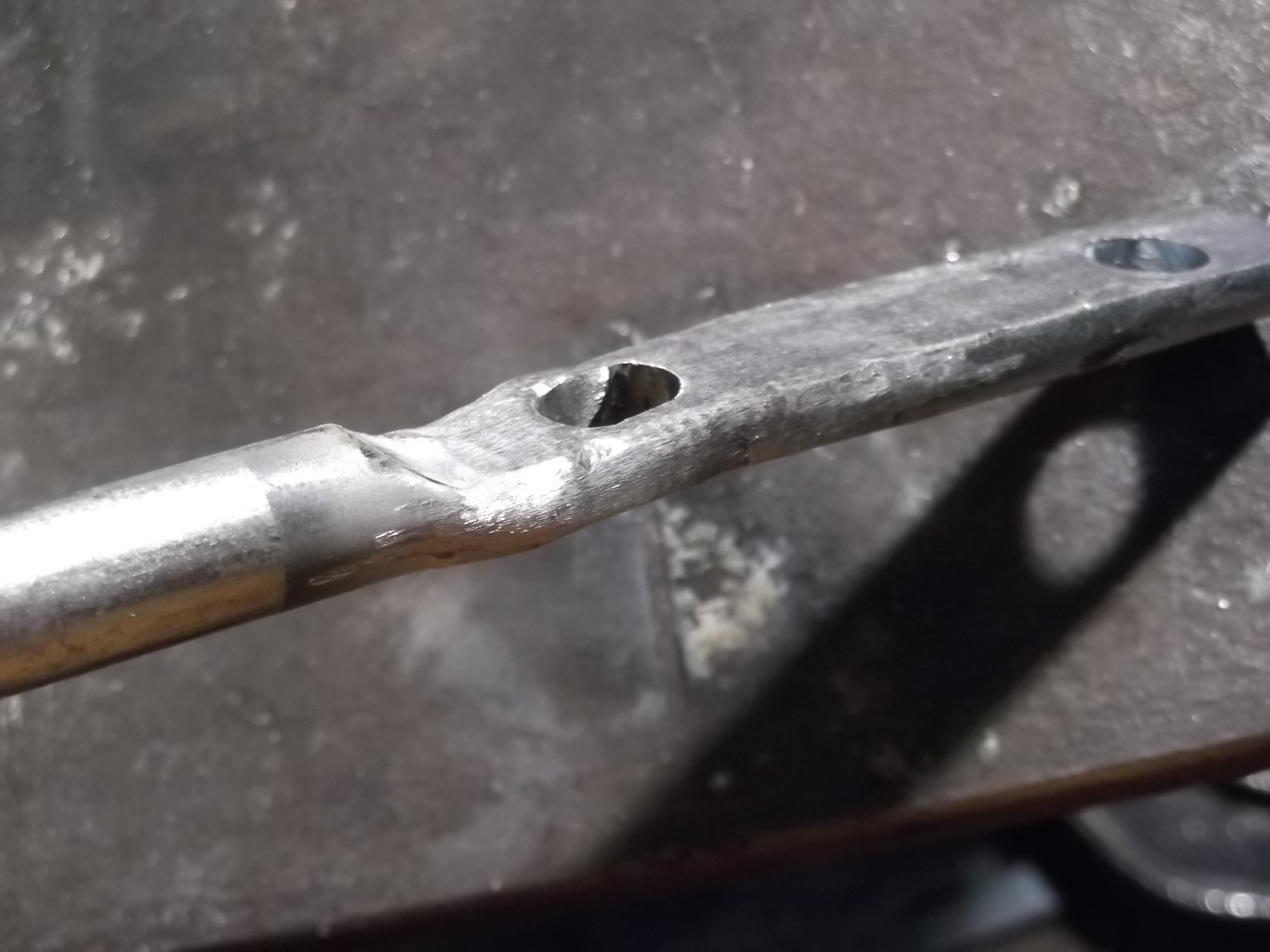

Some of you may think this repair is just stupid or a waste of time, BUT I would like to point out since I broke one of the hooks off of my ballast barrel some time ago (my fault, stupid accident) I have been trying to remember where I bought it and get another matching one to fit the already drilled holes and bolts that stick through that also hold my chain retainers inside. I just did not want to redo that and have the unsightly extra holes for rust etc. After the 3rd try of buying hooks at all of my usual haunts and still not finding the right ones, I decided to weld the broken pieces back together. I Tig'ed it with the Everlast PA160 at 27 amps with 1/16 lanthenated tungsten I did not prep it very well, but figured it would do. It is back together and I think stronger than original. Ok so I am crazy for doing this, but it did not cost much, and is good experience in repairing small parts any way, and it is repaired:)

Looks good but you still didn't tell us how you stupidly broke the hook.:D

It's a barrel for crying out loud it's supposed to look used and beat up along with all of the attachments. :D

I knew someone was going to ask that:).. I had been pulling logs from the fixed draw-bar, and when backing up sometimes wrap the chain between the two hooks to take up the slack.. well somehow I left the chain draped over one of the hooks, and hooked up the tree/log, and of course it yanked the little hook down and out in a fraction of a second. Whoops,:eek:

That's a project where a foot pedal really helps. What filler did you use?
You know that old saying, right?
   / Am I stupid or crafty?
Just some house brand ER70S2 TIG rod. 1/16 inch.. what old saying? (why do I feel I am walking into something:eek:)

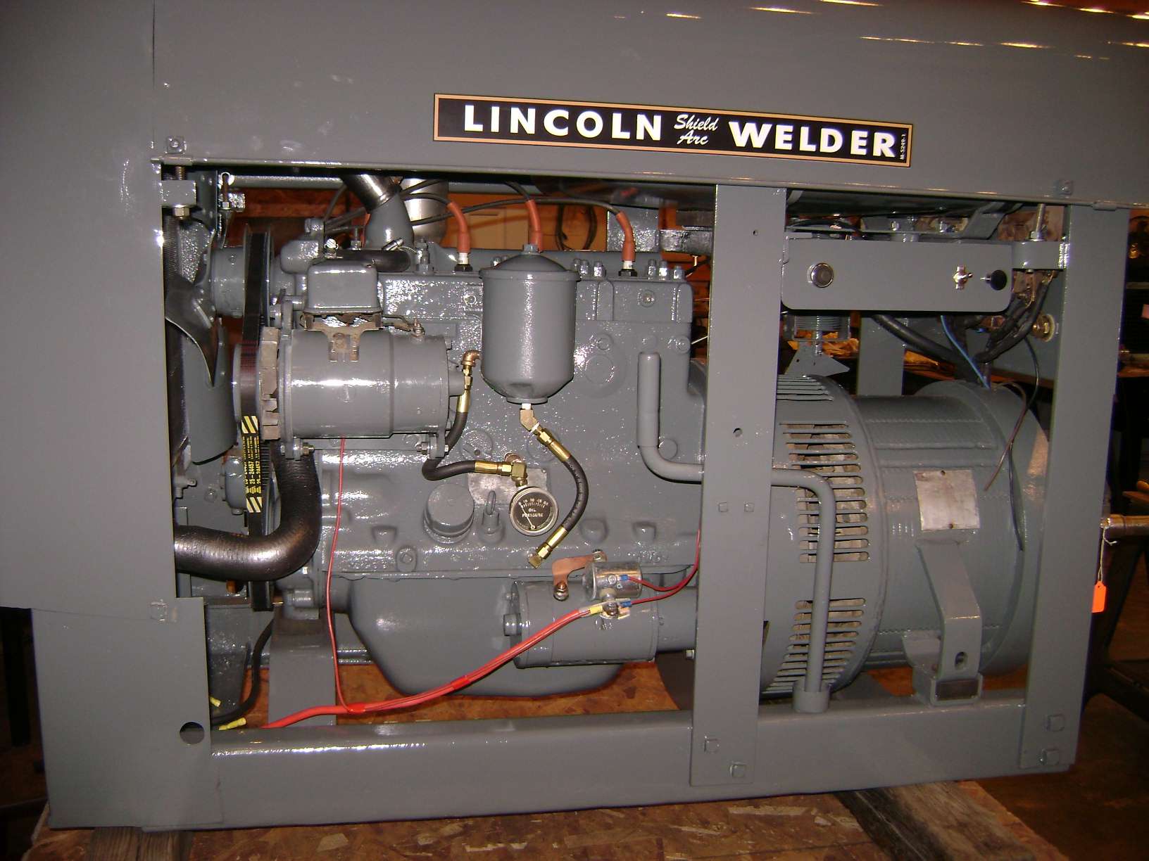

I had to chuckle with the title of your thread. I've been known to weld bolts together. When I restored this old 1948 welder, running a die nut over the threads of the square head bolts just didn't work on some of them. No problem, I cut the square heads off and welded them to new bolts. Sometimes it cost more in gas for me to run all the way into town, you'd be surprised what I'll weld up to save a trip to town.;)

Just courious but what do you use the hooks for? they are pretty light weight.Good job on the welding nice looking work.

HAH!.. doing that with stick would really suck! Not saying it couldn't be done, but you are a better man than I Gunga Din if you can do that! I don't think Mig would have worked very well either,, OA would have been fine, and if I break another one, then OA it is:laughing: As for what I use the hooks for,, Mainly for draping the pull chain.. One end fastened to the drawbar clevis, and when you back up you can drape the chain on the hooks temporarily to get ready for the next pull. You can also hang a 5 gallon bucket when you are going out to do something and need some tools or supplies. They are just handy for anything you want to hang. Just dont try to pull the next tree or log with a drape of chain still on the hook:eek: Accidents happen...welders make it all better.:)

I did, and I replied to your regular e-mail address. As for TIG rig if you have a DC stick welder you are about halfway there to the TIG rig.. sure it is Lift Start, no pedal etc but still works. That is what I done this repair with just a DC stick rig that I added the TIG torch, argon cylinder and regulator.
