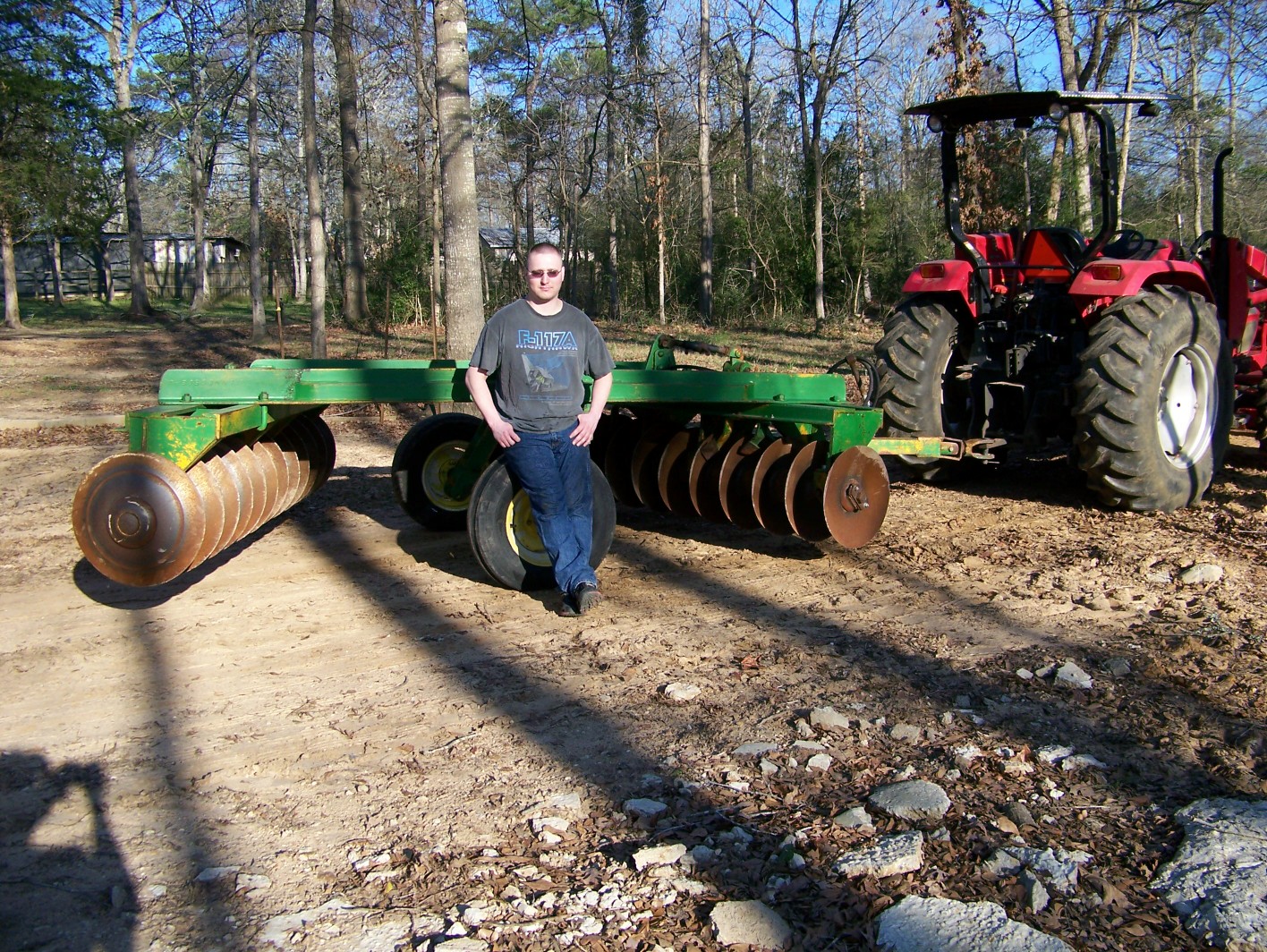

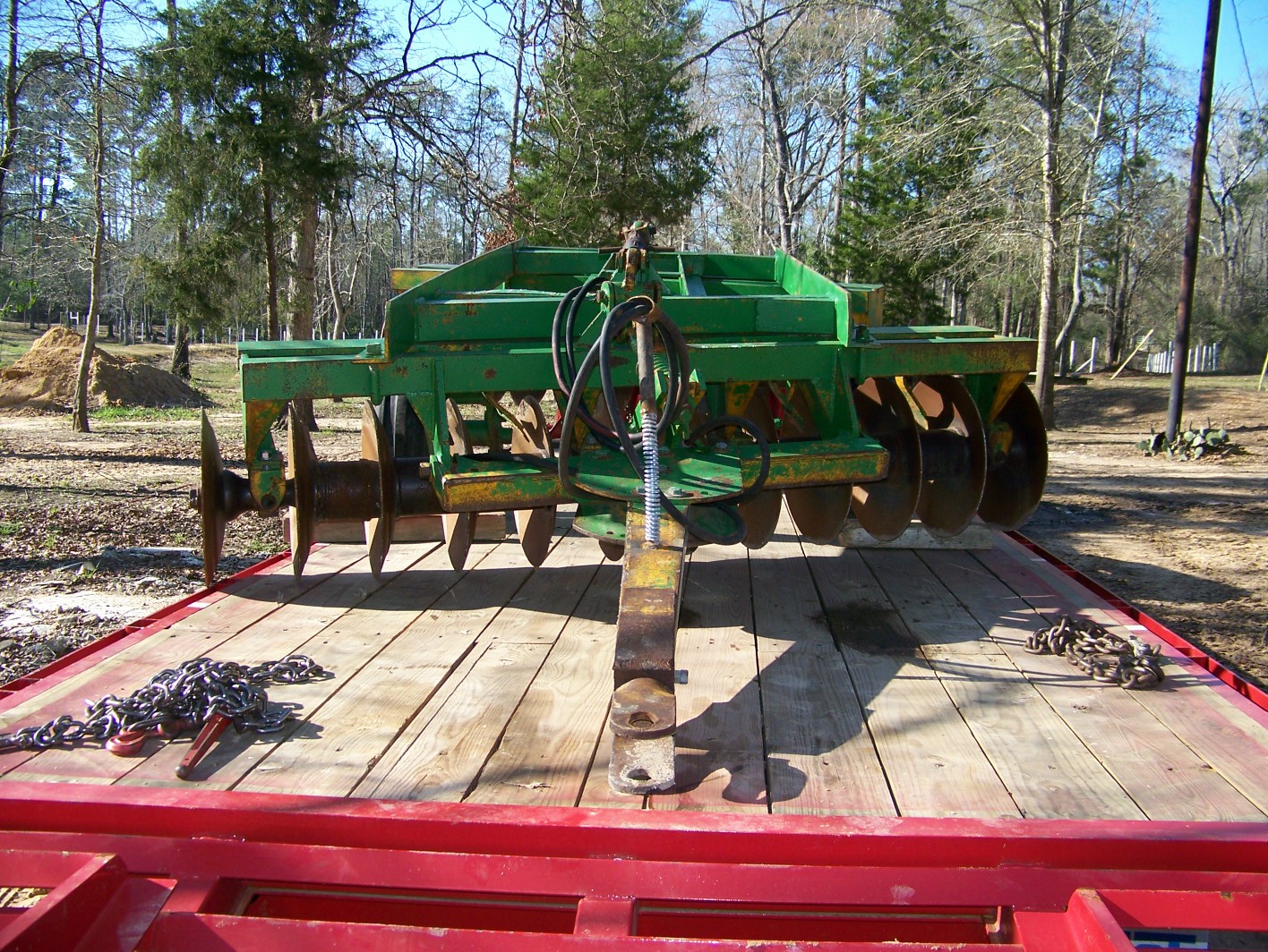

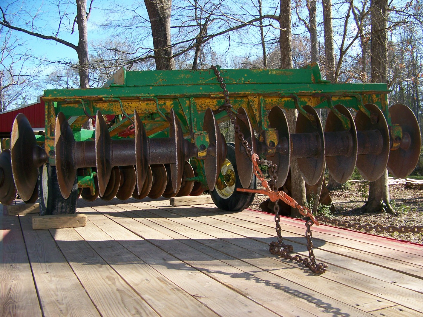

I am not sure what model Amco offset this disc is. I do know it was built in Yazoo City, Mississippi. I am thinking:confused3: it is a vintage F42 model Heavy Duty. It is 8 foot 6 inch wide with 24 discs that are 22 inches in diameter. The discs are on about a 9.5 inch spacing. It is suppose to have dual transport wheels, but only has 2 with tires and one axle assembly missing and one unused axle with no hub. So it needs one axle and two hubs with wheels. I gather this disc is around 4100 pounds. Best I can figure (in my online search) is that it is a F42 Heavy Duty disc. I need help in figuring out the exact model.:anyone:
I won this disc at Richie Brother's Auction in Houston last Wednesday. I bid more ($2500)than I wanted, but now am glad to have it.:cool2: Amco's webpage says a new F42 HD sales for right at $16,000.:eek: At least one existing wheel bearing needs replacing. Somebody painted it green, years ago over the yellow. It will be RED very soon.
The closest Amco dealer to me is 2 hours away in Giddings. I hope to stop by there next Friday or the next Friday. So any help will be appreciated.:) I am new at using an offset disc. I have only used 6 foot 3PH (spelled LITE WEIGHT) in the past. I need advice on how to adjust it on all the various gang settings it has and spring adjustment.:confused2:
It is in the barn now waiting to have the the hoses and cylinder purged today. Yesterday evening I got excited just staring at it's immense size and then got misty eyed;) thinking of Dad and how many hours he pulled a disc bigger than this one.;)

Nice disc. Looks like it's worth $2.5K.
Hope your 6520 can pull it.
My 5525 has trouble with my 6.5 ft Towner offset disc in soft soil. It's a pure drag type--no transport wheels like yours.

Nice looking disk and pretty heavy too. Had a 6 1/2' like that years ago and will say those spools between the blades add lots of weight. Sure would like to find another one like I had.

I stopped at a truck stop to refresh on the way home with it. I looked back at the disc on the trailer and wondered.............will my tractor fit on there with the disc. When we unloaded it yesterday, I purposely backed the tractor over the tongue until it touched the spring "pogo stick" that holds up the hydraulic lines to the cylinder. It just barely fit with the loader lowered after the ramps were stowed, just missing the front tractor tires. Whew...........I thought I was gonna need a longer trailer!

Not to be a pessimist, But your 6520 will not be able to make use of that disk to it's fullest capabilities. :( I think that you will be using the transport wheels for more than just transporting. I hope I'm wrong, but I don't think so.
Good luck ;)
   / Amco Offset Disc #8
While not familiar with this particular disc, I would say that the wheels need to be in contact with the ground at all times to control tillage depth. A good match between tractor size and disc size/type doesn't mean that the tractor can always handle the disc when cutting maximum depth. (down to the spools) The tillage depth needs to be controlled by the operator and most hydraulic lifts will include an adjustable depth stop for this purpose.
