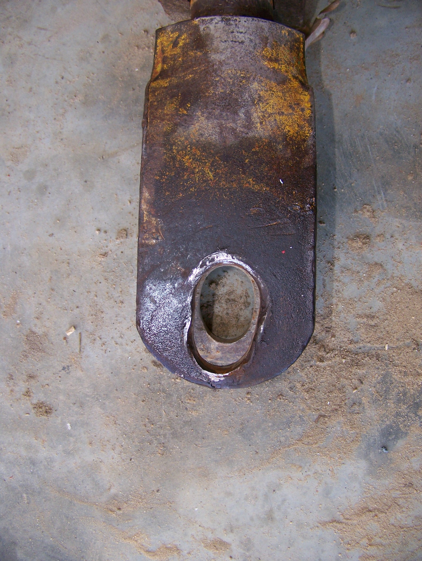

One last question before I go to bed. How would Y'all fix this hitch? Bare in mind it pivots on the tongue. The egg shaped hole is about 1/4 inch from the edge. Should I just weld plates above and below it? My drawbar pin is pretty long.

/ Amco Offset Disc #43
you are on the right path now...
i know of a welding and metal fabrication shop in temple...awesome what they can do in little time at very reasonable prices. if it were mine, down here, i'd take it to them and say "fix it".
i'd look for such a shop in your area...not just a welder, but a place with hydraulic punches, shears, drills, etc.
best wishes...when all fixed up, it will be like new and be problem free for years!

If I were fixing it for long term use, I would do the double whammy to it. I would weld up those slotted holes and then scab on another plate on top and bottom to have at least double the plate thickness that is there now. Then it should hold for a life time (disc lifetime that is).
As for the right or left turn, I knew it was only good to turn one direction, but it having been over 50 years since I have seen an offset disc, I just didn't remember which way I used to go. The CRS syndrome is catching up fast.

After the rains today, I removed the hitch from the tongue. As you can see, it is dire need for some TLC. The tongue end "box" section is drooping.3-10-13 Disc Hitch.jpg
The lower forward weld looks sick and needs attention.3-10-13 Disc Hitch Tongue Box Right View.jpg3-10-13 Disc Hitch Tongue Box Left View.jpg
The hitch hole is elongated. I think the welding shop will not want to repair this, just make a new one. 3-10-13 Disc Hitch Overhead View.jpg

I think I would weld up the hole and run a reamer through it if it were me. Quick fix.

I picked up the Tongue and Hitch on Friday. I had the holes repaired in the Hitch and the bottom end of the tongue beefed up. Then I got it painted on Saturday.
