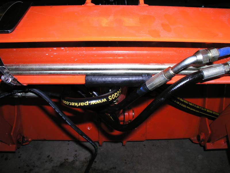

   / American Soulutions Grapple BX23 install
#12

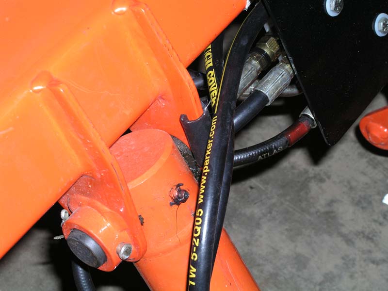

I put some 3/8 fuel line split down one side at the points where the lines would rest on edges
#13

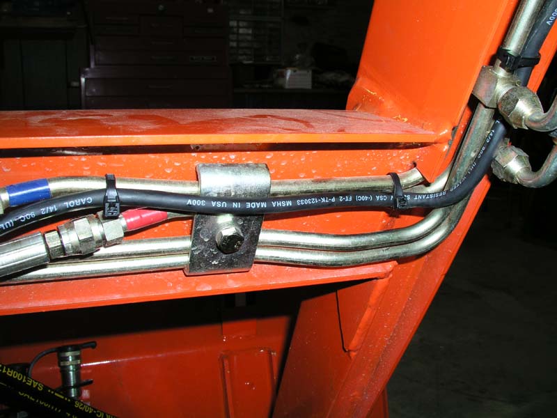

And here
Jeff has since told me that he intended for the lines to go under the cylinder and (oops forgot the part about the double hose clamp bracket attached to the cylinder) the double hose clamp bracket to be placed at the rod end edge of the cylinder.

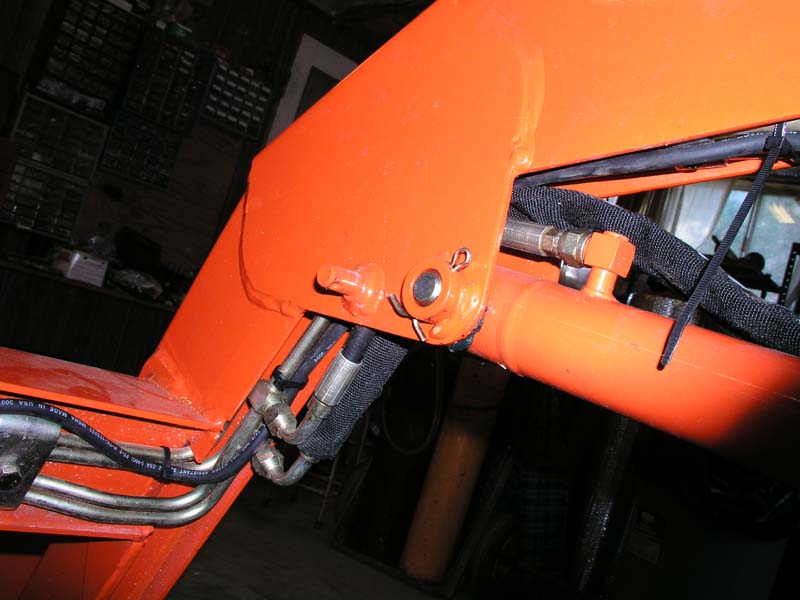

Next I ran the wire along the hydraulic lines back to the quick disconnect and fastened it with zip ties.

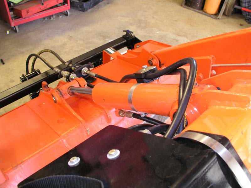

more wire

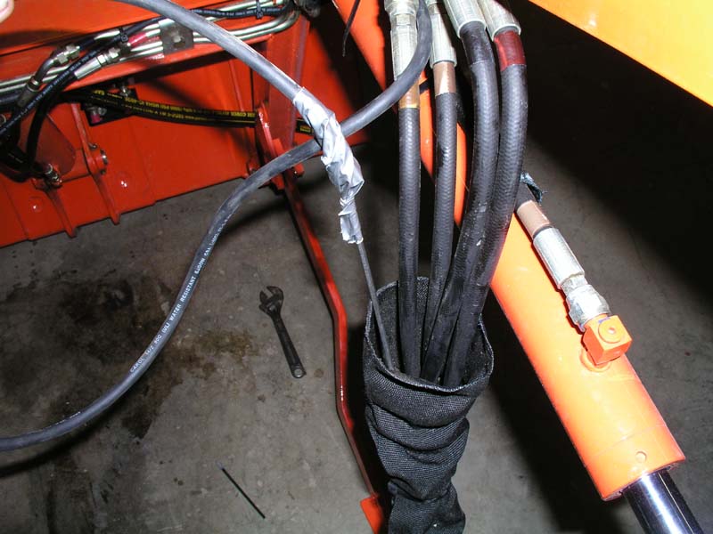

I didn't want to cut the zip tie holding the woven cover on the hydraulic lines so I taped the wire to a piece of rod and pulled it through

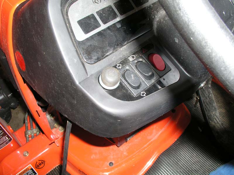

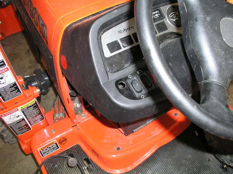

#17
Next I drilled a hole for the switch. (eek. I know but it does work well and doesn't look too bad with the switch installed)
#18
Here is the switch.
#19
Here is the switch in place.
#20

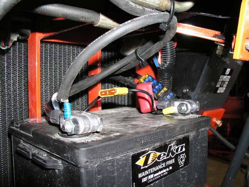

I hooked it to the battery with terminals and an inline fuse and secured the wires out of the way.
