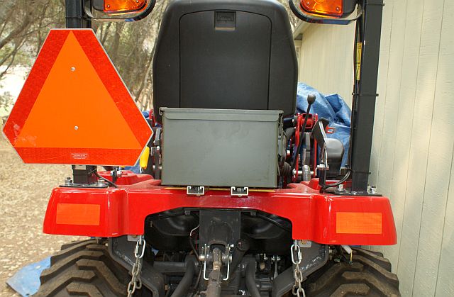

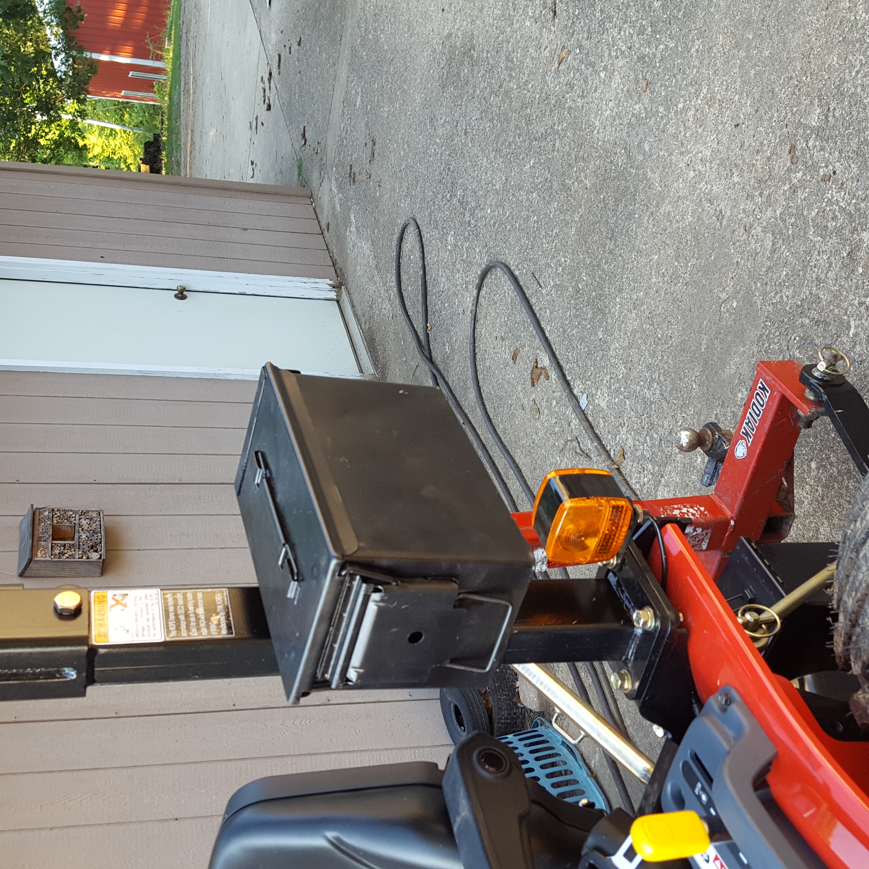

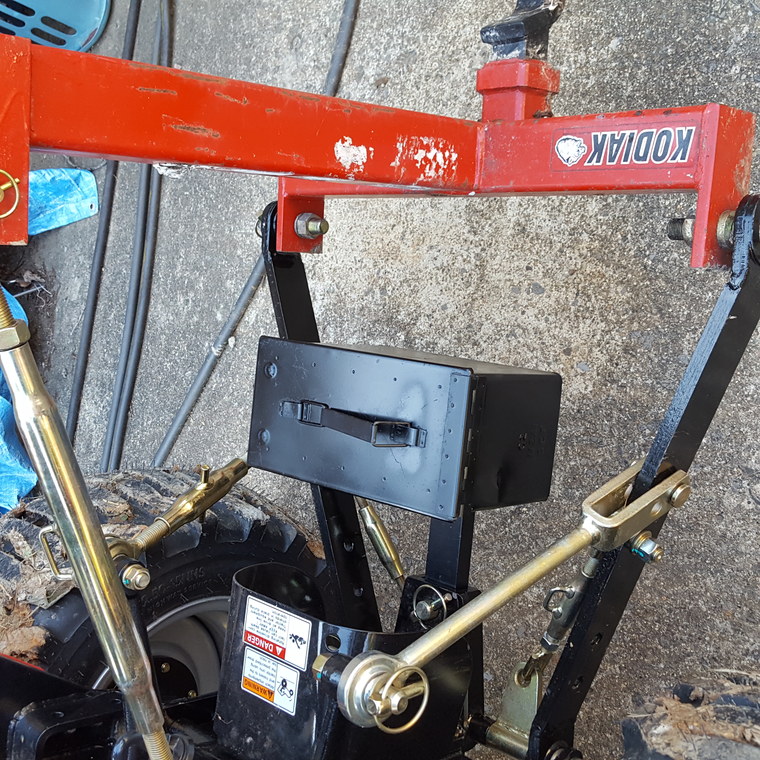

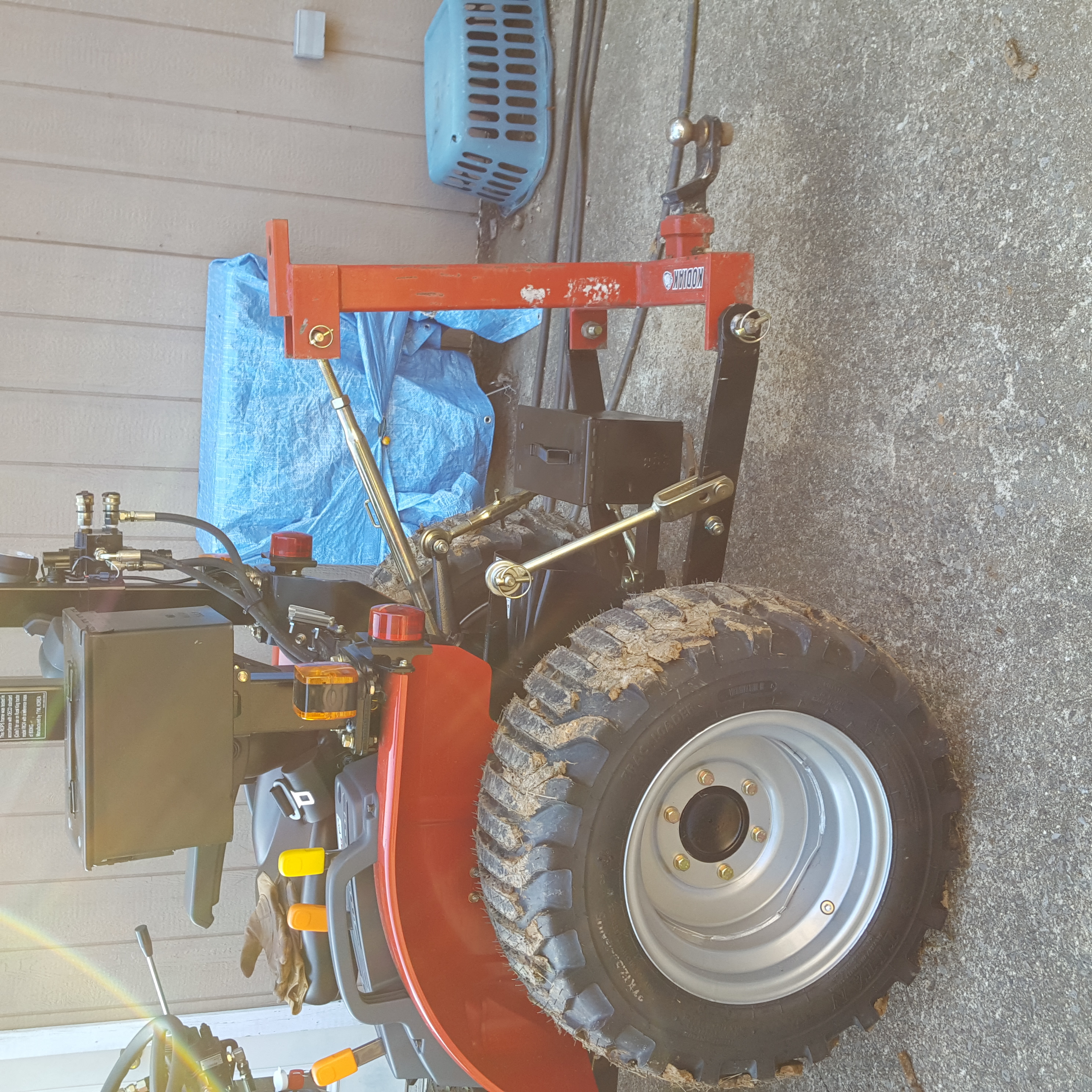

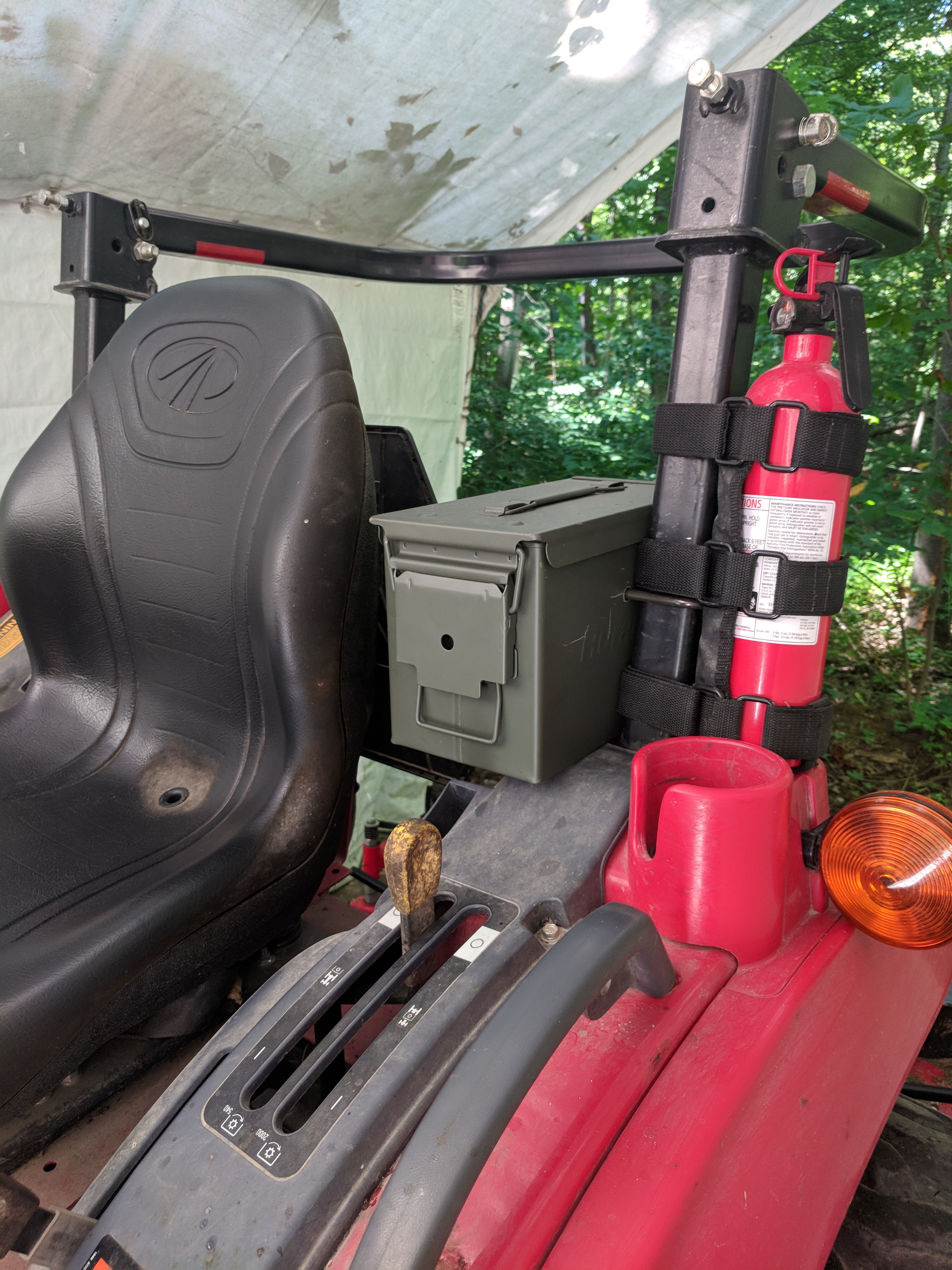

I needed a bigger toolbox and some way to carry chains on my RK24 so I added these two ammo boxes.

Like to see a pic on how box was mounted to ROP...
Have a box, just not sure where I want to mount it.... Some put them on FEL subframe...
dale
   / Ammo box additions

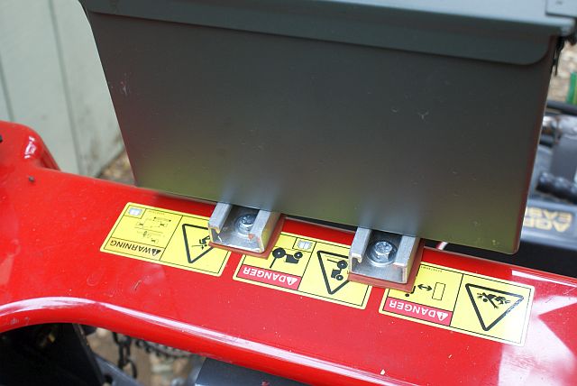

Put mine on the ROPS in the same place as the original one using the same hardware. For the chain box I bolted it in the hole where the trailer ball goes.

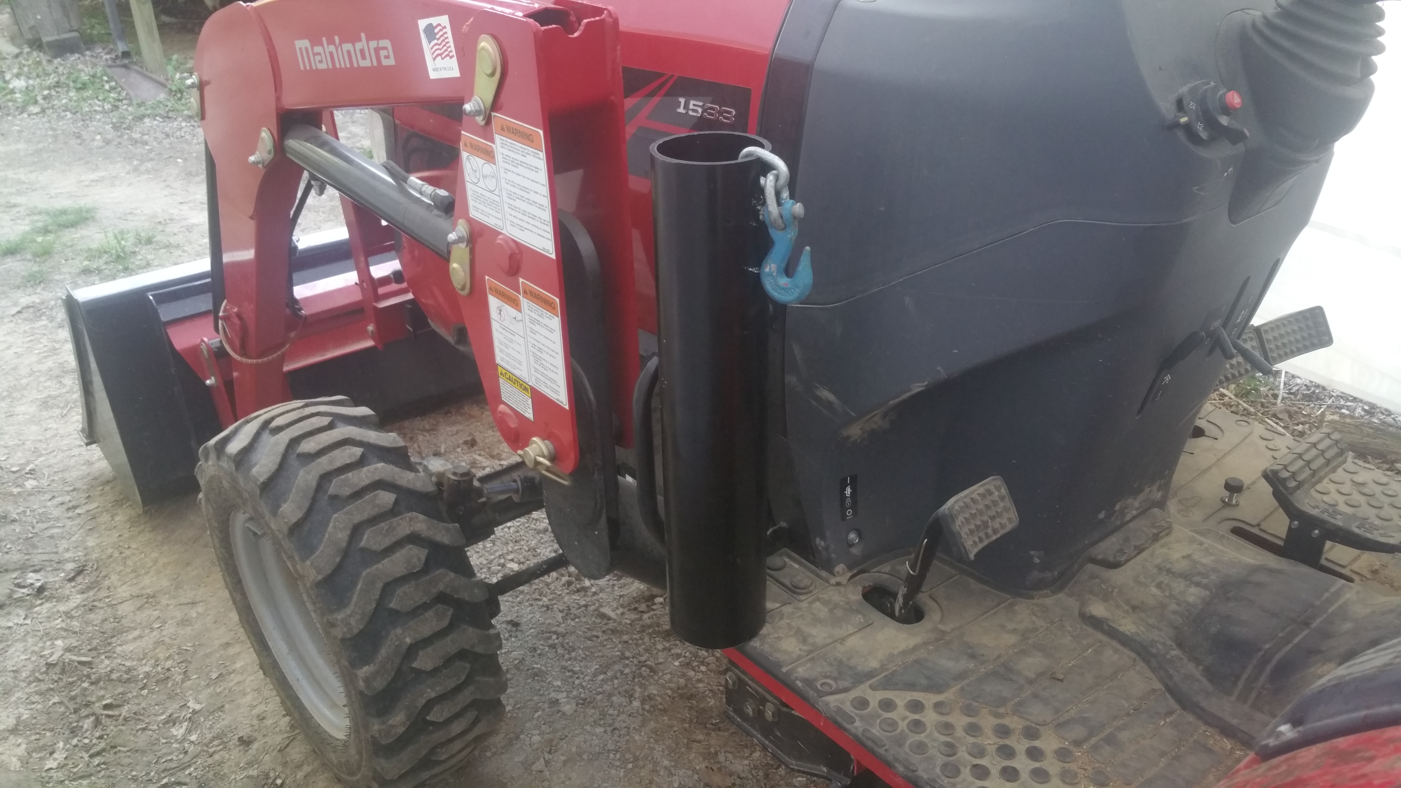

I keep my chains in a PCV pipe I mounted. The 50 cal ammo box I use for tools. I mounted mine on the inside of the ROPS. Chain holder.jpgIMG_20180708_160649.jpg

I added ammo box behind seat connected to ROPS...angle iron between ROPS post fasten ammo box.
