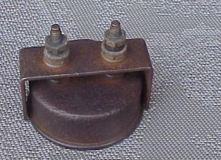

This old tractor amp gauge looks old enough to be 6 volt and it isn't marked. Are amp gauges volt specific? If it came from a 6 V system would it destroy it to test it with a 12 V system?

It will work the same on 6 or 12 volts. Amps is amps

It will certainly work on either, but voltmeters, which have several advantages over ammeters have been more highly recommended for decades.
No high amperage wires run through the dashboard with a voltmeter, and best of all, a voltmeter actually shows you the current status of your battery rather than just showing whether it is charging or discharging at the current moment.
A voltmeter can be used for troubleshooting far more effectively than an ammeter.

Okay, I agree about the volt meter but, I'm thinking a person can kinda tell if all the glo plugs are working with the amp meter. bjr
   / Amp Gauge Question #6
I think both would be ideal. It is nice to see how much charge your battery is drawing to get an idea if it is low in charge.
