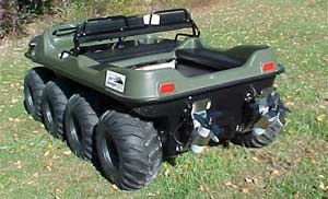

I have a MAX 4 that I picked up last summer for $300 .I need to rework the engine and some other Items. But my point is you can find them cheap if you look hard.You can also get kits that mount 2 trolling motors on the back for better water use.8wheel copy.jpg
