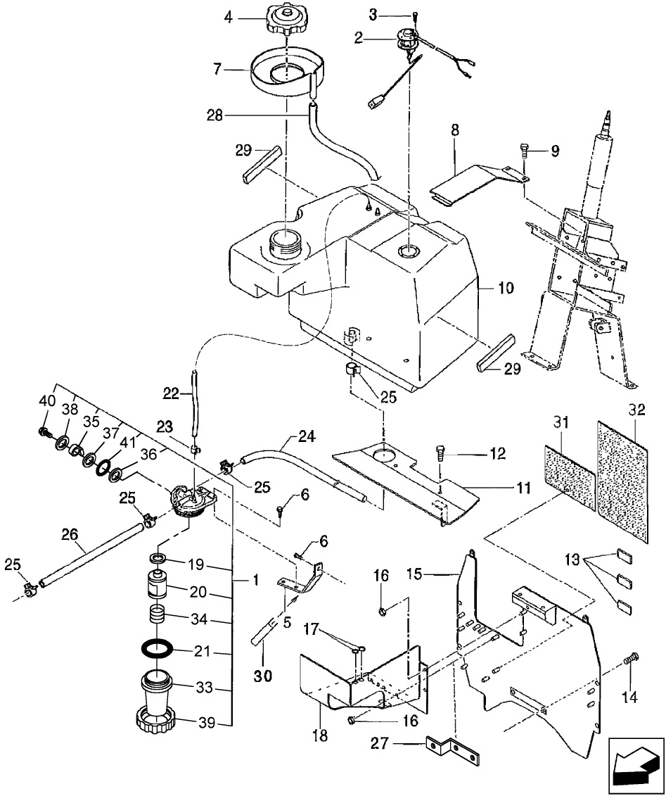

Thanks for the advice everyone. I'm going to take the "wait and see approach" at this time.
The tank was slightly less than a quarter full when the nozzle fell in, and I couldn't see it with a flashlight at that point. It seems that the tank has a shelf, for lack of a better term, about 4 inches down from the opening that inhibits you from fully seeing the rest of the tank.
Seth
   / An odd/stupid thing happened tonight... #12
You'll never have a problem with clogging from this spout, but you might have interference with the fuel gage float. Even then, the chance of it getting stuck on the float with fuel sloshing around is minimum in my opinion.
What some folks may not realize is that the 2420 has a fuel tank with the cap on the far left side in an extension of the tank (see attachment). Even with the tank almost empty, therre is very little chance of seeing the spout. However, if you remove the fuel gage float on the right side of the tank, you might be able to see it. I think I'd ignore it until it becomes a problem. At most, it might interfere with the float, but that would occur only if the spout floats and only until fuel sloshed and moved it away from the float.
