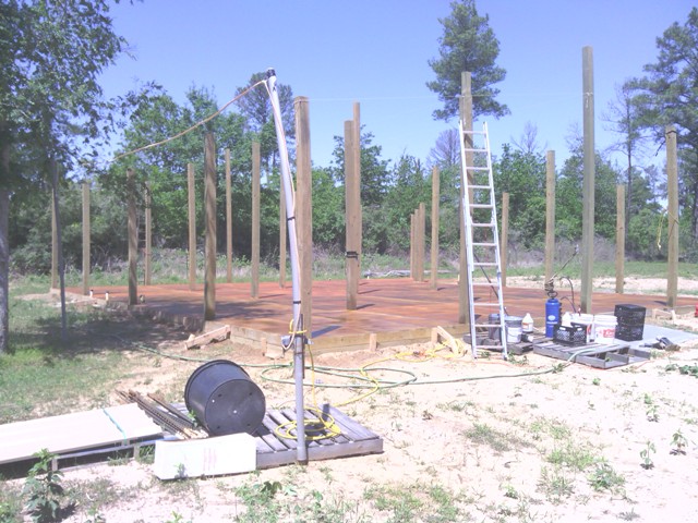

#467
More Adventures in Homebuilding -
...so I sez to Precious Bride, I sez....
"...Hunnybun...by the time I'm done with that concrete, you'll be able to do your housework with a firehose, a yard blower and a roll of duct-tape..."
$800 worth of dangerous chemistry, three days of scrubbing and schrpritzing and rinsing and repeating later my hands are rough enough to put a run in panty hose just by waving at em across the rooom and I have made a plain concrete floor look like...dirt...
Tho Precious Bride is extatic, I fear my ancestors are going to visit me in my dreams and smack me... So BE it....when PB is happy...my world spins in greased grooves...
NOW...it's about time to start hanging some rafters....the "Raising" part of the barn raising...
Be Careful Out There!

Hard to see for sure what you did. Is the concrete dyed or did you stain it after it dried?
Nice to see the posts in the ground!!!!

Eddie...I looked at his picture and then thought he was just kidding us after rereading his post...I don't think he has put any concrete down yet...that's why he said he worked so hard to make it look like dirt...If I'm right...it is dirt LOL
Bob
