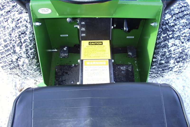

My current little machine has a treadle, but its a two-foot treadle. Right foot forward, left foot reverse. It pivots between the feet left and right. The right forward foot pedal arm is longer to require less foot pressure, since you’re more likely to be going forward. The shorter left reverse pedal makes for foot room on the left side so your left foot doesn’t have to ride the pedal all the time. I really, really like this setup as well. It makes precision positioning with two feet really easy.
   / An understanding on the age old debate of geared/hydro #3
Oh, and it has NO brakes and its articulated. FEL only. No attachments on the rear. All attachments out front.
