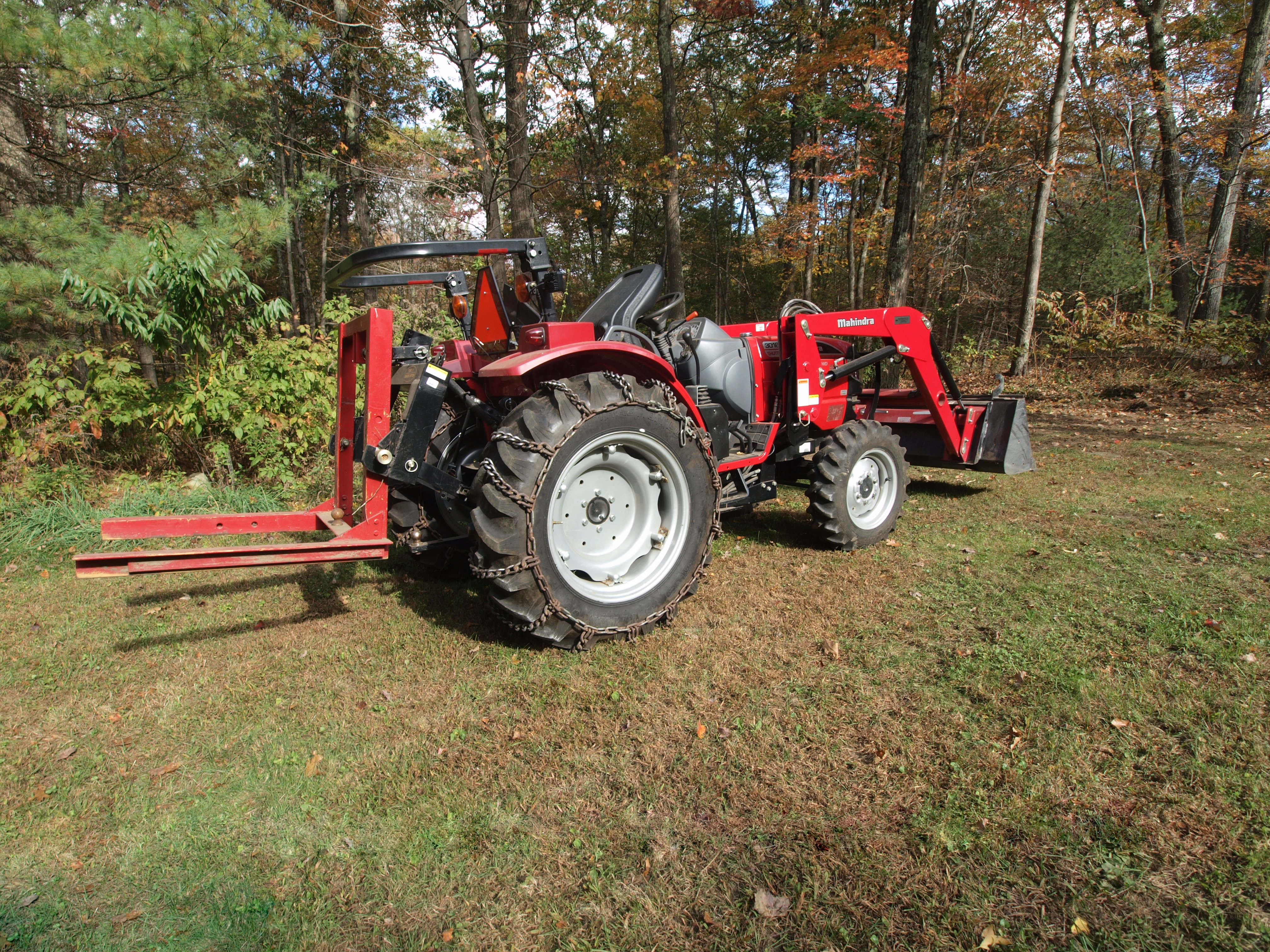

I'm willing to bet they aren't and no, the one I drove did not have a poor drivetrain. It simply did not conform as to how I like using a tractor. Old Path has an hst 3016 (now called a 1526) and loves his. I hated the one I tried out for how I use a machine. Too slow in lower ranges and high rpms all the time. By itself, it would not go up a 30* incline in high range let alone with a hitch of stems attached. The geared 1526 is a different beast and easily goes up these same inclines in 3rd or 4th and is not screaming to do so.
I could be wrong but I think I would have been more satisfied with simply a heavier, more horse power unit if going hst. My woods are very dense so maneuverability matters to me. That age old maxim about never having a tractor too big was for me, a possibility for how I use one. This one pulls beyond what it looks like.

Did you mean a 30% incline, as that is very steep. I imagine you would need 3rd or 4th Low range 4WD to pull the load with anything on the hitch. HST would need low range. I'd be happy to pull 10%-12% grade with a HST in high range. Many will not do that.
