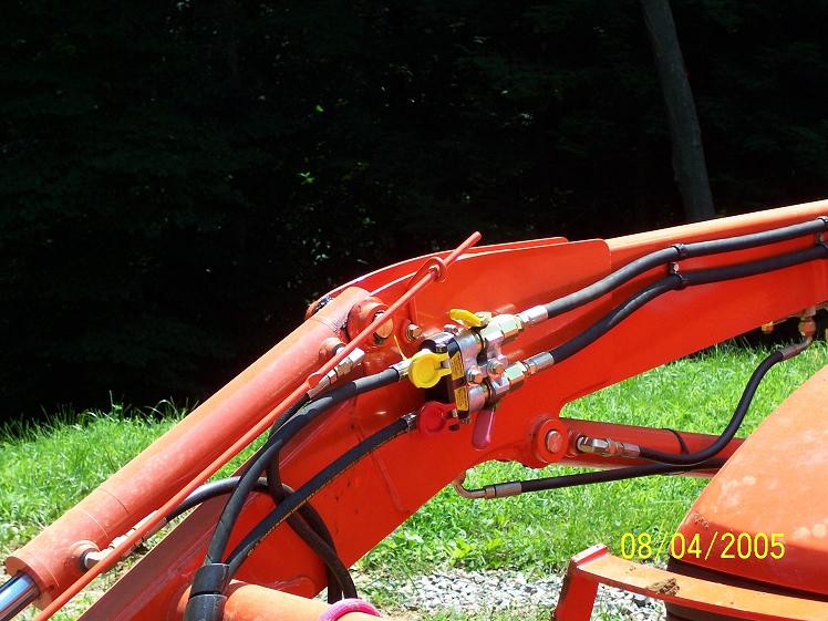

picture #2
Tisco coupler set up

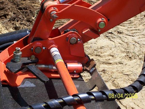

picture #3
photo of 3/8" angle welded to grapple plate to better secure the mounting pins.

Thanks for the info Walt, I should get mine next week and I'll scope out if I have to weld in some metal like you to reinforce the QA pin attach, I talked to them about this and they did say no. Also, they said my 1/2" front remote hydraulic disconnects would fit right on.

-What is athe source for the spiral conduit like protector I see in the photo on the hydraulic hose?

Looks great, Walt. I am going to weld tabs or angle iron on my Pirannha Grapple and Stump Bucket quick tach as it is loose on both. I just got them recently and will do a post on them soon.

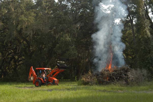

Walt, my L-39 Q/A pins went right in, no need for any welding. It indeed is a truly fantastic setup and very happy with it. Thanks a million.
