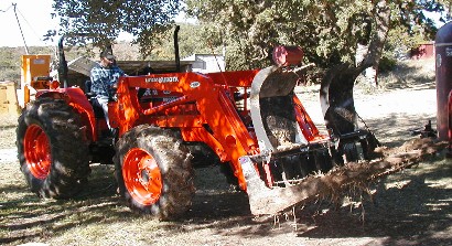

Well, the Borgford grapple fnally showed at my dealer, more info to follow:
Now to get it set up and valved!
The Borgford is smaller opening grapple of the several I compared, but the short front tines and smaller jaws will give me more leverage and curling force with roots and rocks. The tines are thicker but shorter and more narrow in section from a side view.
Despite the smaller jaw opening, I think the new shark tooth shape of the Borgford top jaw and slightly lighter weight would be better on my tractor. Borford Web page does not show new style shark tooth.
I want full loader function and grapple function, where the grapple can be activated with the press of the buttons located on the loader stick. This allows seamless operation of a the grapple.
A directional valve can be set up for continuous flow between the pump and the tank and handle much higher flows with less pressure drop, i.e.. less heat. This type of valve is what's typically used in the power beyond scenario. When the valve is activated the continuous flow is directed to the port that is open or closes the grapple.
Kubota makes an option Loader control for the L-39 with buttons.

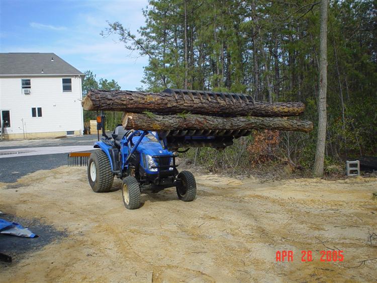

Oh Boy, I love my Anbo grapple! /forums/images/graemlins/grin.gif
I have the 5' GRL model with the smaller hyd cylinders and it matches very well with my TC33DA. It weighs under 400lbs which is I think is around 1/4 - 1/3 of the FEL's capacity.
It is very well made and has performed perfectly. Sometimes I wish I could have gone bigger to carry larger piles but I didn't want to lose too much lifting ability. I bought it from the dealer when my tractor was new so I paid top dollar, I think it was around $3k but was ready for duty from day one. Obviously, you'll also need to have a skid steer style quick attach plate. (I think these should be included with all tractors).
Initially, it was a major PIA to connect/disconnect the hyd lines due to residual pressure but thanks to some of the TBN guys, I learned the very simple but important rule to relieve all hyd pressure in the lines by "cycling" the FEL and 3pt. before removing them. Now it takes just a few minutes to hook-up and remove the grapple and other hyd attachments. (thanks guys!).
Recently, I was using the grapple to "rake" thorny vines out of a bunch of trees and then I'd simply clamp down on the root clump and rip 'em out. Oh man that was so satisfying, after years of getting pricked to be able to rip out and carry away huge piles of those nasty thorns.
The attached pic was a simple job for "big Blu" and the grapple...Fell 2 large Pines, cut them in half and make 2 trips with the top halves cause they're so bushy and double up and make just one trip with the trunks. Time was less then 10 min.
