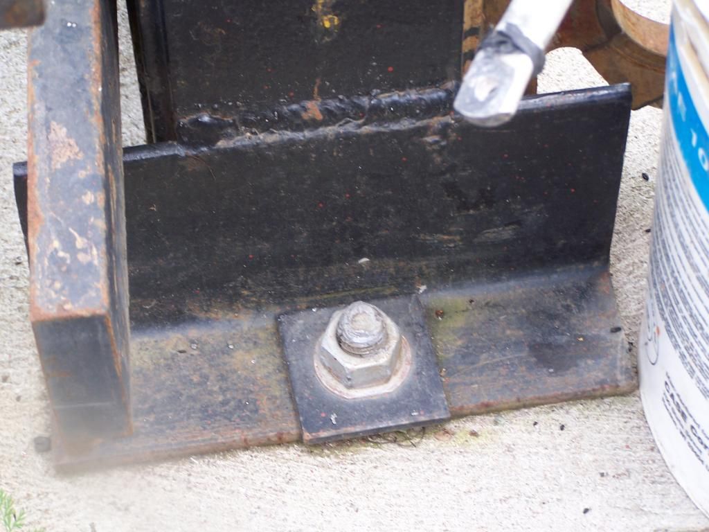

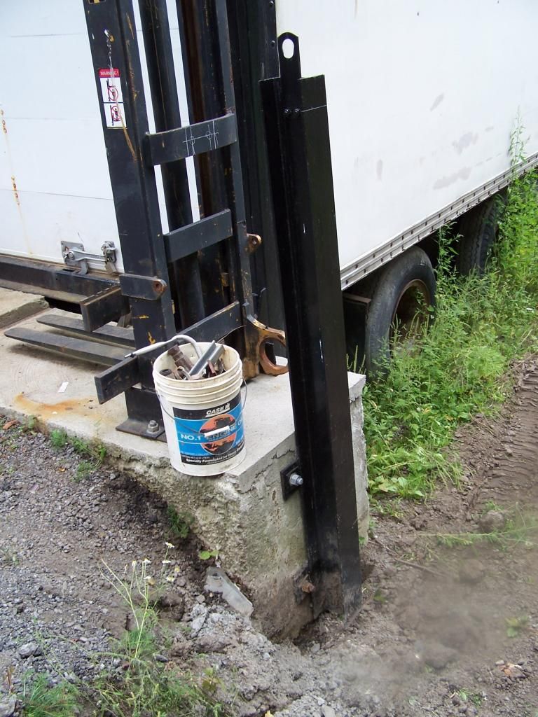

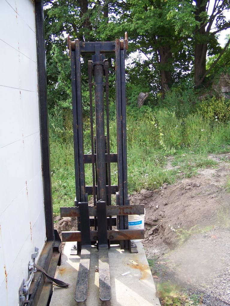

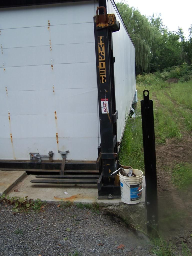

Here is a photo of the mast from the front.
I welded angle iron to either side of it and then used expanding anchors to bolt it into the concrete. Those nuts are 1 1/2" in size and I used my four foot torque wrench to tighten them.
Currently, it is standing just fine on its own BUT.....to give it some additional support, I welded some 1/2" thick x 6 inch wide flat bar to a length of wide-flange I-beam and then used the same type of anchor bolts to secure that upright to the solid concrete block that the mast sits on. These blocks a 3 ft by 3 ft by 6 ft long and make up my "loading dock" retaining wall for the trailers.
I am going to run two lengths of 1/2" threaded rod between the I-beam flange and the heavy cross support on the rear of the mast. The threaded rod will have nuts on either side of where it is bolted to those two items so that it is "passive" and they do not have any tension on them unless the forklift is in use.
The height of the mast between the concrete block and the top of the channel is 91 inches. The width of the mast assembly is 22 1/4 inches.
The width of the fork carriage is 36 inches and it uses 42 inch forks that are 4 inches wide by 1 5/8 inches thick in the vertical section.
The highest the forklift must rise is 9 feet to reach the top of the trailer roof.

With the rear supports, I think you will be fine with what you want to lift.
IF you already have a 0.61 cu in pump and 1.5hp motor, I'd say try it. But put a amp clamp on the motor leads and watch the amp draw and make sure you dont exceed the nameplate amps x S.F.
If you dont already have a pump, I'd downsize a notch to be safe.
And BTW, that is a single stage mast.
