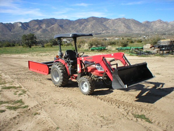

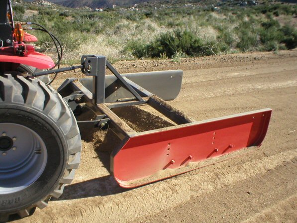

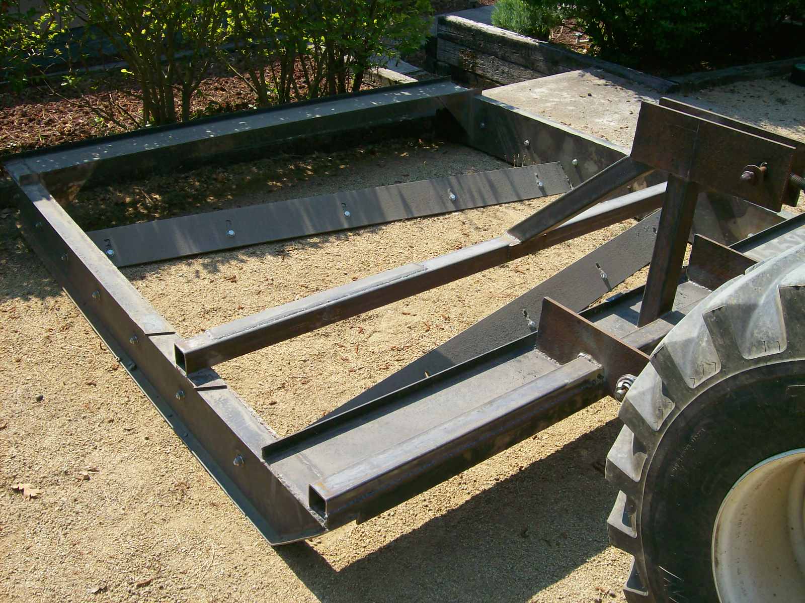

Fred, how heavy is your TC30? My guess is that you are not going to be able to handle the size and weight of the unit that you want to build.
I have a Mahindra 3215 HST. Weighs in right close to 5,000lbs, I have a land plane grader blade that is 5 foot wide and 6 foot long, weighs about 800lbs. I would not want to go much wider and for sure not wider than 6 foot.
Now this is just me with my conditions, but I just thought that I would throw the info out there for you to consider.

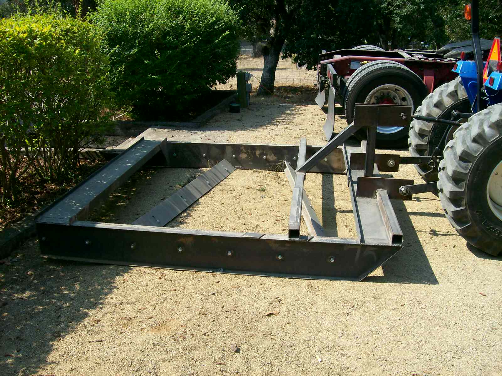

This is what it ended up coming out as , (No color added yet ) . Blades are set at 3/4" now but may move back up to only a 1/2" . One pass down each side of driveway was all I needed . Better Half and Neighbors love it .

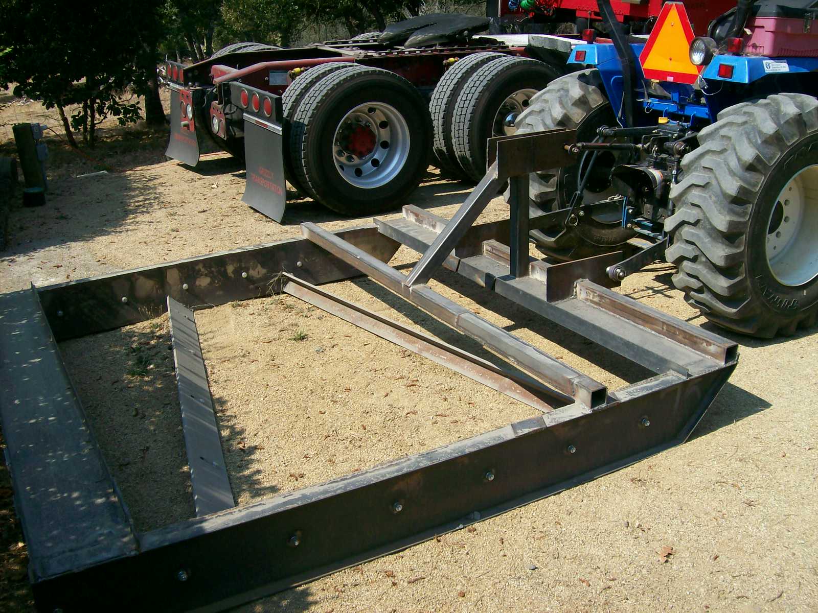

P.S. As a side note , I ended up settling on 10 Degree angle and a 45 degree pitch of the blades . I did though forget one thing , Bought the steel but forgot
to weld it on . Two 1/2" x 3" x 8' skid shoes . Wife went to use the newer Dodge and wanted to know what the steel was in back . Duh !! Good thing I
wear a belt , Wonder how many times I would of forgot my pants by now !!

You did notice the link to my build, didn't you? Too many pictures, but what the heck. I think your questions on angles were included in there. Mine is a little heavier duty than yours... or at least heavier, lol.
