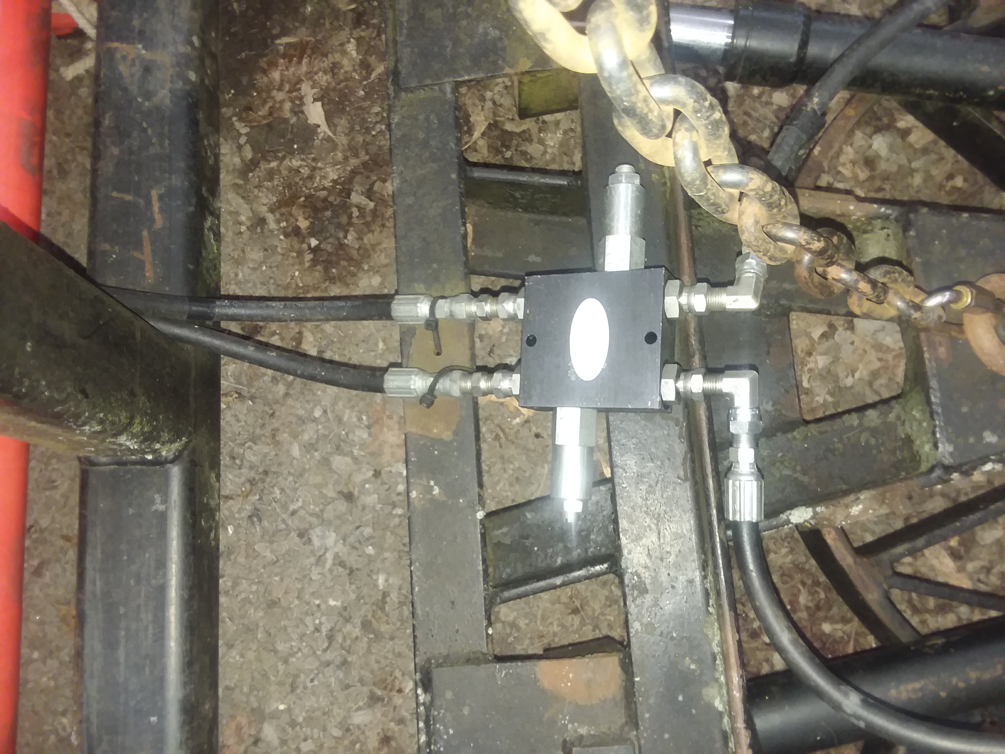

I own a Kubota L5740 with a third function valve. I have a snow plow frame that i want to add angle cylinders to. I'm not sure how to pipe the cylinders to the third function valve. could some one help with a diagram from both angle cylinders to the third function on the tractor. Thank you
   / angle plow #2
You'll need a crossover valve, 2 single action cylinders, 4 hoses and your QD fittings to match the third function.
1 line from the 3rd function to "A" on the crossover, the other to the "B" port.
"C" and "D" come out of the crossover and go the the cylinders.
If you got something the crossover dumps pressure to the opposite side and keeps from blowing or breaking something.
   / angle plow #3

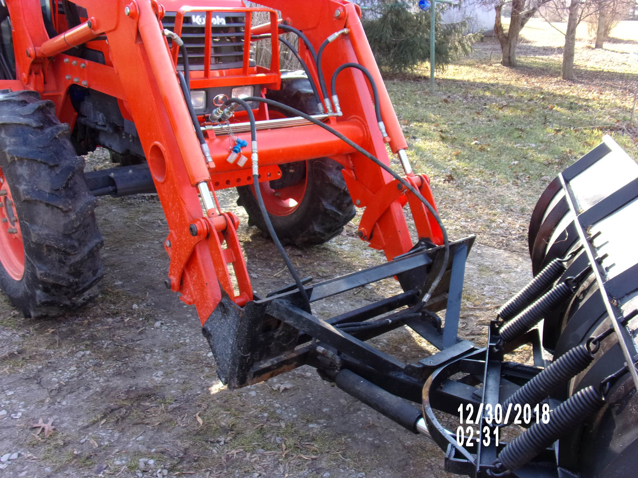

Don't need a cross over but highly recommended.I have one on mine after a couple years with-out.As stated pretty simple one line to each cylinder from the tractor;when you get a cross over;just a simple in and out with short hoses.
Will try to up load a picture. Check Surplus Center for a cross-over.

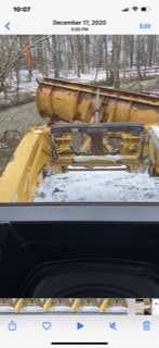

None of the above for me and for the last 3 years has worked just fine. It's a 10 foot retired county plow.
