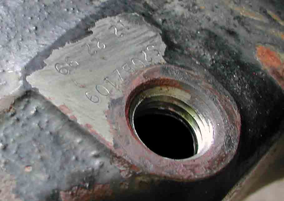

btw, where do you find the spec number of the axle as listed in jdparts? i read somewhere that it was near the fill plug, but i don't see anything except 'spicer'.

   / Another 4400 front axle leaking! #26
Right here (photo).
On my axle, I could see the date, but not the part #. I had to remove
the paint. This old unit has no manufacturer stamp, but it seems to share
molds with Spicer-marked units on later 4x00s, 4x10s, and 3x20s.
