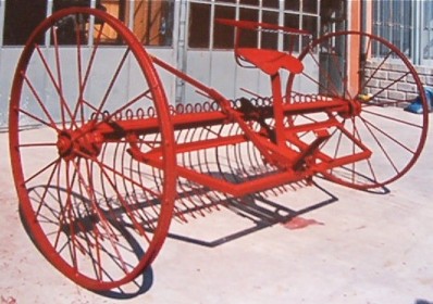

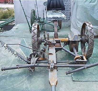

Lee, I understand your goal is to have the hay by spending the less.
OK, here are two perfect machines (mower and rake) I plan to stop using soon. They are second hands, but, newer than the news. These will do the work. All you need is HORSE POWER.
   / Another ? about hay equipment #18
Great pics Nomad! The mower and rake I have like that don't look near that nice. Of course they have been sitting in the bushes for at least 60 years. Used to hear some great stories about a certain mule and that sulky rake.
