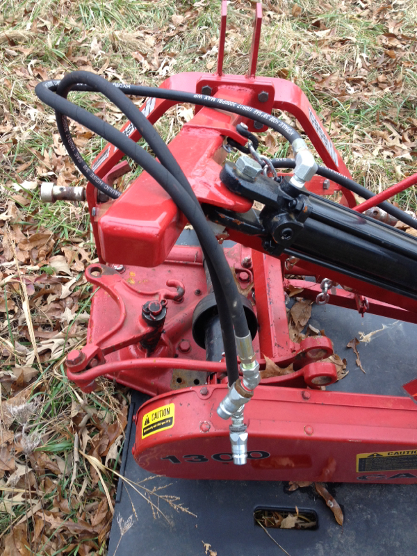

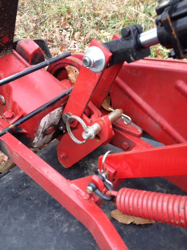

I will be glad to, but it will be a few days before I can get anymore pics, I'm out of town for the week. I did find one more photo on my phone from the other angle.
   / Another adding hydraulic lift to sickle mower. #12
What cylinder did you use and does it have float?
#13
#14

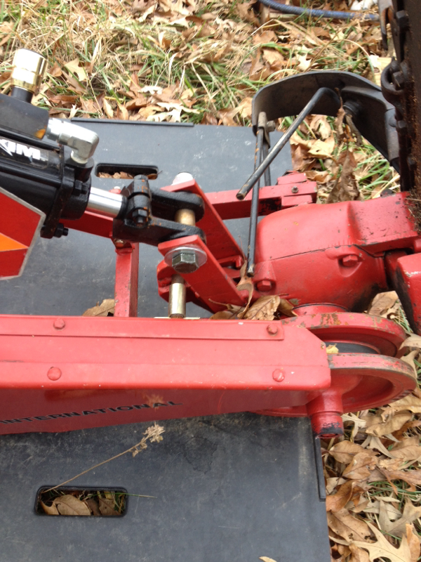

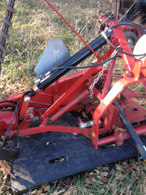

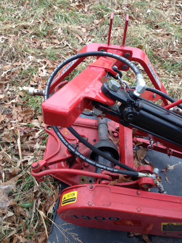

A few pics
#15

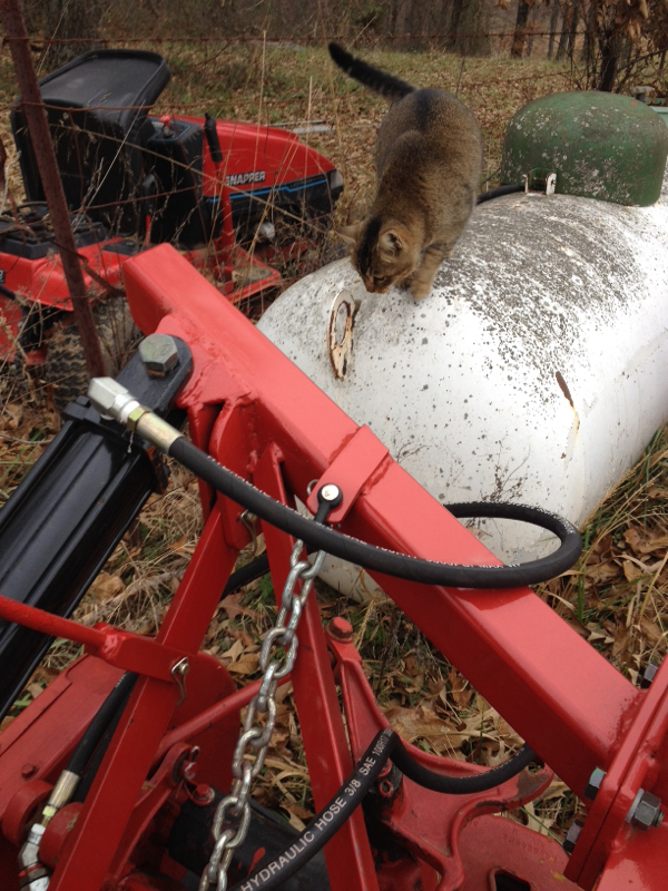

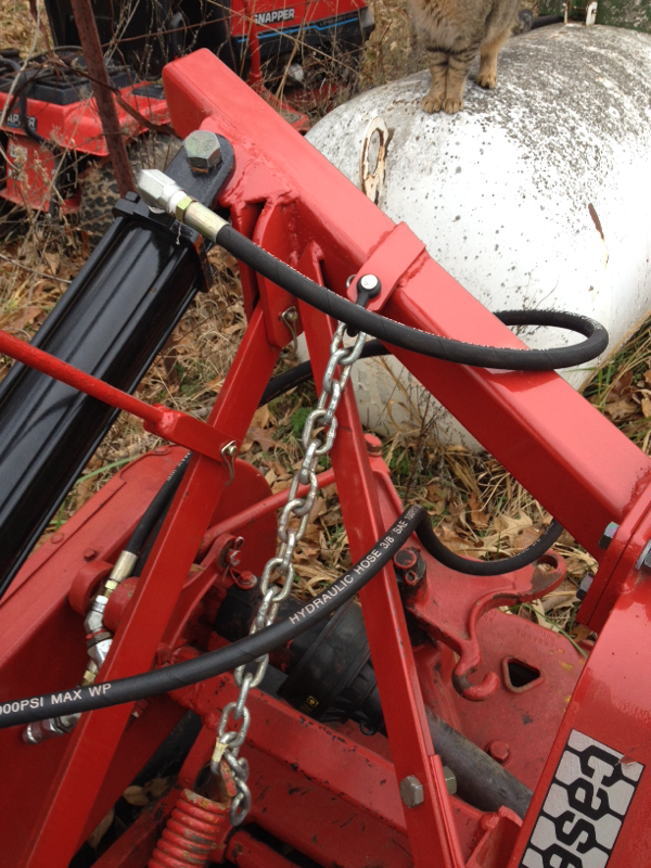

A few more.
#16
Last two.
   / Another adding hydraulic lift to sickle mower. #17
Nice Grizzly cat!:)
   / Another adding hydraulic lift to sickle mower. #18
Yes very. I have a New Holland 451 I'd like to do that to.
   / Another adding hydraulic lift to sickle mower. #19
Country, thanks for the effort to send more photos. I know many will benefit from your work.
Best,
Neil
#20
If I can help with anymore info just holler.
