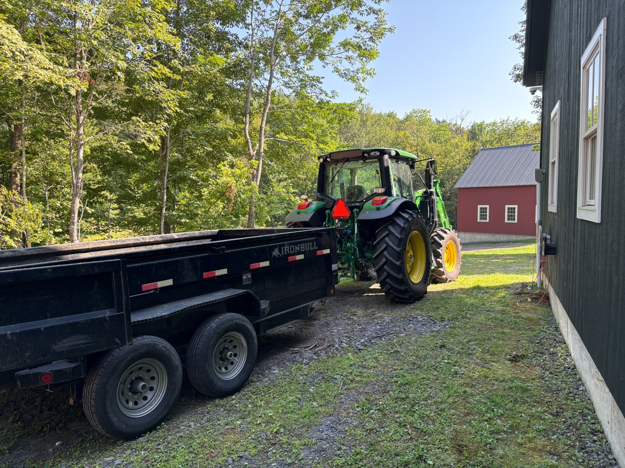

Today I pulled out about 8-10 yds more material. I removed two dump trailer loads, plus 4-5 large rocks. I'm definitely making progress, but it's slow.
The dump trailer is probably worth a few words... It's a 14' Iron Bull with a GVW of 14,000 lbs. Struck capacity is 7 yds, but I'm only filling it to about 1/2 capacity. So two loads is 6-7 yds. The trailer could hold a bit more, but it's a serious overload for my tractor. My tongue weight limit is 1600 lbs. and I'm definitely over that. So much so that I've bent the draw bar a couple of times, and periodically turn it over to bend it back. This is one of the smaller examples of why I bought a much bigger tractor. I really don't want to break the kubota, but worry about it every time I move around such a heavy load.

The new (to me) tractor is a much better match for the dump trailer, and no longer feels like it's going to break at any moment.
