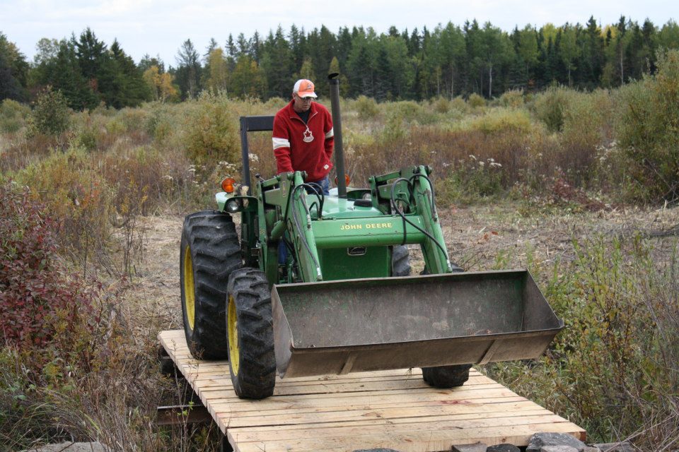

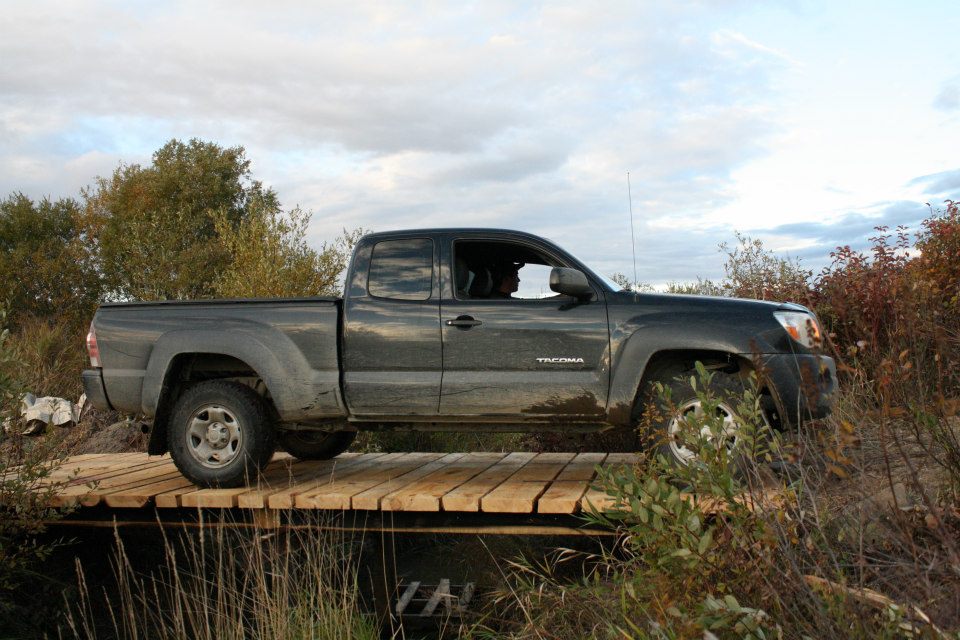

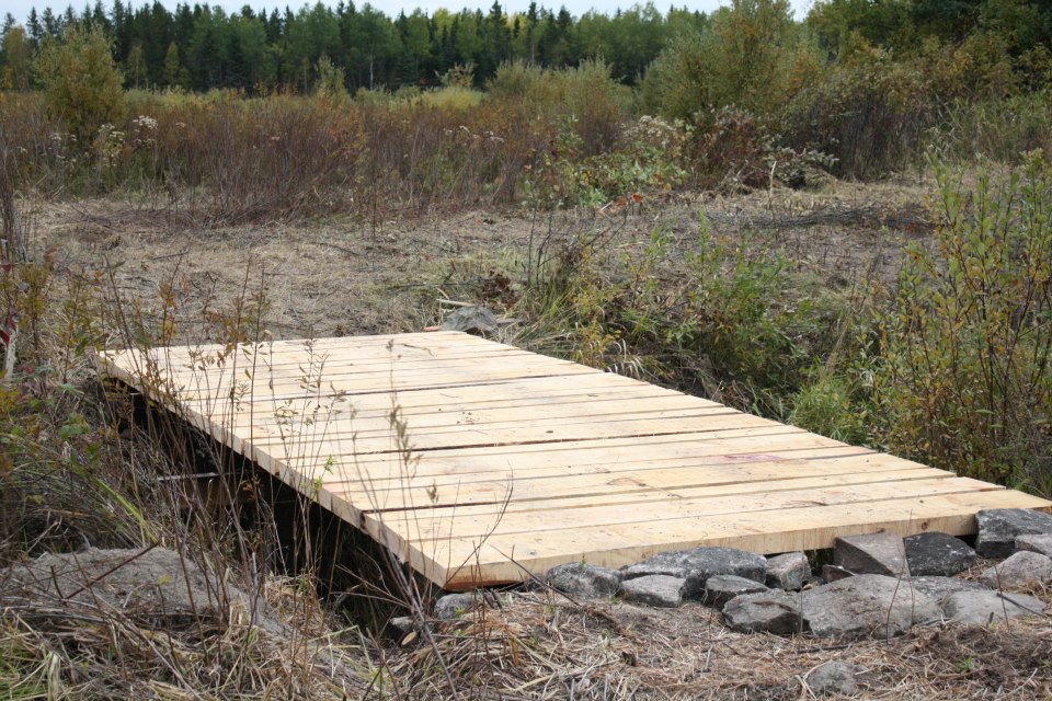

This is mine.... 20' X 8'......3 beams across creek- 8" X 8"X 20 ft (white spruce covered with tar paper to prevent moisture build-up and rot)).... supported by railway ties recessed into the creek-bank at each end.....3" decking ( white pine and jack pine treated with sealer)...underneath vertical support in the middle resting on bedrock on the creek-bed ( pressure-treated 8" X 8")...no problem supporting tractors and other vehicles...in the springtime the vertical support-beams sometimes wash away but we cross anyway....some deflection however not enough to worry about until they are replaced. Still going strong after 3 years.

In reply to your question, yes I laid a long strip of tar paper maybe 14" wide, the length of the beam then folded it over along the sides then nailed it along those sides with roofing nails...you can kinda see it in the picture with the truck crossing.....then the decking was attached to the beams with 6" galvanized lag screws. I drilled a couple of 3/8" holes clear through the end of each beam then drove 12" spikes right through those holes to attach them to the ties. I milled the beams and decking myself with an Alaskan Sawmill so I could chose my own dimensions....I had the wood for free so I chose 3" thick to make sure there was little to no deflection when driving over it. Hope this helps...Twister
