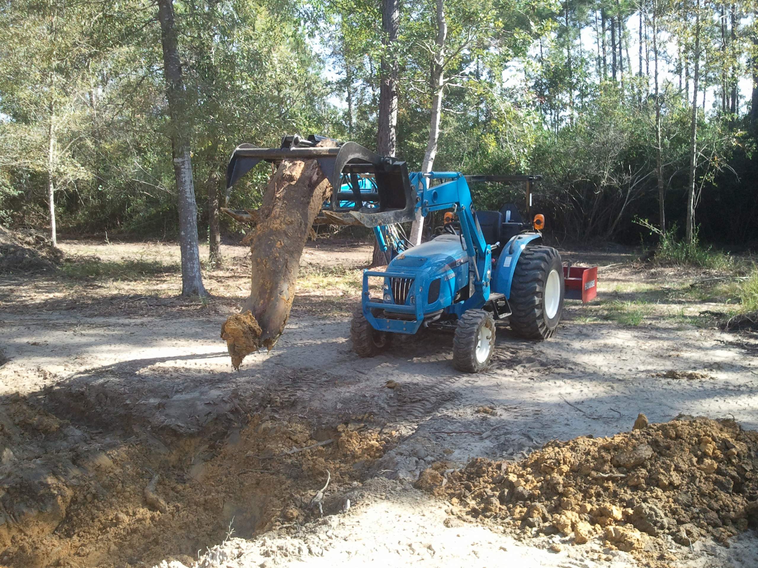

I got a couple more stumps dug out today. This long leaf pine was over six foot long! I tried digging around it in an attempt to push it out, but was just entirely too deep. Took the grapple and managed to wiggle and pull up, until it popped out. I brought the back tires off the ground several times!

That is one heck of a taproot. The ones I dig out usually have some substantial spurs coming off also that keep you from just pulling it out. Lone trees I can usually dig all around and cut the roots with the back hoe, but the last one was between two large ones and I had to saw the spurs off then pull it over with a couple of long chains and a tow strap to get enough distance. It wasnt nearly as big as the one you got out though.

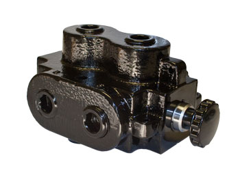

Glad to help. The idea of using a momentary switch to divert the curl/dump circuit to operate a grapple came from the TBN hydraulics forum. Tons of good information there! My next hydraulic project might be installing a manual double-selector valve like this:
It would be up high on the back on the back so I can easily use it while in the seat. I only have one rear remote and need to be able to divert from the 3 pt. top link to a side link for a tilt function. Sure wish I had bought and installed the dual-rear remote kit from LS instead of the single kit.
