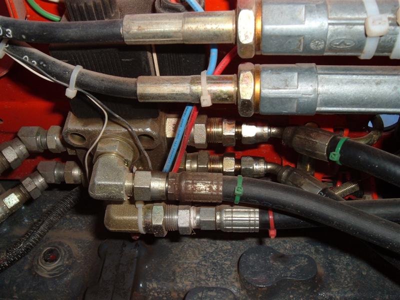

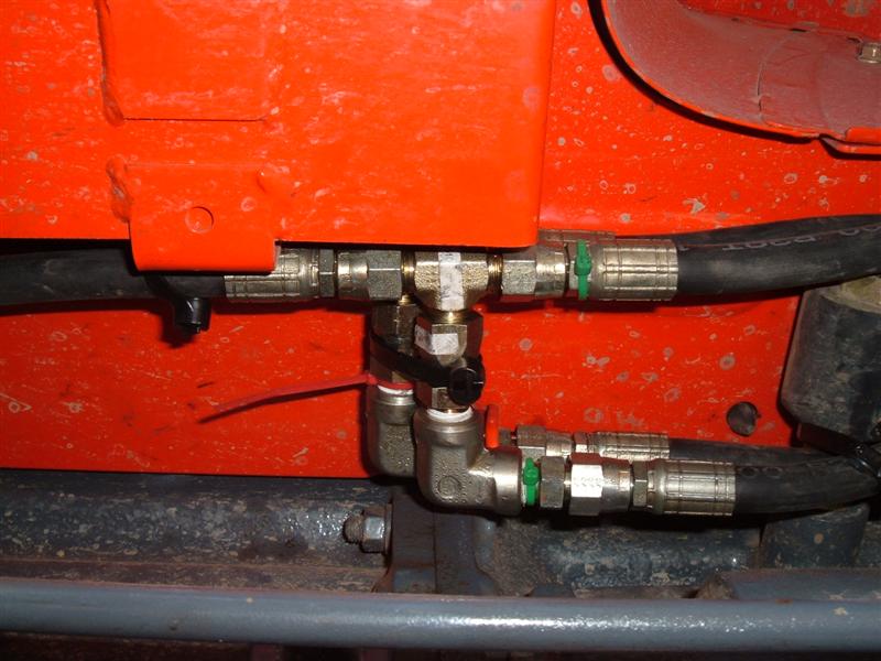

Finally getting around to post some pictures of my diverter I installed on my CK20.
1st pic. Diverter and relay are mounted under left side floor board between FEL valve and rear fender.

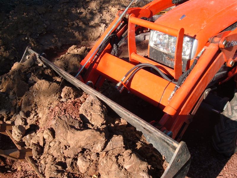

2nd pic. Side view of tractor, tried to keep things as hidden as possible.

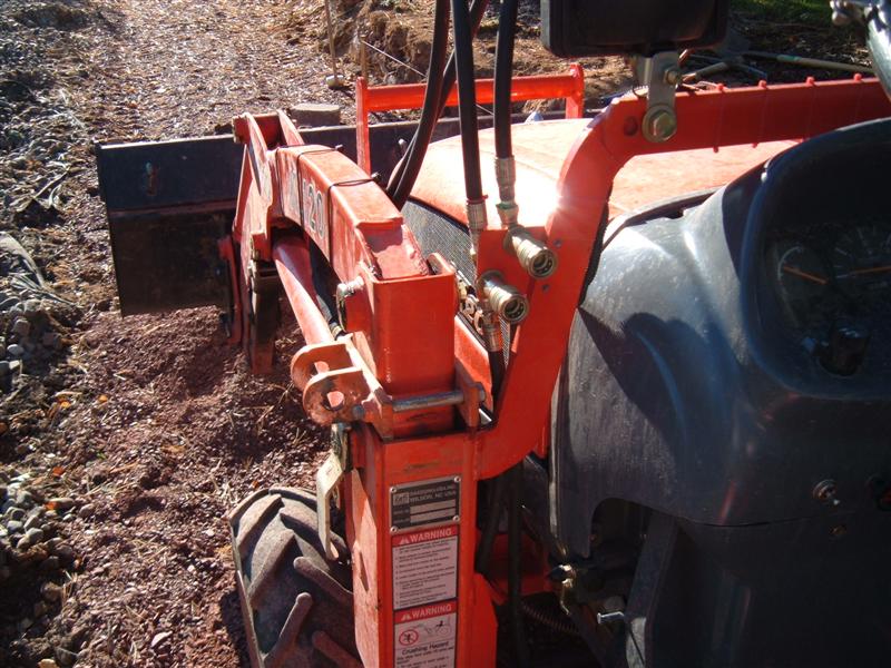

3rd pic. This is the opposite side where the line tee's to the front/side and the back outlets located just behind the tool box.

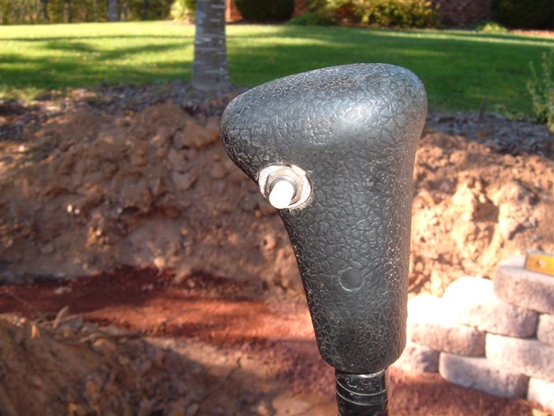

4th pic. This is my joystick switch. I used a relay as this is a very light duty switch because of it's size and probably wouldn't handle the continuous on/off cycles of the solenoid.

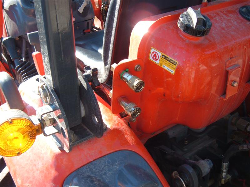

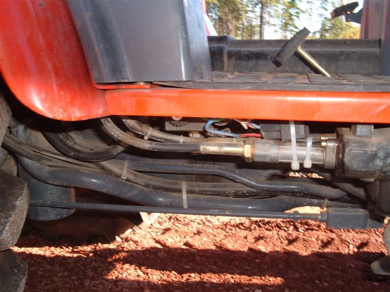

5th & 6th pics. These are two different angles of the back remotes.

That looks great Steve,
What diverter is that...hard to see since you have it hidden so well!
   / Another Diverter
It's been so long, I'm not positive but I think it is Hy-spec. There sold at Princess Auto in Canada. I got it on sale for $190 canadian. I think I spent more on fittings than I did for the valve.

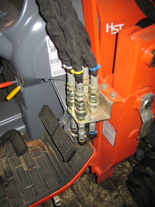

IslandTractor said:
Nice neat work. What fitting did you use on the FEL torque tube to secure the hoses? Any chance of a close up photo?
Why don't you just get a couple of standard bulkhead fittings and mount them in a simple angle bracket? Discount Hydraulic Hose sells the fittings.

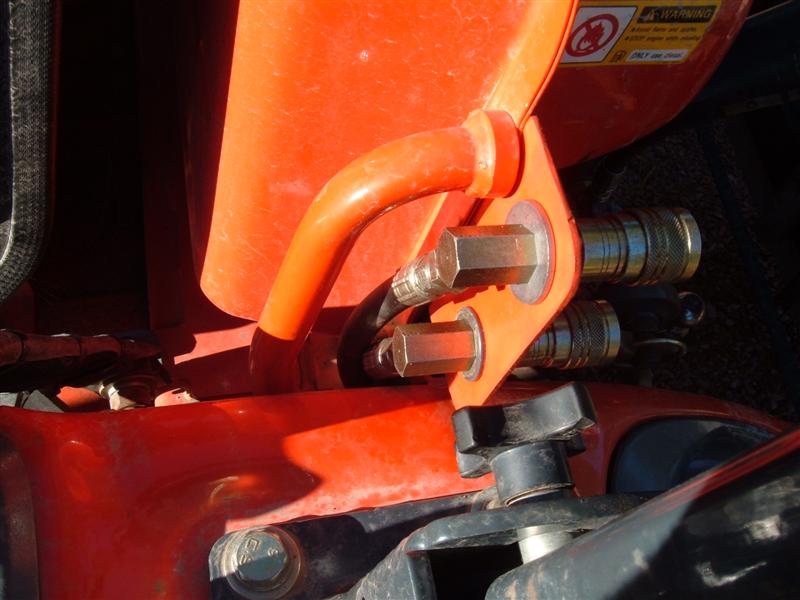

I think we are talking about different things. I can find the NPT fittings, I cannot find the braces or a way to securely mount my existing QC fittings to the FEL torque tube. I need something that functions like the piece of metal in the photograph below which is the stock factory brace for the QC fittings on the FEL post. I need something functionally similar that could be attached by welding or bolting to the torque tube.
Thanks
