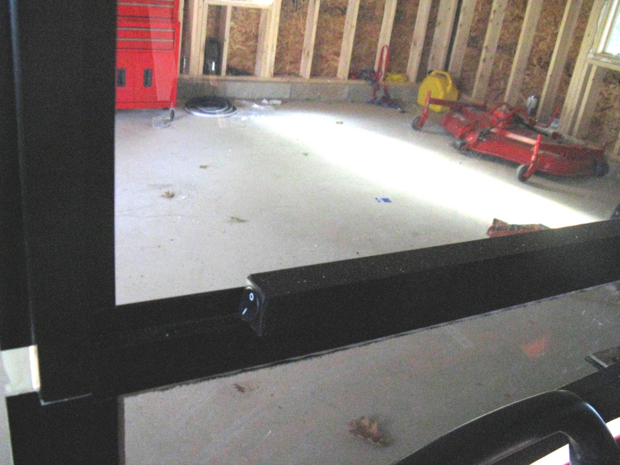

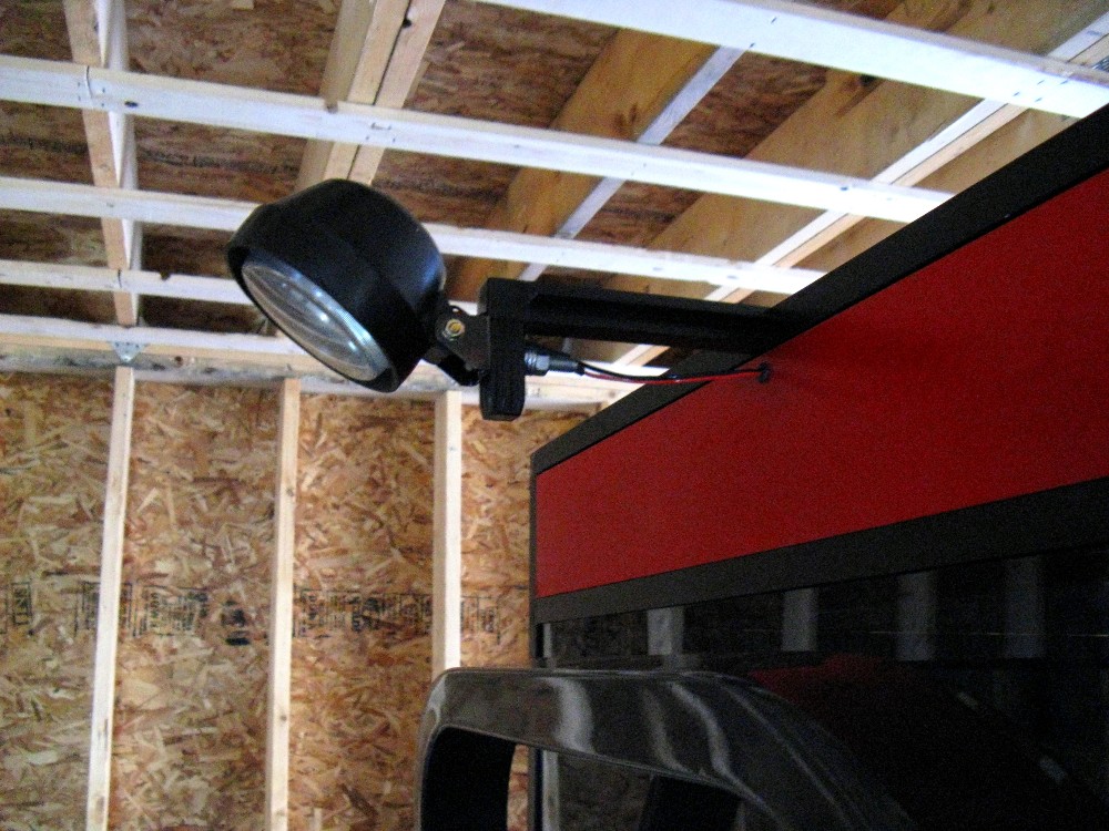

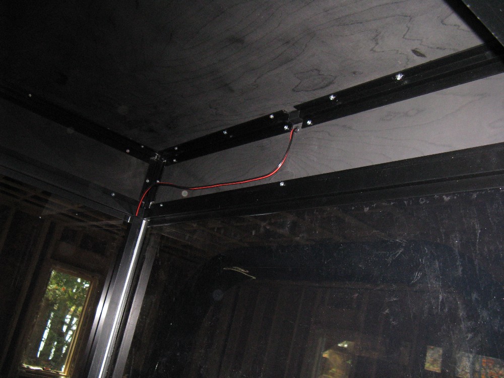

Thought I'd add a couple photos of the rear light mounting and switch. The Aluminum tubing and connectors allows the introduction of lights mounts anywhere you like to put them and they're strong and stable. I extended the light on the back to reach past the ROPS when pointing down. For a clean looking switch install I ran the wiring and mounted the switch inside redundant tubing a fastened parralel to the frame along the right side of the cab. I still need to affix the top wiring out of the way but you get the idea.

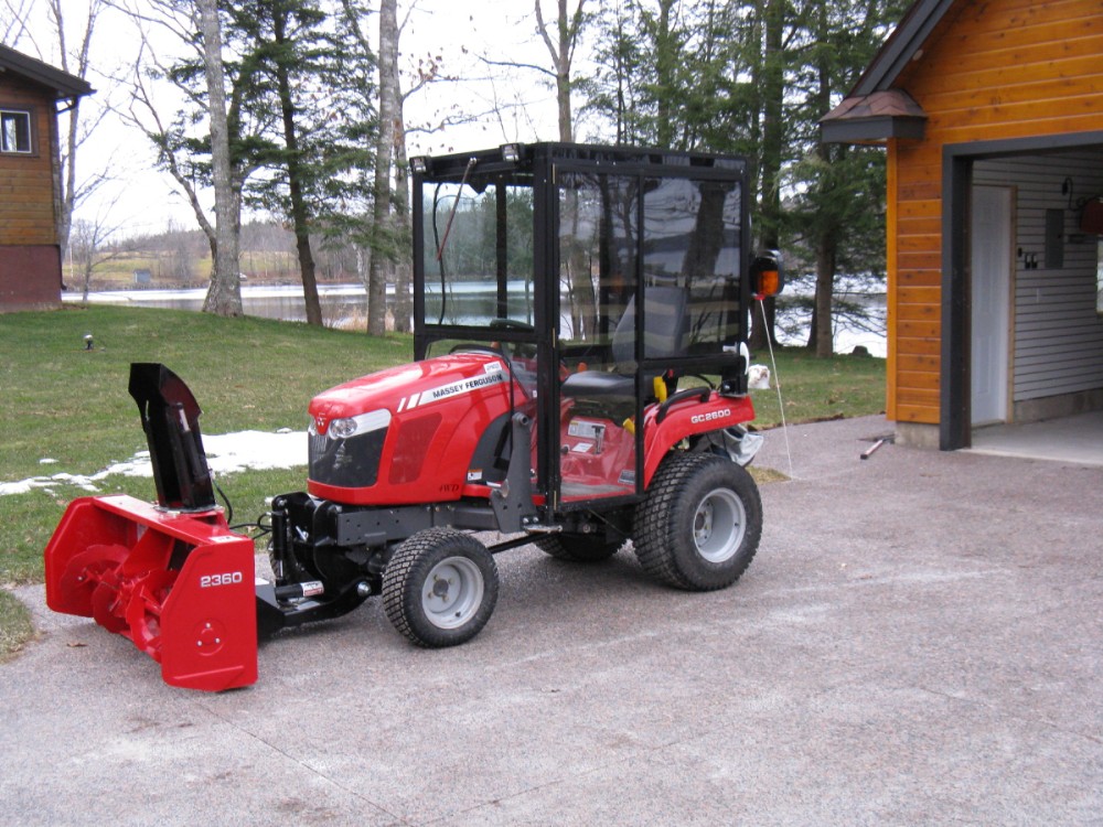

Thought I'd post a quick update on the cab and a new pic. I made a couple changes, lowered the cab several inches, replaced the tinted plexi (too dark and splintery) with safer clear Markrolon Lexan and added a couple lights up top required due to the snowblower chute blocking the right headlamp. The primary purpose was to build a cab sans welder therefore I had to stick with a square boxy looking cab and I feel the latest changes reduce the contemporary mobile phone booth look of the cab somewhat and also make it safer. Now that I have a welder come spring I'll work at angling the front windshiled and possible introducing a couple more less harsh transitions to give it a more uniform look with the tractor itself. I think it looks substatially better now and feel more at ease knowing the potentially artery piercing plexi is gone.

Yep that looks like a real sweet setup. How are the doors built? Does the whole side open up with a hinge on the front left? What kind of hinges and latches did you use? Thanks too for the link to the tubing... that could come in handy.
