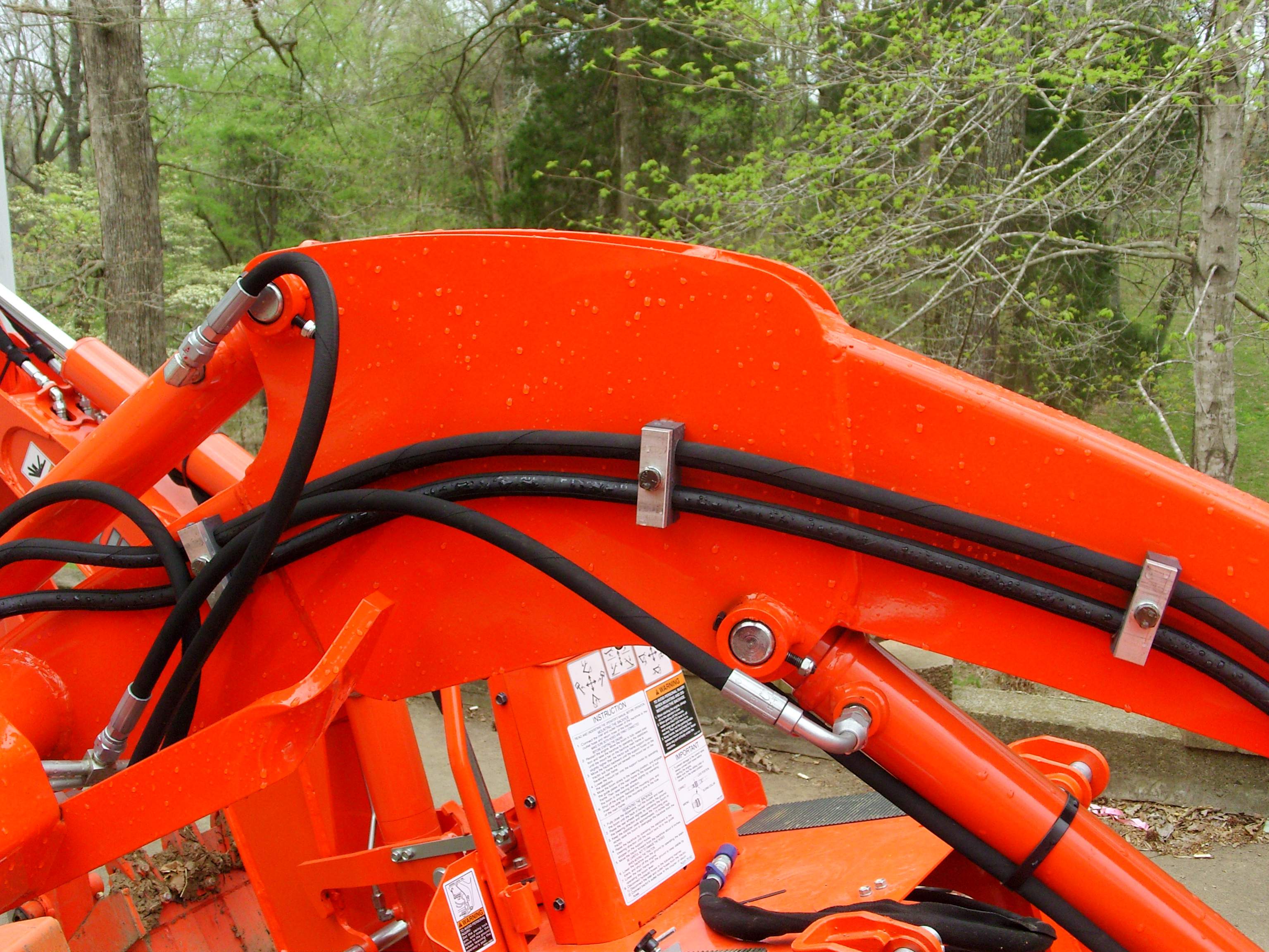

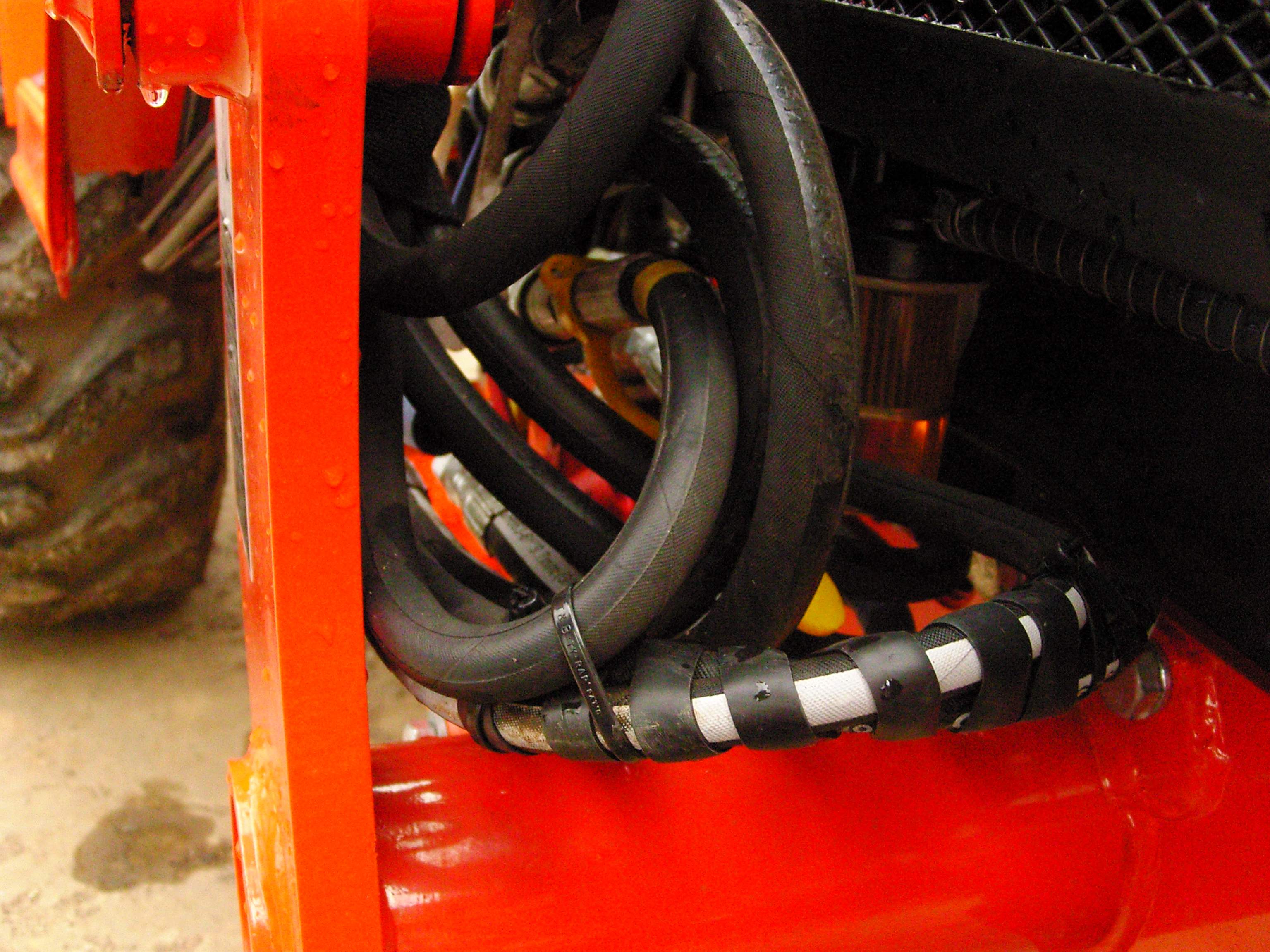

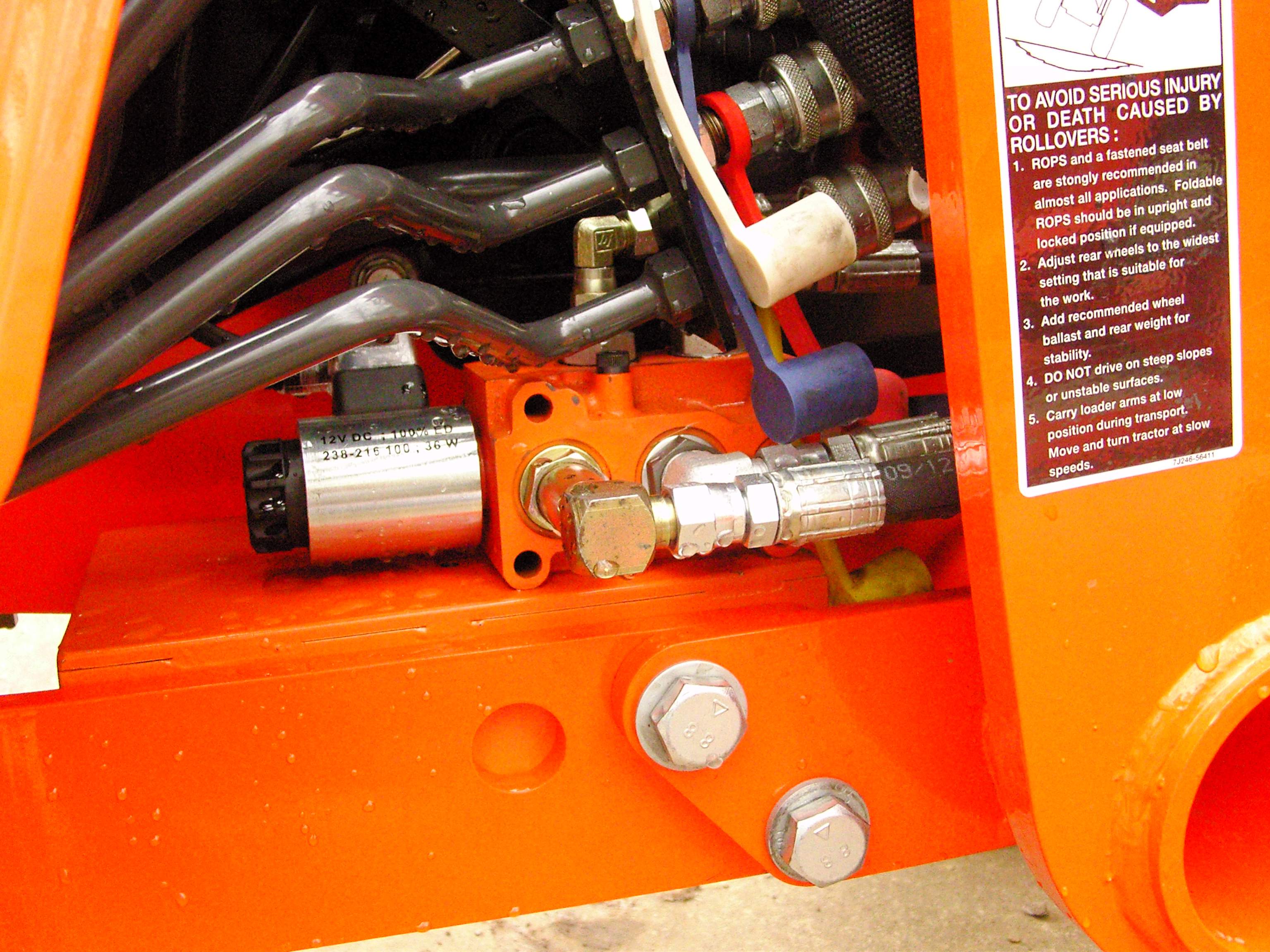

Here are some pictures of where I mounted my diverter valve, it's behind the front tube of the loader mount. I made a right angle bracket and used the bolts that hold the loader mount and back brace together. It's very tight in that space, but it's pretty well protected as well. I hope the pictures make sense - it's very tight and compact in there - so hard to get a picture. I ran the supply lines for dump/curl to the diverter directly from the quick disconnects via some new 18" long hoses. The original dump/curl hoses connect to the diverter and the new hoses for the grapple are secured to the inside of the loader arm. This eliminates the ability to remove the loader assembly but I don't care because I can drop the grapple or bucket from the arms in 2 minutes using the Kubota quick attach feature.
/ Another DIY Grapple #50
Wow that's just the opposite to my way of thinking. I have my loader off anytime I can! I do a lot of mowing and tiller work inside of my wifes horse pastures and the riding arena where I need to get tight into the corners and having the loader lifted to do this is a real pain, especially where the trees hang over the fence. I am also so used to having tractors without a loader that they just look better to me. While your installation looks really good and works for you it wouldn't work for me. It really is unbelieve how just simple little things differ between different peoples needs, I guess that is why we all look at and read many many posts on TBN if we respond or not we are still learning something! What a great site.
I do have a question though. Where did you get the two different size 90 degree fittings so one is longer than the other and the hoses can pass by each other and do they have a special name?

You are right, what works for one person does not necessarily work for everyone. In answer to the fitting question - one is a "short" or normal elbow, the other is a "long" elbow they work nicely to allow two hoses to leave the valve body in parallel, but they do make the overall package a little bigger.
here is a link to the two different types of fittings for your reference:
SAE 37ー Flare (JIC) x O-Ring Boss (ORB) 90ー Elbow
SAE 37ー Flare (JIC) x O-Ring Boss (ORB) 90ー Long Elbow
Also available is an extra long:
SAE 37ー Flare (JIC) x O-Ring Boss (ORB) 90ー Extra Long Elbow
