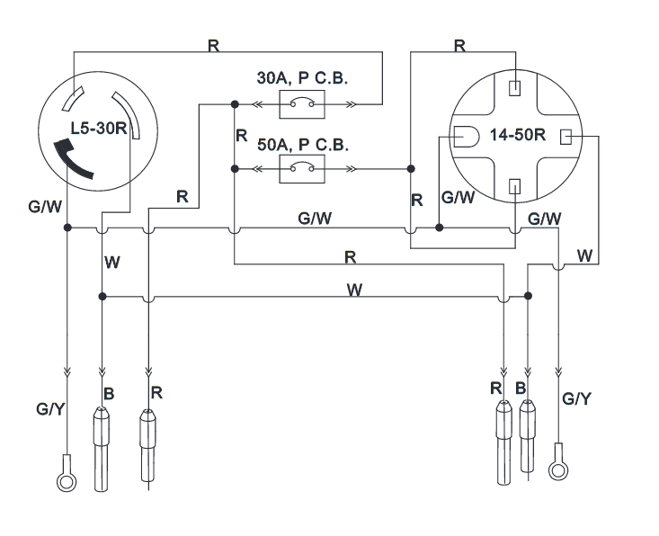

Here is the wiring diagram for the generator link device:
Looks like both hot wires (one from each generator) come in, feed into the 30 and 50 amp breakers, then go out to the hot on the 30 amp receptacle and both hots on the 50 amp receptacle.
The neutrals are connected together and to the neutral terminals on the receptacles and the grounds are similarly connected to the ground pins of the receptacles.
That gives it 120v from either hot to neutral and 0v from hot to hot (vs the 240v that is normal).
As such, anything that uses 240v only will see 0v and wont work (most will have a 3 wire cord). Anything that uses both 120v and 240v (most will have a 4 wire cord) will have the 120v part work, but not the 240v part.
I would love to use an interlock kit rather than a transfer switch. Much cheaper and easier and just as safe. However, my sub-panel (Siemens) does not have a main, only branch circuit breakers. The main for the sub-panel is in the outside panel.
OK, I have another confession to make. I do own a 5500 watt 240 volt generator. It is loud as all get out and the voltage fluctuates pretty wildly when a load is applied (like a compressor starting on a refrigerator, freezer or window ac). I'm very concerned about my electronics using this generator. I CAN use it if I have to. I just don't really want to if I can help it.
The 240v generator has a bonded neutral. (I just checked it) I know the smaller ones have a floating neutral. (Checked them too) If I do buy the 100 amp transfer switch I still do not know how to hook up the neutrals or grounds from either generator. That has been my only question from the beginning of this post. THANKS for your help and advice. I really do appreciate it.
Given that the generator will be running outside, I would install (or given your apparent experience level, perhaps have an electrician install) a transfer switch outside (after the breaker in the outdoor breaker panel), or with an interlock on the main breaker of the outdoor panel with a NEMA 14-50 inlet such as: Conntek GISB5-25 NEMA 14-5 Power Inlet Box & Power Cord Combo
then plug your generators into that, or a larger generator down the road.
