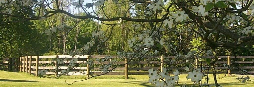

Harv ... I know you love wood too ... our local outfit been installin horse fencing for 60 years.
In July of 2001, we had 2-1/2 acres of 4 board and batten fencing put in.
The owner (Ketchum Fencing PLUG) installed three 12-foot alum gates, 178 pressure treated pine posts and 4 board oak with oak battens in ONE WEEKEND. See attached.
He had a nifty old 4WD 2 ton Dodge with a rear mounted auger. He punched all the holes and set all the posts on a Saturday and his 3 boy crew came with 3 stilhs, a pnuematice nailer and did all the boards and battens on Sunday. Gates were in by 11am Mon. Morning.
This included settin the gate posts in concrete and about a dozen posts where he had to bore through sub surface shale shelves. For the latter, he auguerd a 3" hole into the shale apprx. 3 feet down and had 4 foot steel pins set into the post, then the pin and post cemented into the shale.
Impressed the begoogles outta all who witnessed. Smart, fast, to the point and reasonably priced. Don't see that too much these days.
