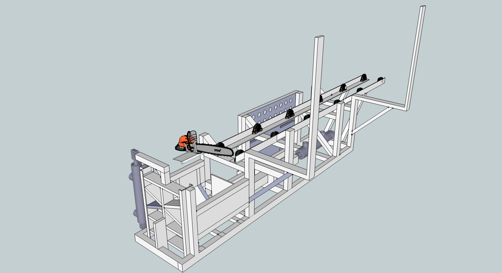

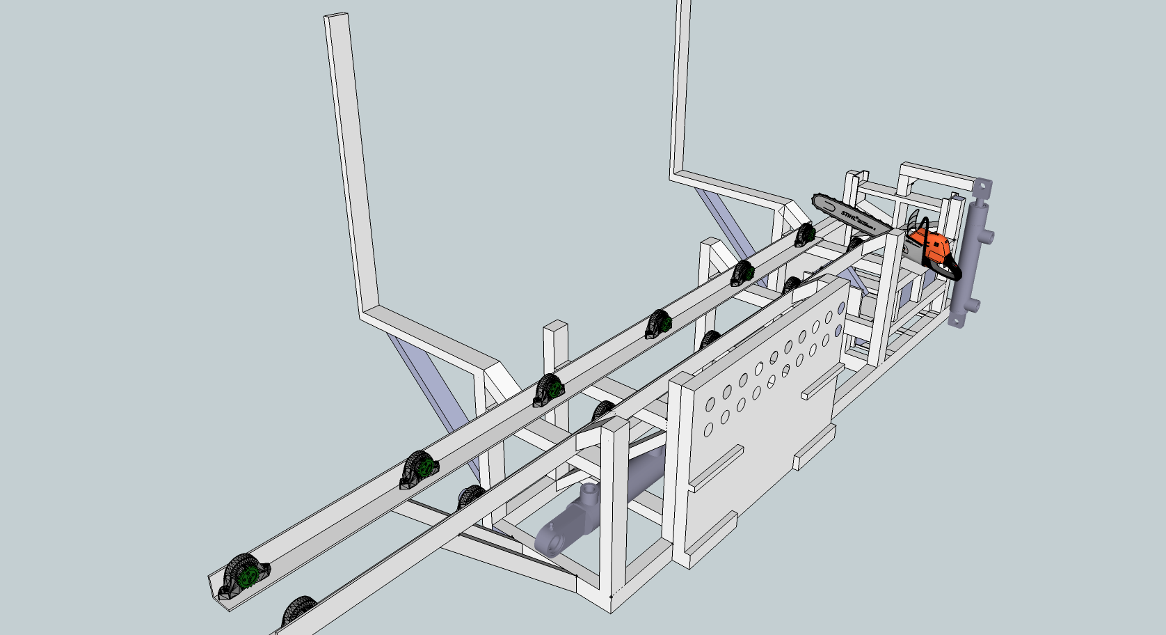

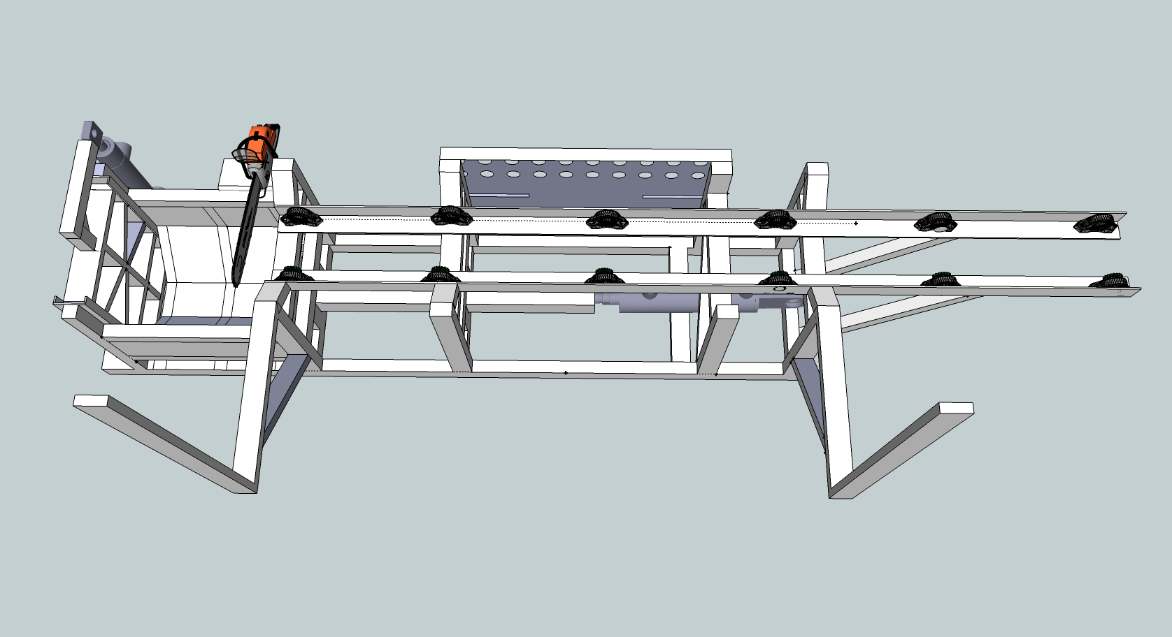

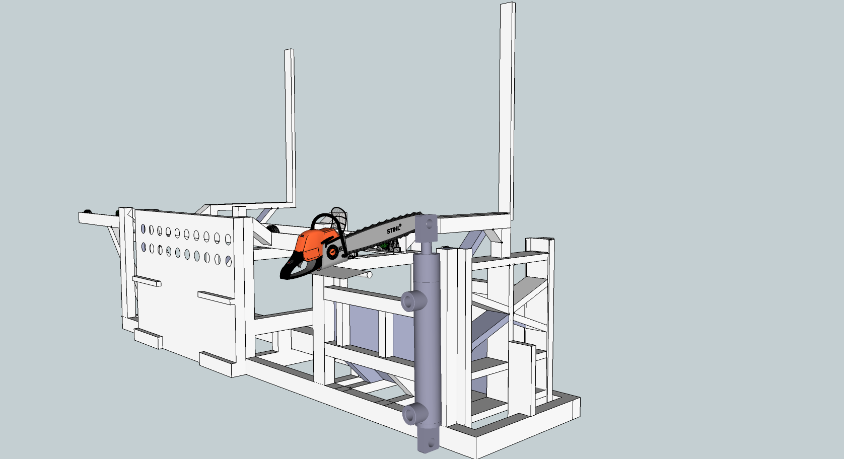

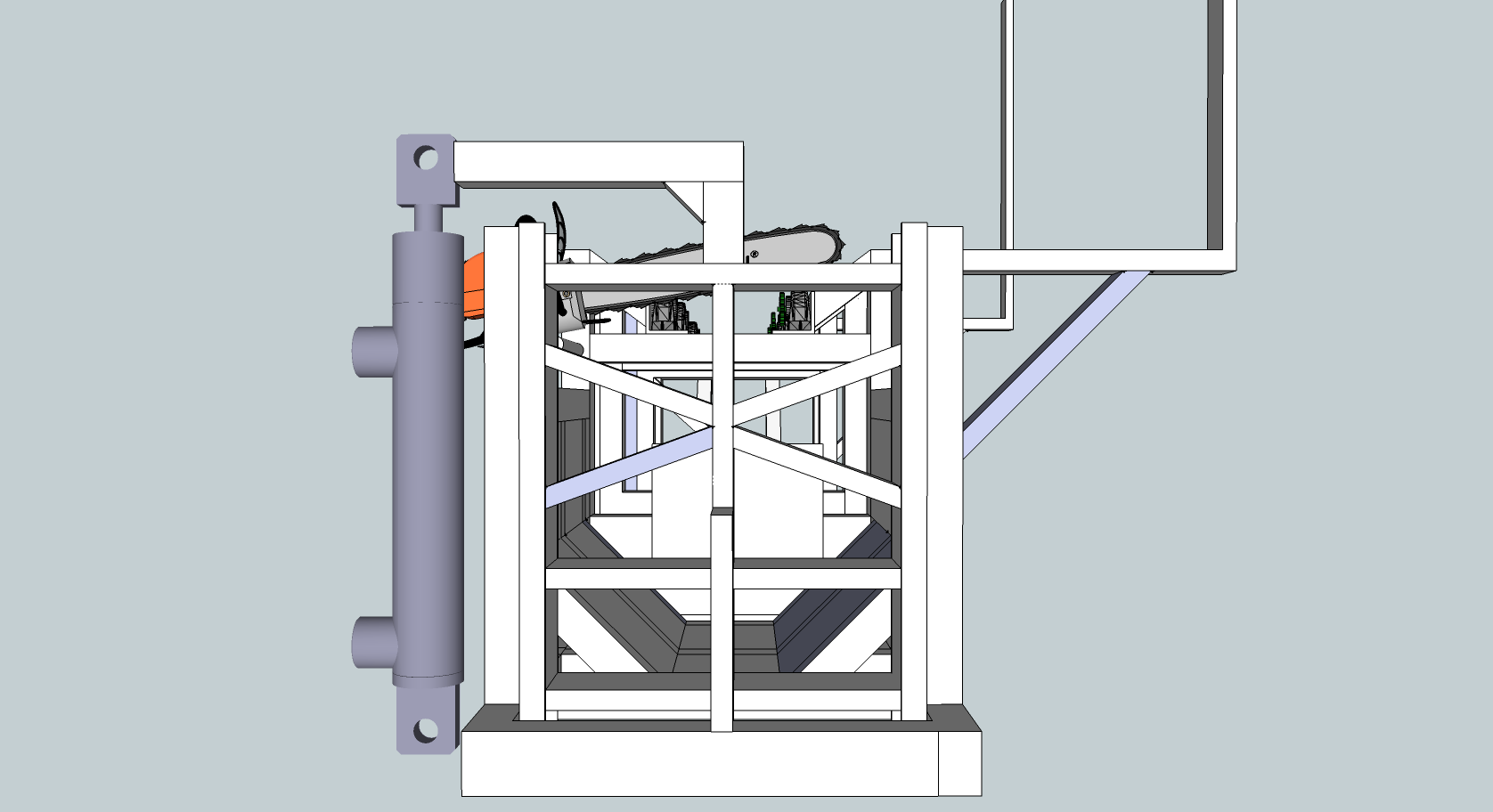

I know there have been a few threads already, but I have a few hydraulic questions. This will be my first hydraulic project and I really have no idea what I'm doing so I'm looking for guidance and validation that my creation wont simply self destruct.
I'm planning a processor that will use my Stihl 361 to cut, so that part isn't an issue. I am planning to build a splitter, a feeder and an conveyor. My plan is to use old tires for the feeder, cut the side walls off and join them together. That part of the feeder will be powered by one hydraulic motor and I'm planning on using a second identical motor for a top clamping roller. I plan on constructing the conveyor from scrap ski-doo tracks and if I can't find those, tires again joined together with angle iron.
I am planning to use 2 15hp engines for power. The first engine will be dedicated to the splitter and the second will run the conveyor and feeder motors.
Splitter: I'm planning to use the 2 stage, 28/7 GPM log splitter pump from the Surplus Center. The requirement is 16hp, but 15 will have to do. 28 GPM DYNAMIC 2-STAGE PUMP
The rest: I was planning on using a multi section pump with one pump powering the conveyor and the second powering the feed motors and ax height cylinder. Here is the one I was looking at: 1.29/0.69 cu in CASAPPA PLP20.20/20.11 DOUBLE PUMP

This is all great info, thanks guys. I'm watching a ton of vids on YouTube and my design is changing (once again). I REALLY like this one and now think I'll base my design on it. https://www.youtube.com/watch?v=pmSS0SEoxXs
This design eliminates the conveyor all together and allows me to fill up my firewood bags easily. I also have a set of pallet forks (I bought them brand new) that my BIL kindly used on a skid steer rated over 5000 lbs and pulled the forks right off the frame. The frame will be a nice SSQA base and the forks are obviously perfect as loading forks.
So I have 3 options I'm thinking of.
1) Making one almost identical to what's in the video and using a PTO pump. I'm concerned the hydraulic over electric components will be cost prohibitive. I'm also thinking the hydraulic chainsaw will be a lot of work to build and get right.
2) Stick to using my saw and using the 15 hp engine to power the 2 stage pump for the splitter and my remotes for the rest.
3) Run the splitter and other hydraulics off my remotes and use my chain saw. This probably only offers around 8-10 GPM @ 2250 PSI.
I have several cylinders to use for this project so I'm thinking of eliminating the feeder system and simply making it a tilt system. After loading a log and clamping it (I would have a double clamping system) the deck would tilt, the log would roll on rollers until it hit a stop, the log would be clamped again and the saw would cut it off, repeat.
