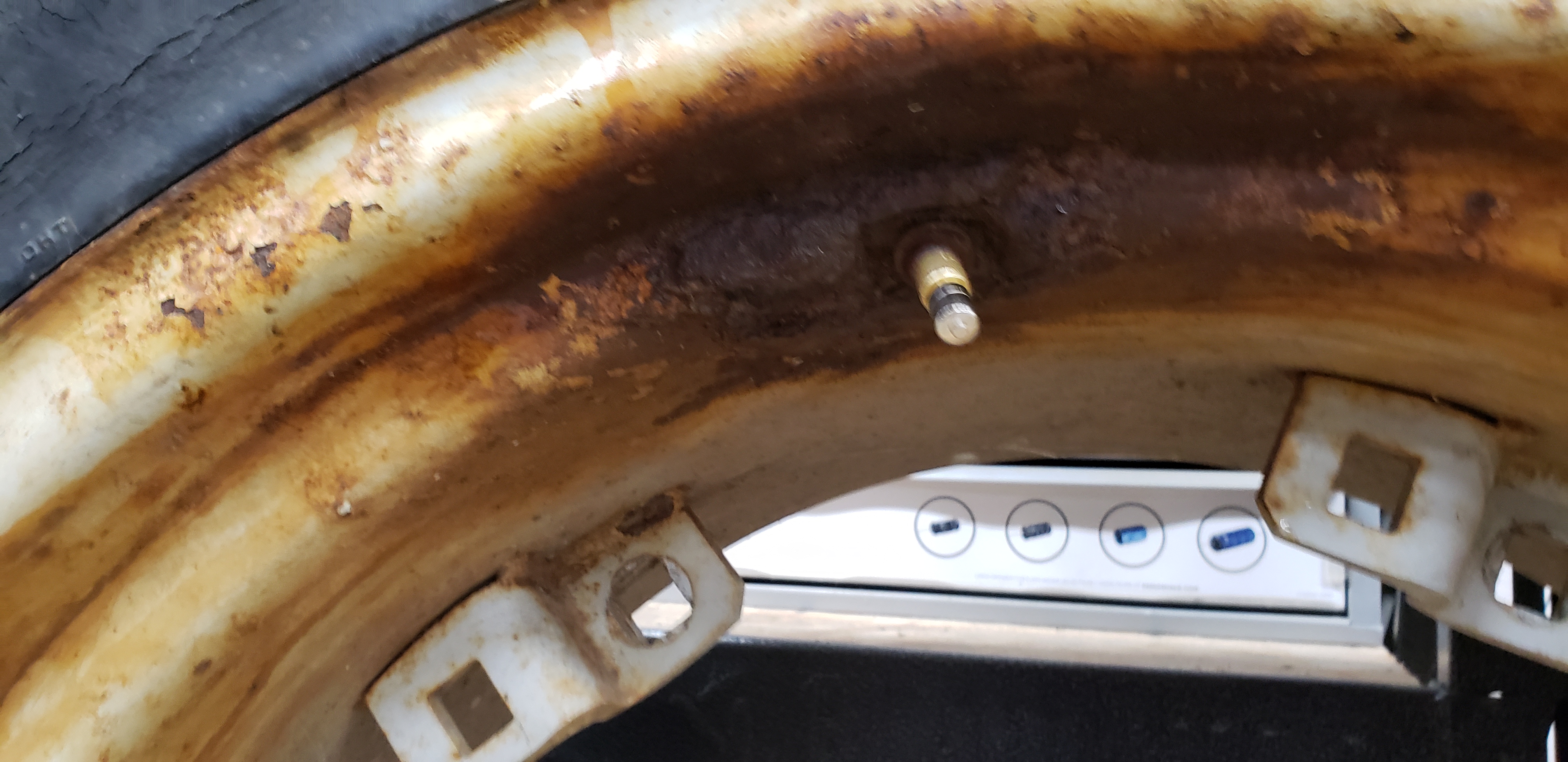

You will not find 13" direct replacement available, I had a few shops quote having them custom made but they were around $600 a rim. Way more than I can justify for a 30 year old tractor. The rims that I purchased were not an exact fit and will require a little modification of your center plate. I had to open up the holes in it .090 outwards to get the bolts to tighten down flat and not be cocked. Not a big deal but something to be aware of. I am almost positive the wheels I bought are the same ones miller tire sells.
The only reason I put new tires on mine was because of neglect on a previous owners part taking large chunks out of the bars on my original ones.
Here is what my rims look like after 30 years of calcium.

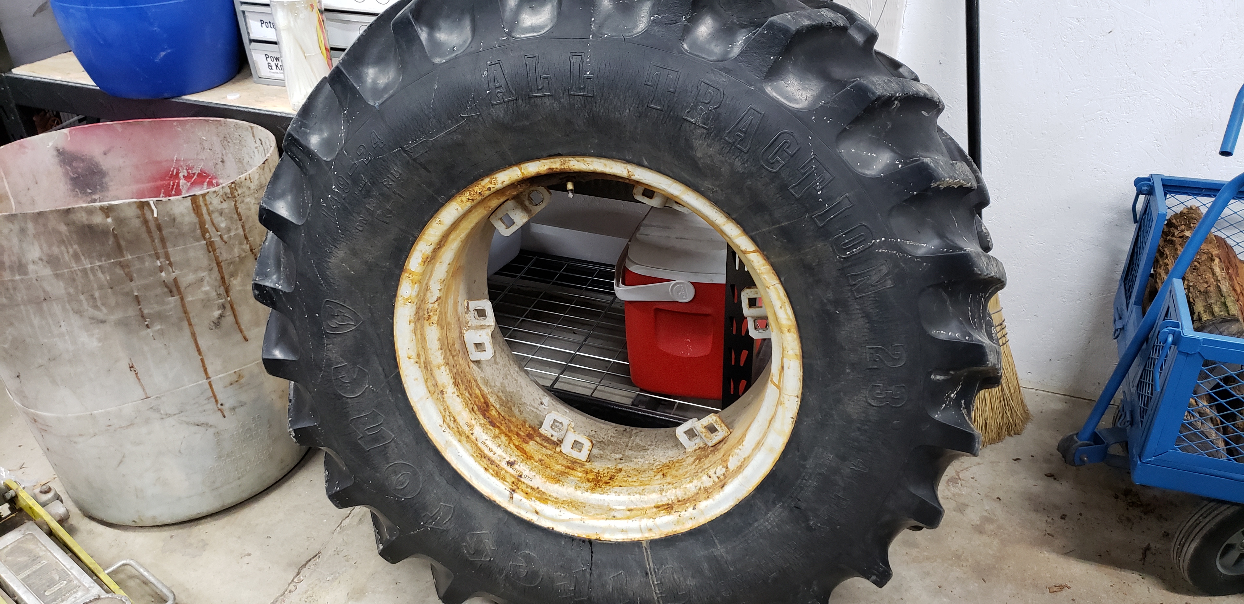

I realize I'm probably asking for the impossible, but can anyone assess tire condition from this pic? I also wonder if a 30+ year old tire will get damaged when being removed.

I'm guessing that your tractor has been stored under cover? I don't see any noticeable cracking and the tread looks great on the one in the picture. Those look almost new compared to what I took off mine. Usually what you see with old tires is that the sidewalls start to crack and the treads become soft and tear easily (kind of like punky wood). Even then, many people would continue to run them for years as long as they hold air and have enough tread on them.
